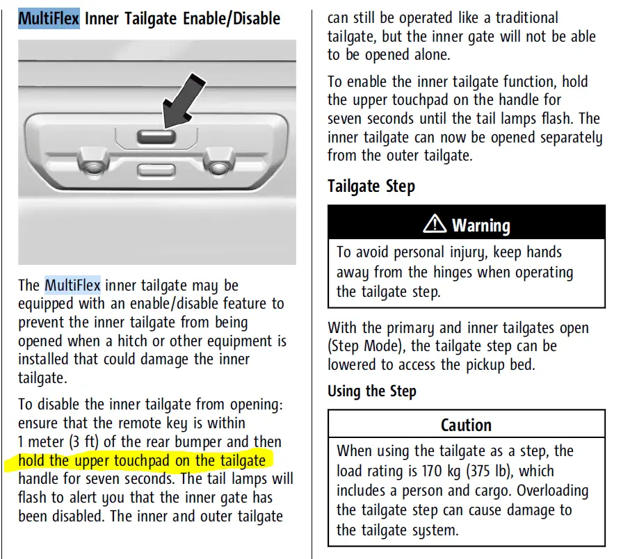

THANK YOU... I was just trying to figure out why my top section just stopped working!!!Another feature not mentioned to much is if you hold both buttons same time till taillights flash. It will deactivate top section so you can’t accidentally drop it out into trailer ball/hitch . Reverse pressing both buttons till tail lights flash to reactivate top again![]()
This worked perfectly... just tested it. THANK YOU.Actually it is just the top button, it may work if you hold both buttons, but the top one is the one that does the work, per the manual, and per my experience using this feature often.
I held just the top button for 7 seconds (with the key fob in my pocket) and it toggles between lockout and regular function of the top section of the multiflex tailgate.THANK YOU... I was just trying to figure out why my top section just stopped working!!!
