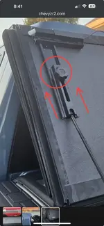

Can you loosen the securing knob and slide the rod holder adjustment upwards on the track to reduce the amount the hard cover tilts back into the cab?

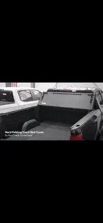

Even on your part number at chevy accessories it shows 1500 fit looking like my fit. Id be kinda pissed too. It shouldn't block any cameras. Picture from chevy accessory matching your part number.
