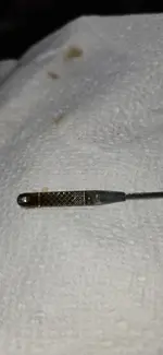

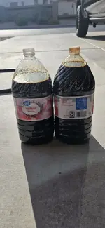

I just did a 4000 mile round trip running mostly interstates and highways at higher speeds for 3200 miles and country roads and trails for about 800 miles.
I changed oil just before I left. I added 1/2 quart at about 2200 miles as it was a little low on dipstick hatching. I just did an oil change today at 4000 miles after getting home and it was also reading a little low on dipstick hatching.
I can confirm now that I'm using 1 quart of oil at about 3000-4000 miles. So call it, 8 oz per 1000 miles. I drained all the oil into a clean pan and then poured it into two clear 1 gallon jugs (see picture). I came up about 1/2 quart short, after adding a 1/2 quart.
FWIW, it seems like the dipstick hatching represents about 1 quart of oil. Also, the pan seems very sensitive to level ground as it seems to give me a little different reading rev time. I rotate the dipstick handle to get it covered evenly. I check it for level across the radiator shroud and try to be level front to back. This picture of dipstick is about 1/2 quart low.
I'm not too worried about it, but if your gonna do long oil change intervals, I would check it every 500 miles after 3000. I'll probably just do 3000 mile intervals an call it good.
