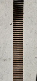

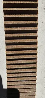

I just cut this filter open and the media looked good and fairly clean at 8500 miles. That's the 3rd change. I could see a couple of shiny flakes, but nothing like the first change at 1500 miles.
