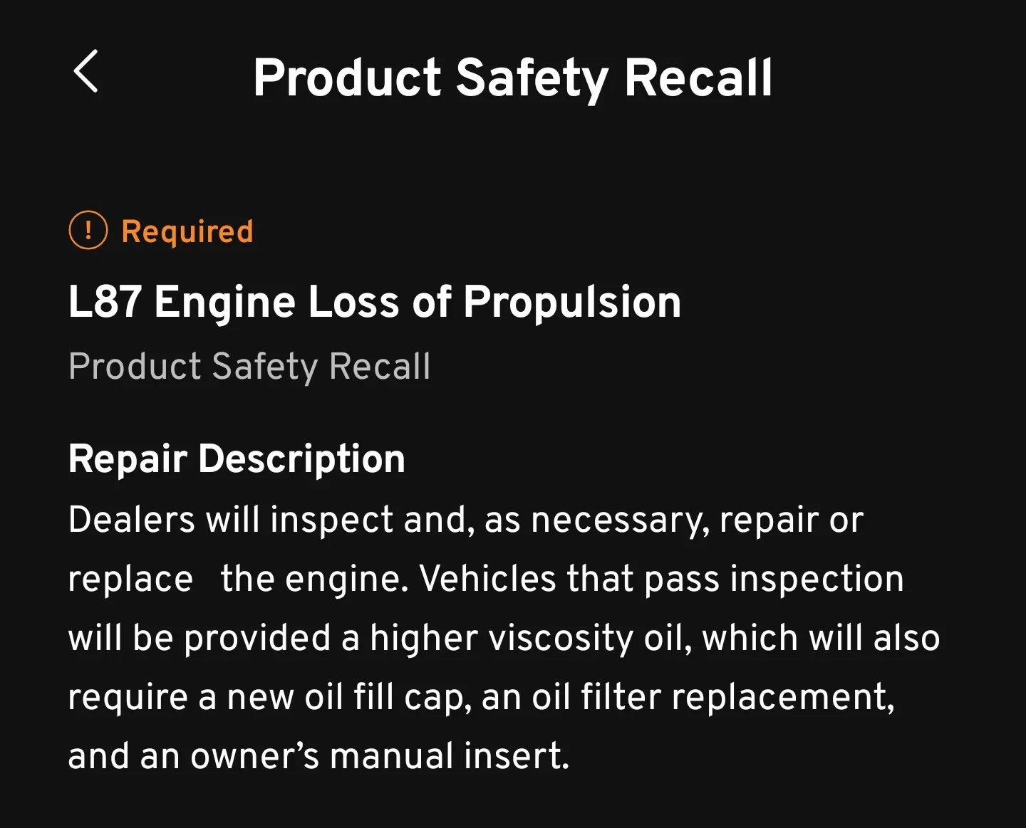

This is what the GM app says under warranty/ recall:
@AXE why would a higher viscosity oil be the answer when they went low viscosity due to the tighter tolerances. Wouldn’t this make the situation worse?
They didn’t go lighter for tolerances. For my understanding , people have posted the tolerances haven’t actually changed in years. They went lighter to save a tenth of a MPG.
Dealer service manger told me increased pressure woukd force oil deeper into gaps wear wear is occurring. He discussed the increased pressure independent of the oil pump, but not sure I followed it.
They are trying to fill the gaps caused by excessive wear that's already occurred due to bearing delamination. We have bad parts, there is no fix, it either goes or it doesn't.
