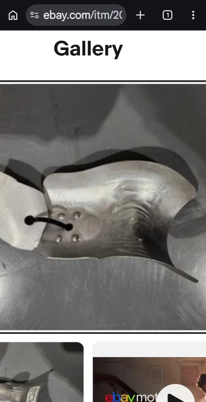

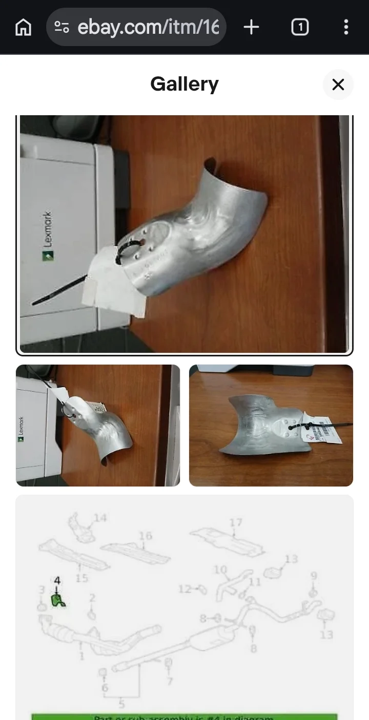

It's the heat shield at the bottom of the header...mine did the same exact thing.... Either they don't know what loctite is or they don't know how to tighten a bolt
It’s literally welded to chassis thin metal studs not threaded and they spin on those cutting nuts that are supposed to create their own thread at install. They’re chickenshit mild steel thin gauge press-formed nuts (garbage) unable to withstand heat, vibration, or hod forbid a bit of dirt off-road
Here is the piece I was speaking of....
When they replaced my CATs under warranty the tech didn't even put the fastener back on....it just laid there on top rattling around
Yeah but they saved $0.15 x 5,000,000 million trucks for $750,000 to the bottom line.......those crooks know math, but not mechanics.
