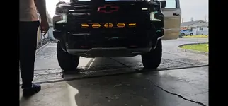

All installed. I have video of Startup but it is to big of a file to upload I will have to see if I can shrink it. I will also post some night pics tonight.

Looks good. How much did you have to remove to install these?
