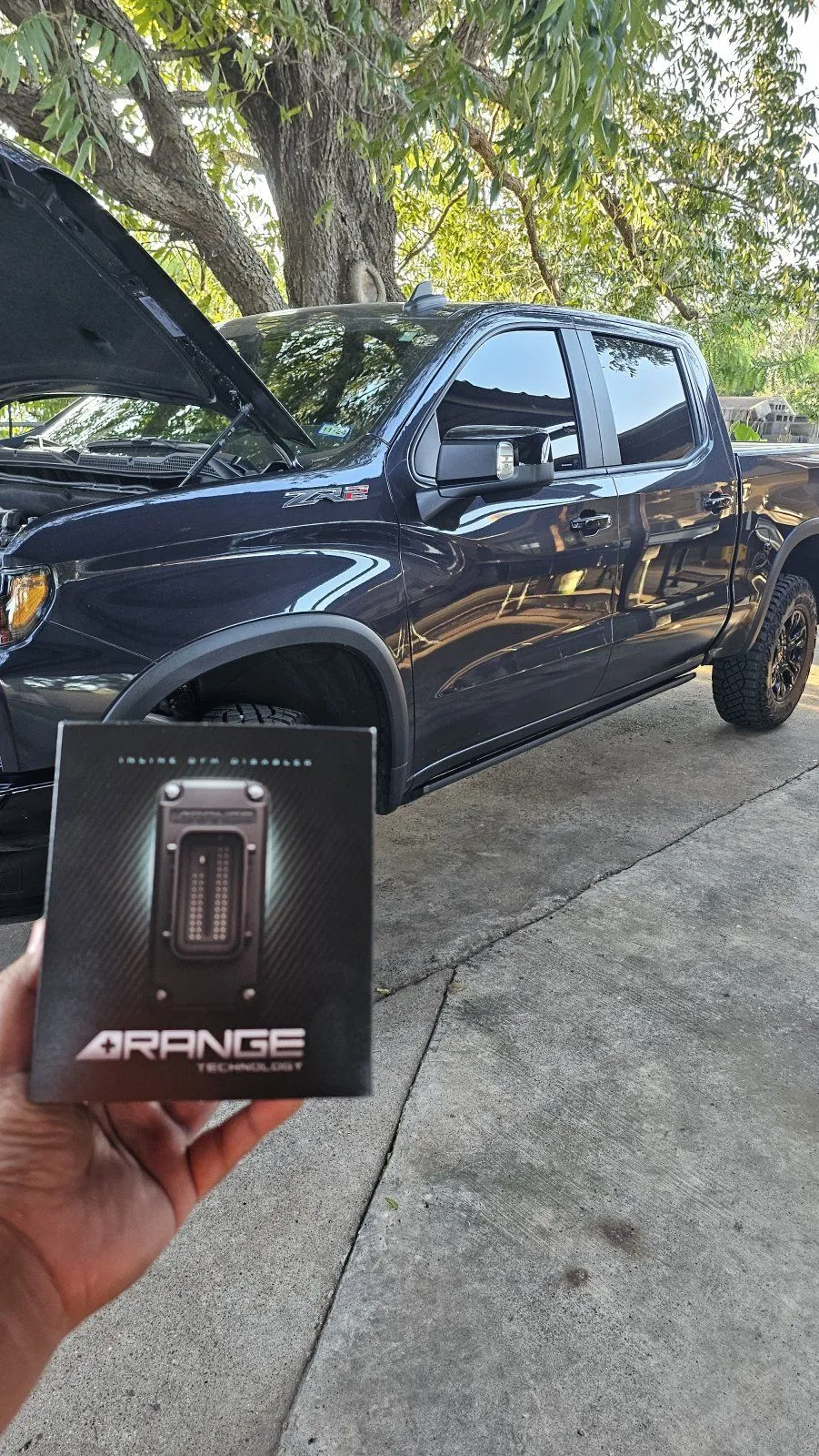

What did you disconnect and reconnect? The DFM module or AMP steps OBD plug or computer?Got mine 2 days ago, 1st install was a fail. I have AMP steps and they did not activate after plug-in the Range. I reached out to Range and said they have tested with Amp steps. Went back to disconnecting and reconnecting. Now both work well.
I also feel the Engine wayyyyy smoother and less clunckyer. So far working strong. View attachment 16170
Disconnect the fuse for AMP steps and negative battery terminal. Then reconnect battery and fuse. It's been working great so far.What did you disconnect and reconnect? The DFM module or AMP steps OBD plug or computer?
Aren't you supposed to disconnect the negative battery terminal anyway prior to install? That should disconnect the Amp computer.Disconnect the fuse for AMP steps and negative battery terminal. Then reconnect battery and fuse. It's been working great so far.
