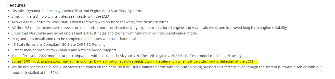

FWIW the wife’s vette does the same thing when you use the paddle shifters to downshift.I think it’s DFM related. If I drive in L9 it does not make the sound.
So much for a 100% solid solution
Well that’s interesting
Seems like they knew this was an anomaly, so they listed it as such. They clearly have limitations in what they can do with programming, so they brought forth what they could. I think this Global B electronic system is difficult to hack. That's why it's taking so long for tuning products to be available.
JFC..........it's this guy's first post and he's already the smartest guy in this thread. Probably uses Mobil 1 too like the other smart guys.Sounds like some things are getting lost in translation. What you're hearing when coasting to a stop is not the lifters de-activating from DFM. It's DFCO or Deceleration Fuel Cutoff where the engine isn't technically running under ignition and fires back off before stopping. You won't hear this running in L9 because engine braking is active in that mode.
Also worth noting when DFM is active oil pressure isn't cut to the lifter. On the contrary the solenoid allows pressurized oil to enter the bore at the point where it can act on the locking pin and de-act the lifter.

Sounds like you were running in L mode!ChrisTX, ignore some of these dipchits, you sound like you're more onto this than anyone so far. anyone that thinks you need to spend time on a forum to know anything obviously doesn't know anything. so why does the oil pump control cut pressure in the deactivation then? another energy saving measure? do you agree stopping the deactivation should reduce lifter failure?
So I drove 280 miles today on a rural eastern OR highway with little traffic, lots of corners and lots of hills. there is a definite better throttle response, less downshifting , better compression holdback on hill descent, sounds better and I notice no symptoms of valve deactivation at any time. maybe there is, if so it's nothing worth mentioning.
None of this surprises me, what does surprise me is my fuel economy is 2/10 MPG better than it's ever been on the same trip. I'll have to see this play out over time before I'm going to say it helps the MPG, but I'm comfortable saying it's not going to make it noticeably lower.
Thank you for this. If tech support at range knew this i wouldn't have been so confused.Sounds like some things are getting lost in translation. What you're hearing when coasting to a stop is not the lifters de-activating from DFM. It's DFCO or Deceleration Fuel Cutoff where the engine isn't technically running under ignition and fires back off before stopping. You won't hear this running in L9 because engine braking is active in that mode.
DipchitsChrisTX, ignore some of these dipchits, you sound like you're more onto this than anyone so far. anyone that thinks you need to spend time on a forum to know anything obviously doesn't know anything. so why does the oil pump control cut pressure in the deactivation then? another energy saving measure? do you agree stopping the deactivation should reduce lifter failure?
