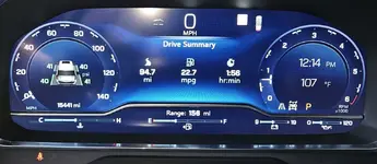

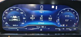

So here are some stats after 1 week of mostly my wife driving the Tahoe with the module installed. First two days were running errands around neighborhood. Second three days were commute to work on city streets. Final two days were road trip on highway and freeway with a lot of steep grades and elevation changes.
So pretty decent results, but do keep in mind the Tahoe has a much better aero package but weighs another 600+ lbs. I have done road trips before and got good mileage with the Tahoe loaded down.
I would say so far, there are performance and driveability enhancements, and possibly some mileage improvements.
