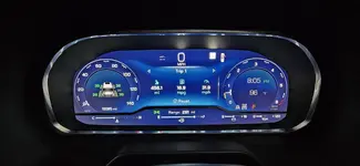

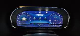

So here's some more data about 13 days post module install. I actually think this rig is getting better mileage by 1-1.5 mpg on the last 450+ miles. It's showing damn near 17 mpg and that's a very good mix of commuting in city traffic and freeway, rural interstate/highway, and a few short trips around the hood. The long term average I have tracking on Trip 2 shows 15.5 mpg.
My wife commented when I was taking this picture that the range showed over 400 miles when she fuled up the other day, said she's never seen that.
This rig ain't cutting fuel either, I can hear it running all the time.
We'll see how it goes, but it's certainly been an excellent experience so far.
