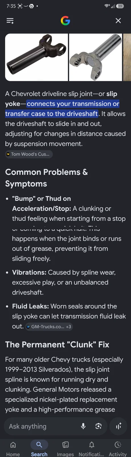

Hers what AI scraped from the humans who've been there and done that.
