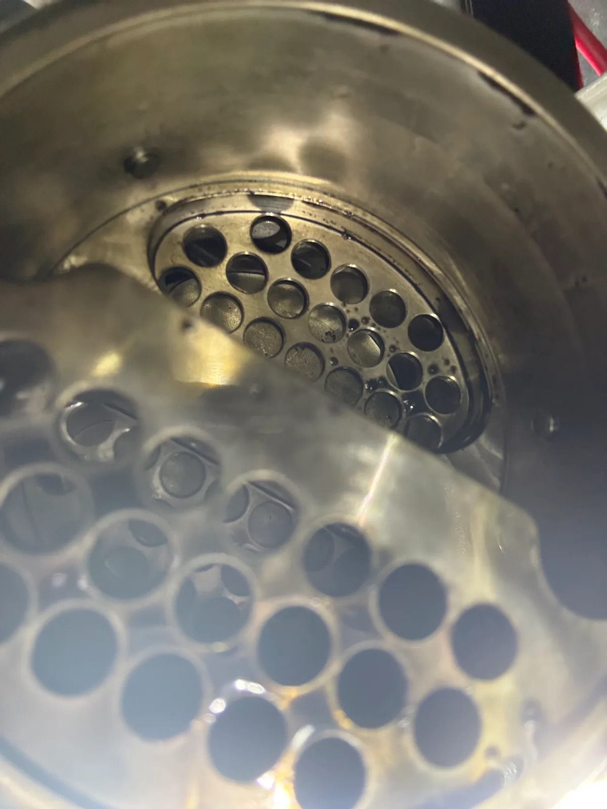

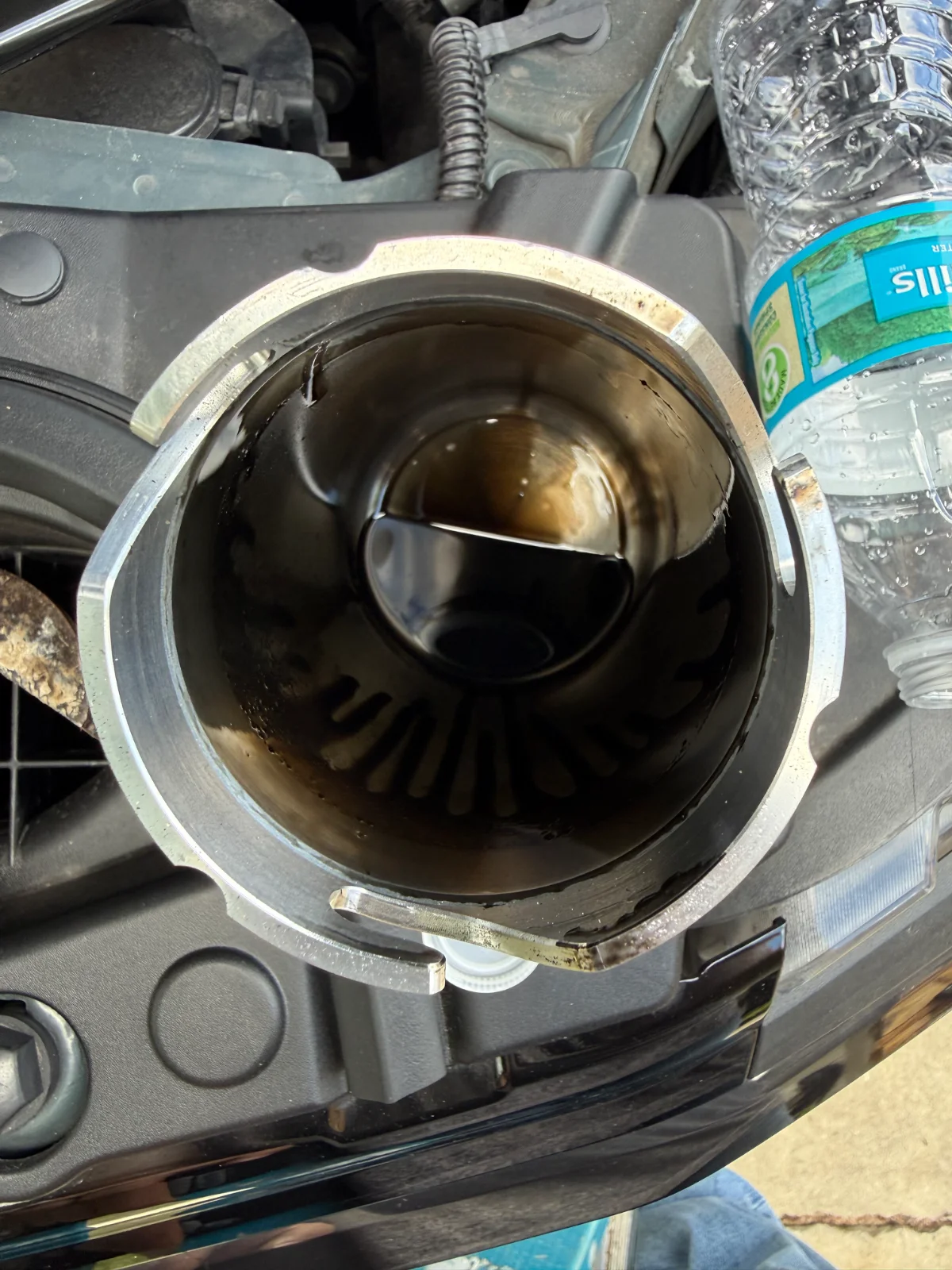

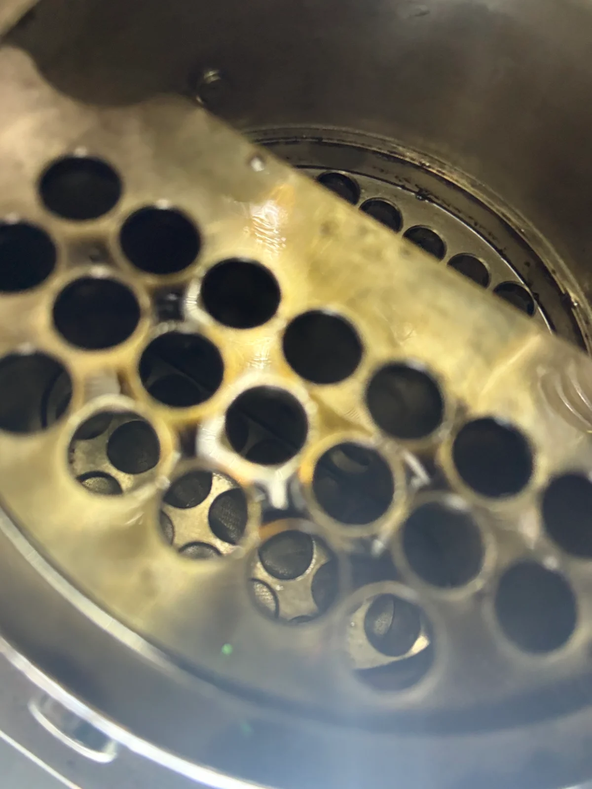

Recently installed VSE's new style oil catch can. Currently have just over 2,500 miles since install. Decided to take a look to see how much was in the canister. Found a little oil in the bottom maybe 1oz. Tried taking the best picture as possible on the turbo side. I could see the secondary holes looked pretty clean. So far so good. I'll do a 5,000 mile update. Pros: well built aluminum, solid hoses and fittings. Cons: Tight location tough to get canister off, mounting brackets will probably have to be removed to replace engine battery. IMG_5287.webpIMG_5288.webpIMG_5283.webp
