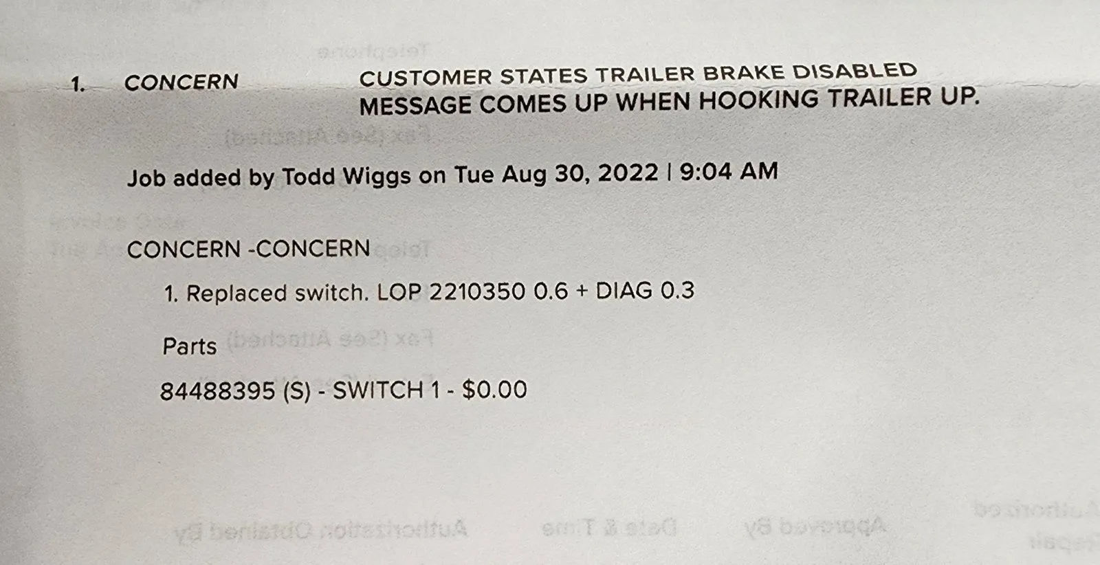

So there is a few threads on here about this. I have no idea why they can't figure out an official fix it seems. I will say I had this problem when I purchased my ZR2. Took it to the dealer and they fixed it in about an hour. I've pulled a couple different trailers about a dozen times and the trailer brakes work great. But others haven't had the same luck. Below is what they did to fix mine. As you can see it was back in August.

You are correct, counts which code. Yes the controller is replaced. However code C159C is a software issue. So far no fix. A truck that can't tow is useless to me. As far as I am concerned I have a lemon.

I don't disagree, I was extremely unhappy when mine didn't work. I own 5 different trailers. One has surge brakes but the other four have electric brakes. I've got airbags on mine because i pull trailers. I told my dealer exactly what you said. If I can't pull a trailer it's useless to me. Luckily they were able to get it sorted and it has worked ever since. Hopefully your dealer or GM can get you sorted.

I am not sure if this issue involves all trucks. However, I received a call about a month ago from my dealer. They replaced the brake controller on the dashboard. Towed my camper this weekend. Zero issues. Extremely pleased with towing.

its a new module. i got a notice not to long ago.

I was at my dealer two weeks ago for first oil change. They advised me of a recall on the trailer braking system but didn’t have the part in stock. I got an email from them saying the part had arrived so I’m scheduling service for the correction. I have a 2022 built 8/22. This is the part being replaced GM84488395.
