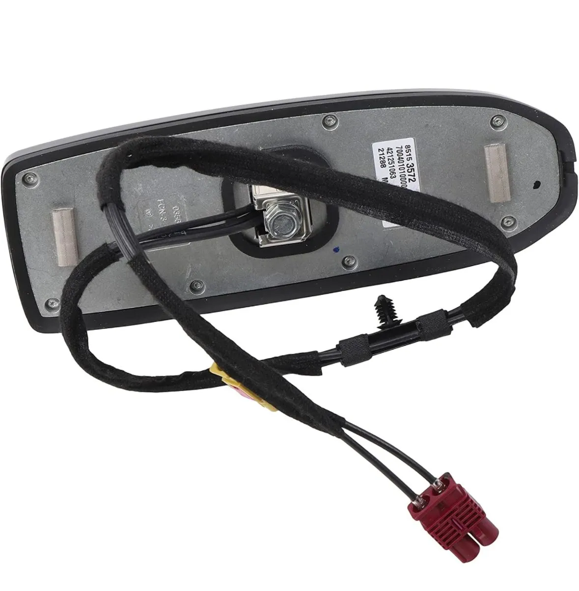

100% positive it’s the shark fin.

You are correct my friend. Just went out to take a close look and the shark fin appears to be a tiny bit loose so heavy driving rain can get underneath the rubber gasket. They will have to tighten up the antenna. Not sure how happy I am that they'll have to pull the headliner to get to it 😞

They all fit a little loose. The rubber seal on the outside is visual and a first line of defense against driving water. The real seal is a foam ring that’s compressed with a nut on the underside of the panel.
As long as the interior guy is good and he isn’t racing the warranty clock on flat rate it should be okay. You shouldn’t have to drop the entire liner to access the big nut on the bottom.

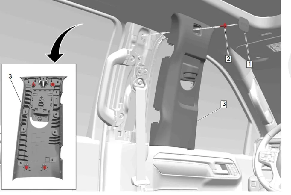

Driver sunvisor, a pillar and b pillar trim, door seals on the drivers side and you can reach your hand under and change it out. As long as they don’t get lazy and crease it rushing it will be fine.

Thanks Wu! Do you think I can do this myself? Do you really have to remove the b-pillar trim???

I would. You risk creasing the liner if you don’t. The headliner is a rigid board. It doesn’t fold like the ones of yesteryear.
If you’re comfortable with trim work it’s an easy job. Detrim, verify the leak and change it out.

Thanks...do you have anything you can share that can help me remove the b-pillar fairly easily? So, if I am understanding you correctly,...should I just try to tighten that bolt and see if I can get it secured to the roof a bit better?

Sure can.
Just make sure you line up the height adjuster for the seatbelt when you reinstall it.
You can try to tighten it. If it is the leak, chances are the foam seal is compromised.
Sure can. View attachment 9053

No Silicone. If the seal is compromised let warranty pay for a new antenna. The compression seal is all the shark fin needs. If there’s ever an electrical failure you’ll have to deal with the mess of cleaning it up.
