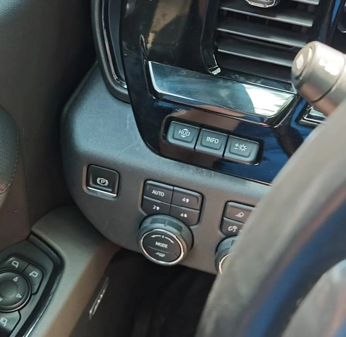

Spent the week doing some bench testing and R&D on a couple of custom electronic mods I've been cooking up for the ZR2. Wanted to throw them out here to see if anyone else would find these useful:
Affordable DFM & Start/Stop Disabler: Got completely fed up with the insane market prices for these things, so we engineered our own budget-friendly version to kill both annoyances without breaking the bank.
Auto Hold: I missed this feature from my old Euro SUV and couldn't find anyone making a solid aftermarket option for GM trucks on Google. So we built it from scratch.
Red-Light Hold: In Drive (D), hold the brake for 5 seconds and it automatically engages the electronic parking brake so you can relax your foot. Tap the gas to smoothly drive off (no rollback).
Auto-Park: It also automatically pulls the electronic parking brake the exact second you shift into Park (P) for safety.
Testing has been 100% flawless on my rig so far. Just curious—would any of you guys run something like this on your trucks? Let me know your thoughts!

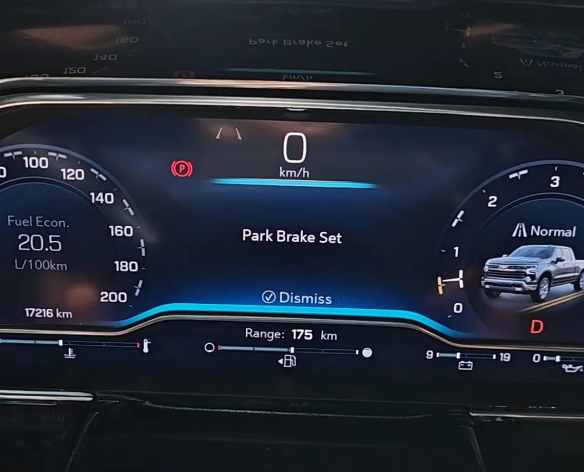

Red-Light Hold: In Drive (D), hold the brake for 5 seconds and it automatically engages the electronic parking brake so you can relax your foot. Tap the gas to smoothly drive off (no rollback).View attachment 27457
Absolutely
All of it..... I already have a range module but there is a huge market for all of that! You should see the pavement princesses over here.🤣
Would love to have an auto start/stop disabler for my 3.0L baby max
The auto start/stop disable function really shouldn't be impossible to activate—after all, it's just a simple OBD function. However, I don't have the 3.0L model on hand; I only have a 6.2L ZR2.
Auto Hold Definitely!
We are currently evaluating whether the activation delay for the Auto Hold function should be set to 5S or 3S. In terms of actual driving experience, the 5S setting feels quite good—what does everyone think? The system requires the vehicle to remain completely stationary for the full duration before Auto Hold engages.

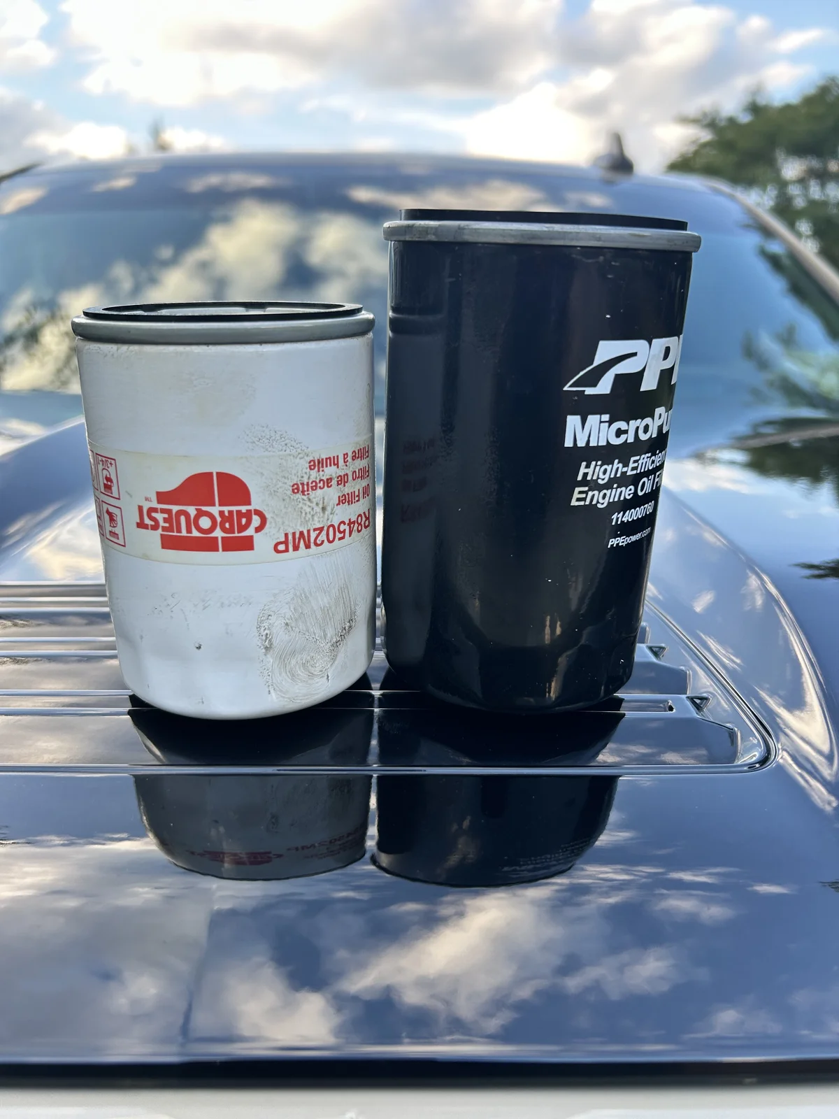

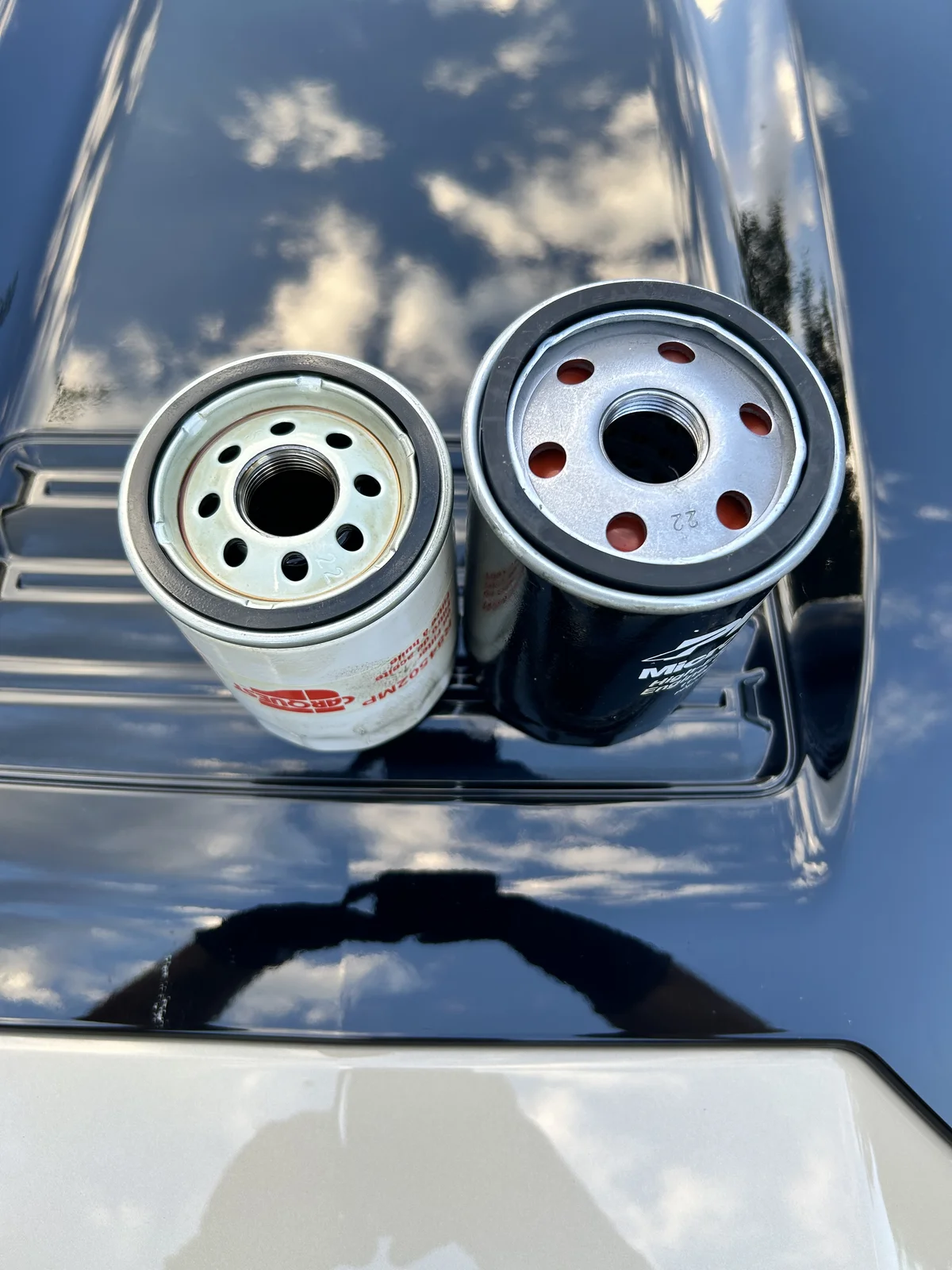

Did my first oil change on the pig today! Opted for a larger pacific performance filter (part number 114000760) with a magnet in it to catch any extra metals. If you’re one of those that sends your oil off to be analyzed, just be aware it might give you a false negative for engine wear. Used Penzoil ultra platinum 0w-40 for SRT and Dexos engines.
View attachment 27439View attachment 27440
Make sure you check your oil level in the pan. PPE filter holds almost a qt of oil.

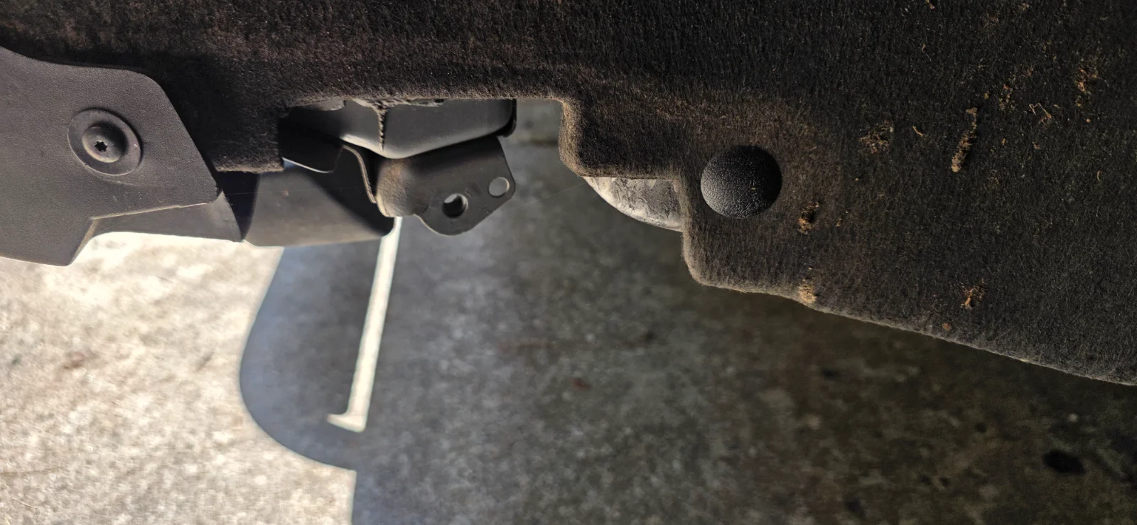

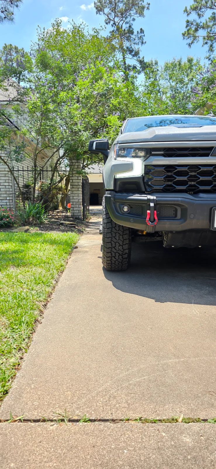

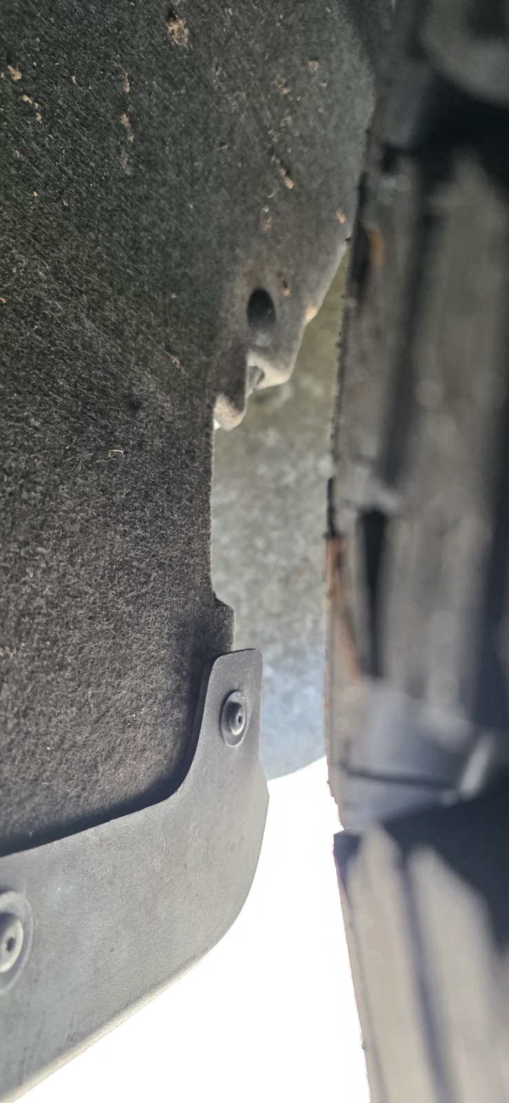

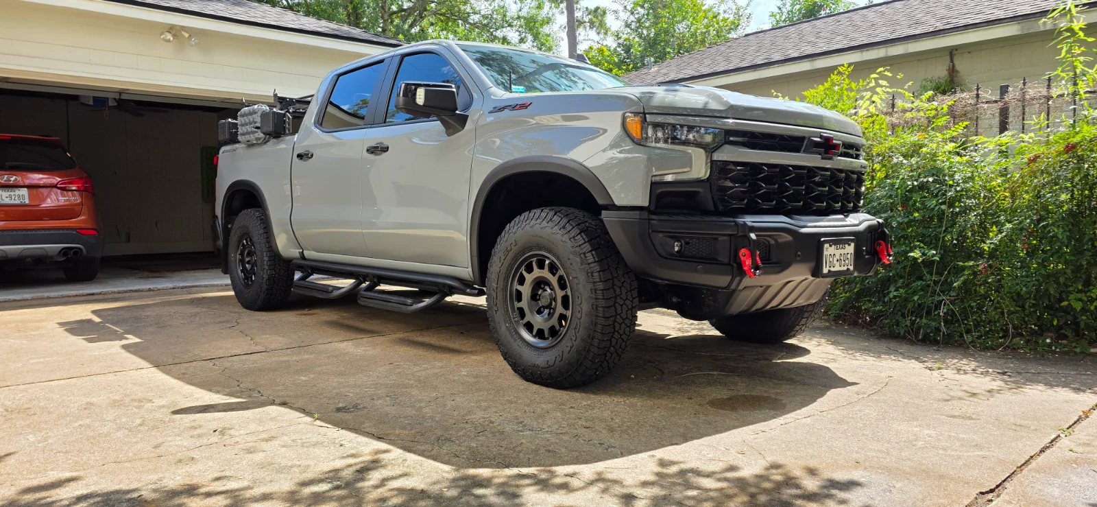

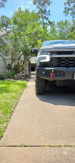

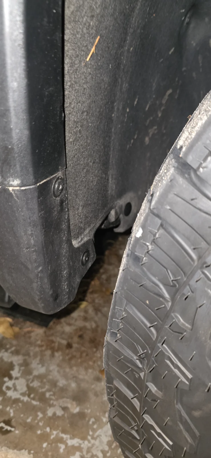

Finally got around to putting 35 's on the Bison. Went with the AEV Salta XR wheels 17x8.5 +12 with Falken Wildpeak AT4W 35x11.5r17 tires. Definitely an OEM+ look but I feel like this is how they should have done it from the start.
It wasnt rubbing unless I stuffed the wheel and turned hard but id rather trim a bit and be prepared. Threw in a few pictures of the little bit of trimming I did. Removed the braket behind the liner, trimmed the plastic of the bottom of fender flare that when deep into the wheel well and then drilled a hole through the liner and crash bar and used a Christmas tree pin to hold the liner back. I think it looks pretty clean and you can't really tell it's trimmed.
