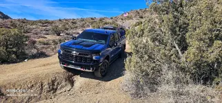

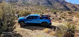

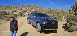

The Z looks tough on that trail brother! We just got home from Utah.A few shots from a clean up run. Still haven't done the rock light kit yet. It's 8 light kit so lots of wiring.

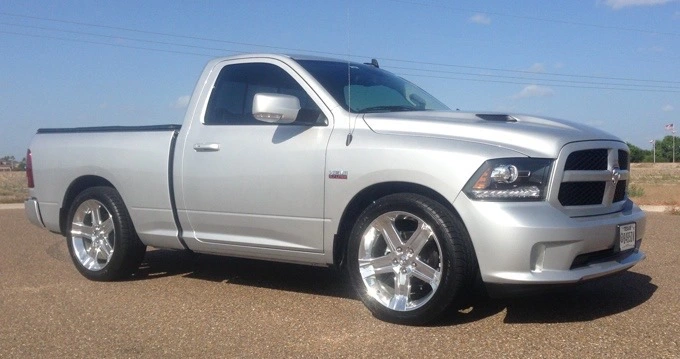

In the end, I chose Dirt King over Peak based on past experiences with bushings similar to the Uniball and Derlin bushings. This experience was on a lowered truck, so that may have had something to do with my bad experience.
