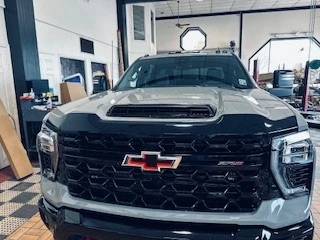

Added the wireless keypad to unlock the doors. Also added a stubby antenna and replaced the chrome 6.2 emblems with red and black ones. It’s the little things.

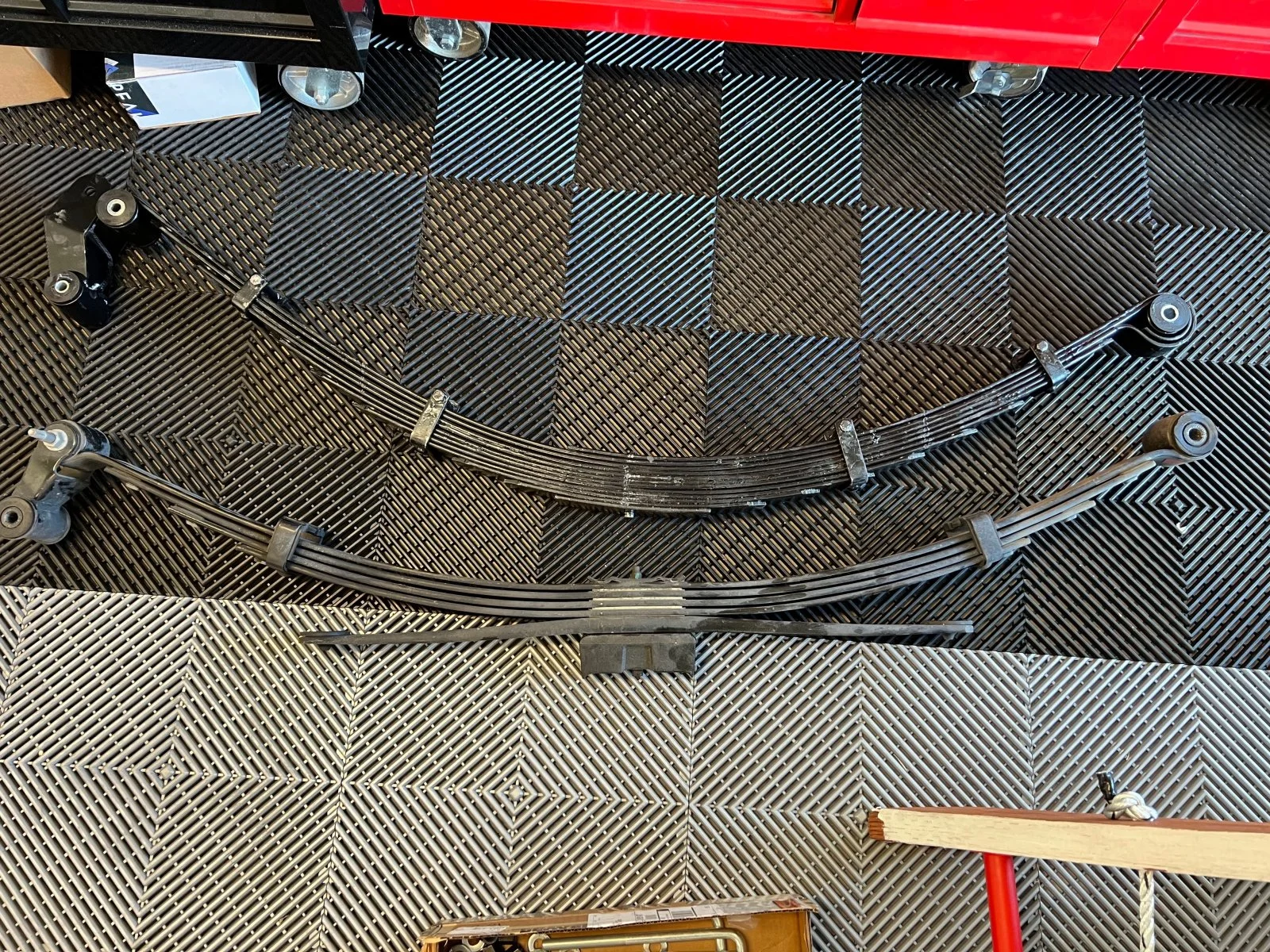

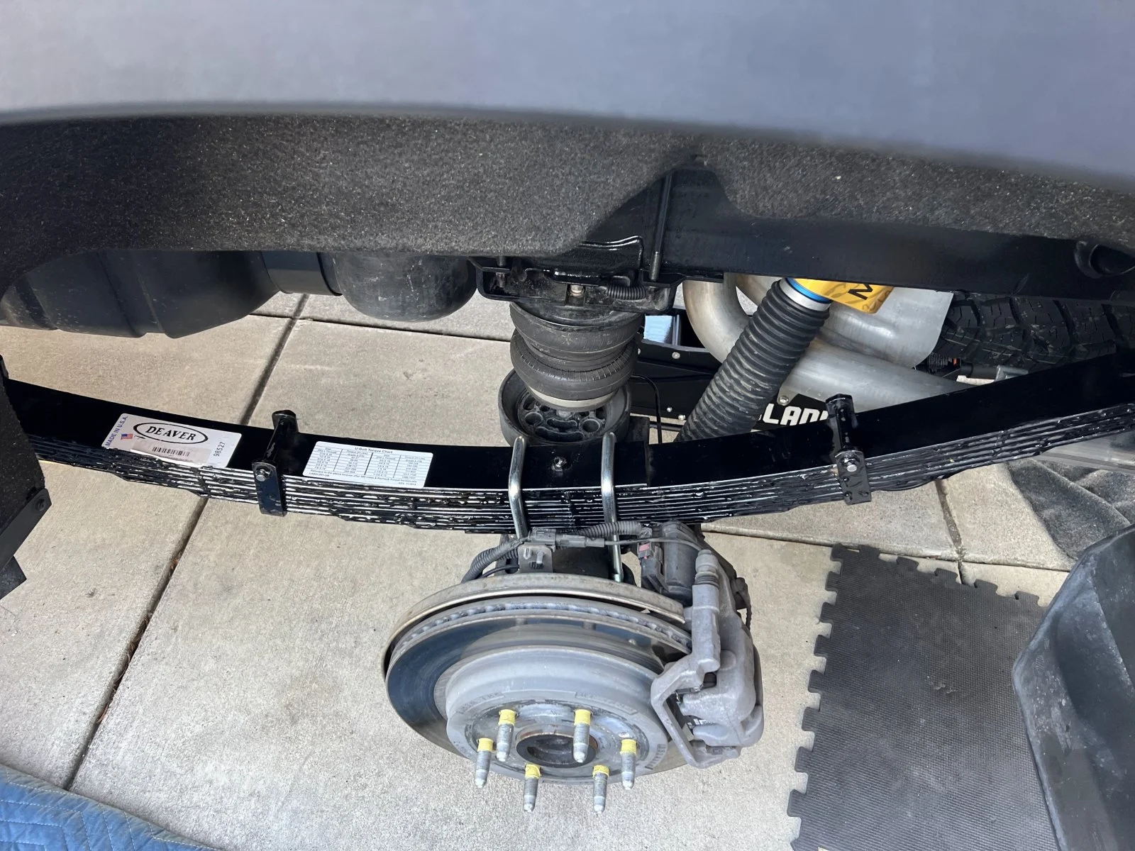

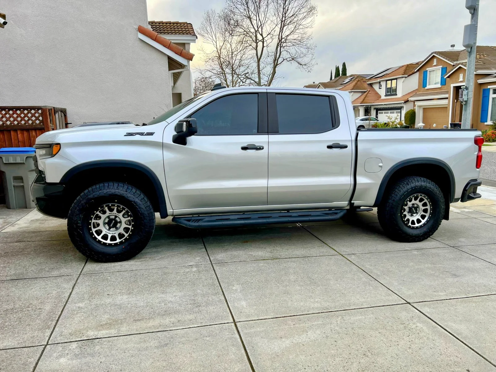

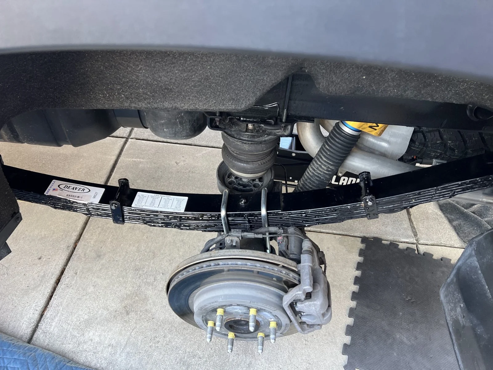

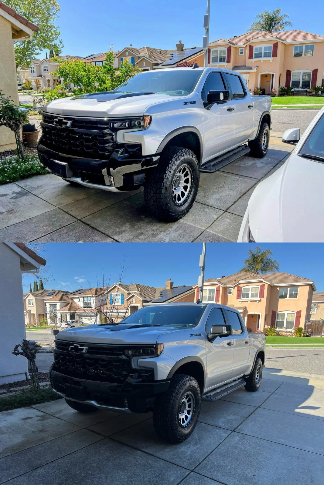

Spent a bunch of money and the truck looks almost the same. But it rides better so that’s nice.
Added deaver r81 rear springs with dirtking long travel shackles. This ended at the same ride height as stock but without blocks. The springs are capable of way more travel if the shocks would allow it.

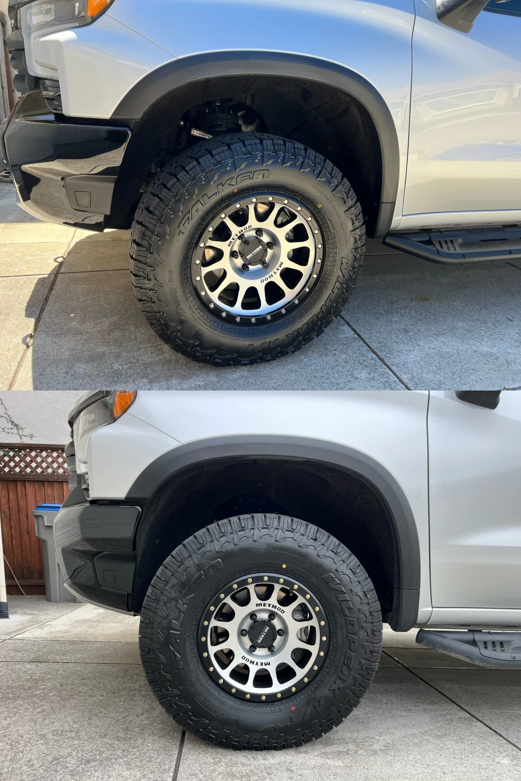

And I swapped to 17” wheels with zero offset and 35x11.5 tires. The tires are true 35s and c-rated, but the new offset and narrower tire doesn’t rub on the crash bar at full lock anymore.
Here’s a little before/after:

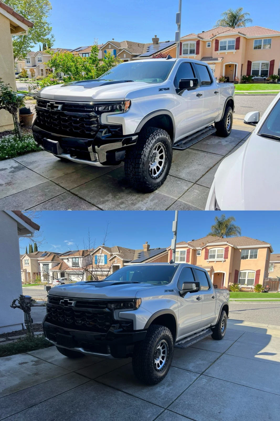

Here’s pics of the new setup. Had to trim studs about 1/4” to fit 1.5” spacers which I didn’t think was necessary reading some posts but I guess. Glad I didn’t go bigger tires as I had to do some trimming of plastic on rear front fenders.
That’s a huge difference. Looks good.
Wow. I was almost ready to pull the trigger on 1.5” spacers over 1.25” because I thought there was no cutting required on the bolts and no trimming required for rubbing. Which brand spacers did you get?
Bora

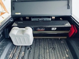

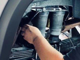

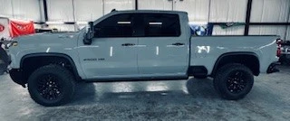

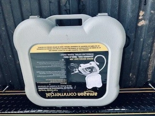

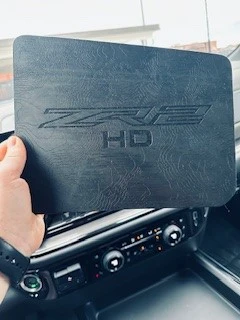

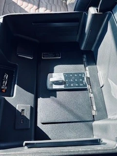

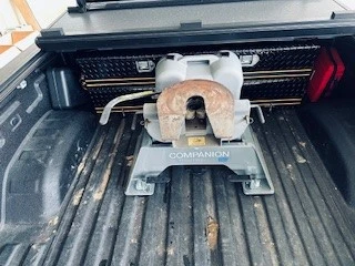

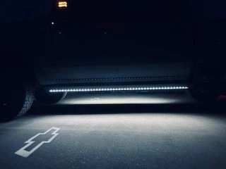

Here is a list of all my 2024 ZR2HD Upgrades. Bed cover, power steps, Aux fuel tank/toolbox, console safe, Banks idash X 2, pedal monster, wood console insert, console safe, air bags with compressor, key fob protective case, portable fuel pump, puddle tights, Borophene 3.0 Ceramic Coat, Companion Hitch, trailer camera, trailer tire monitors, Kicker sub woofer Key pad code entry, hitch safety, and Hood protection. Future upgrades will be leveling kit, Banks Derringer, Banks intake, and Banks Turbo Hose Upgrade.
