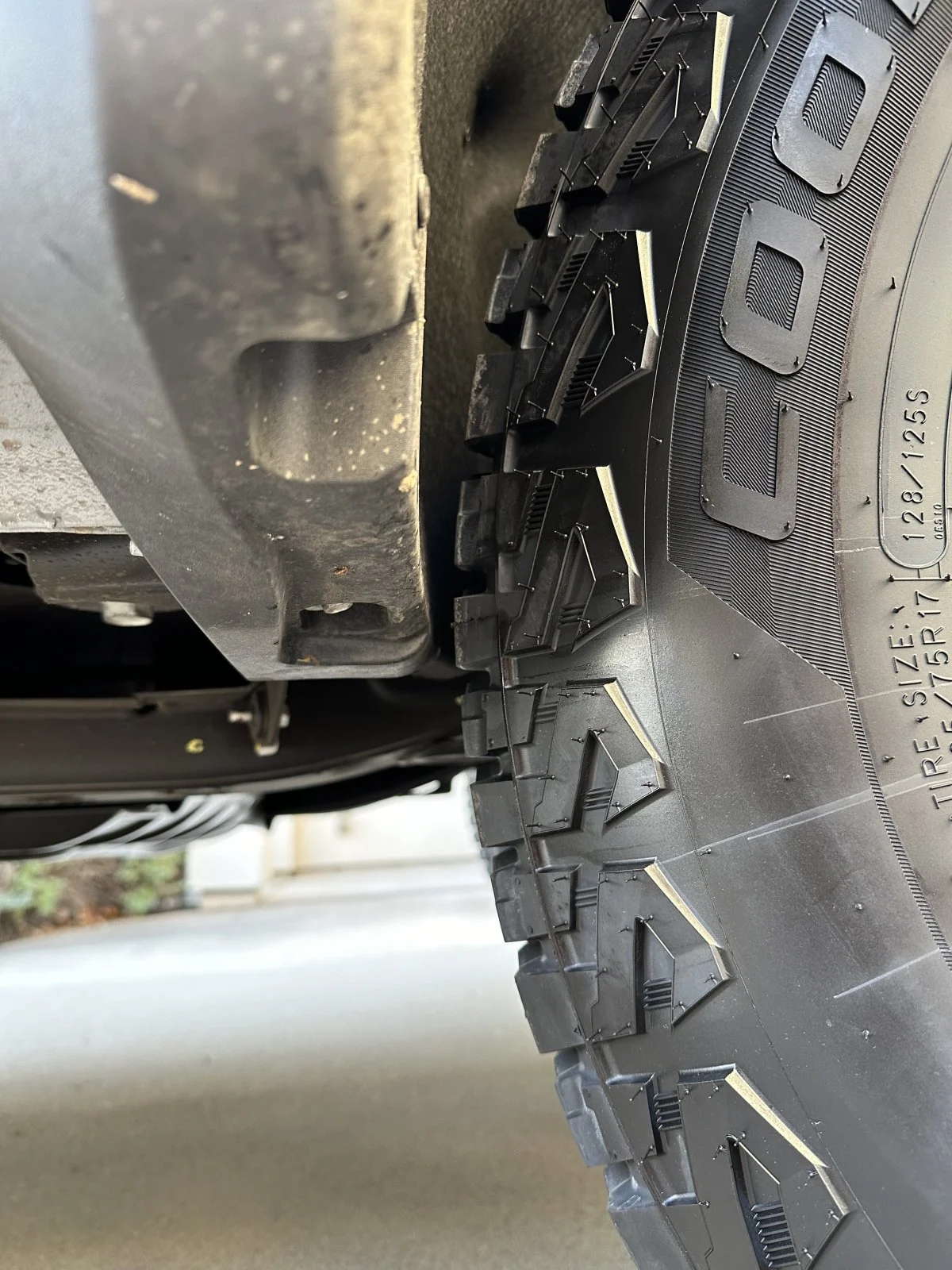

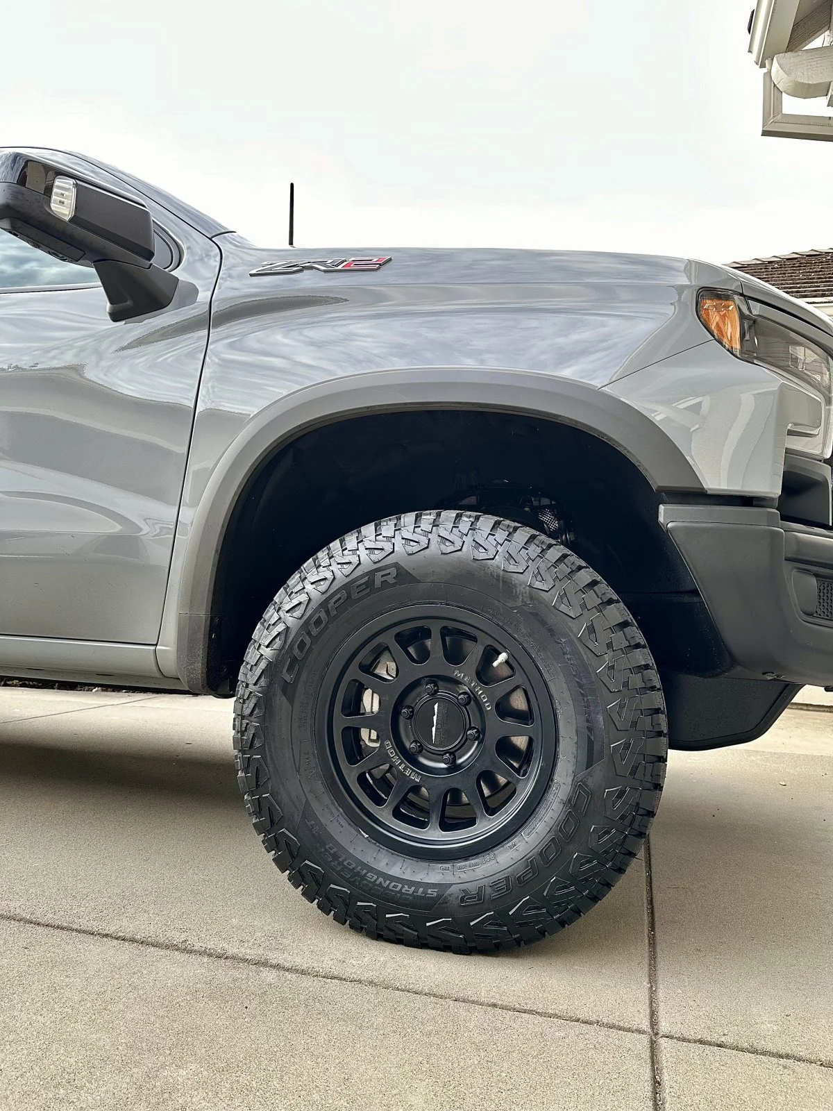

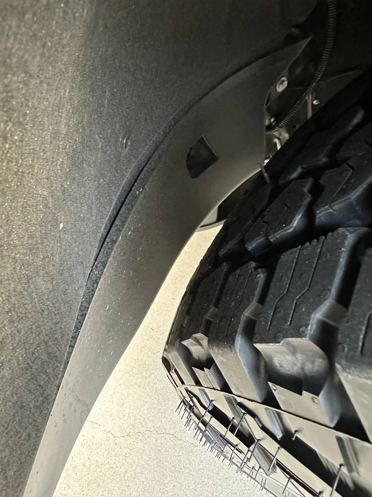

Truck: 2024 Silverado 1500 zr2 Bison
Tire: Cooper Discoverer Stronghold at
Tire size: 285/75r17
Wheel: Method 703, 17x8.5 et0
Suspension modifications: None
Any trimming performed: None
No rubbing full lock both ways
Alright so as I figured when switching from the 295/70r17s the Coopers run slightly undersized compared to others. Really glad I switched to the 285/75r17s as they are the perfect size for this tire and truck. Completely stock suspension and zero trimming I’m getting no rubbing full lock both ways, including full lock in reverse.
Will try to get more pics later, this is the cleanest these tires will ever be lol.

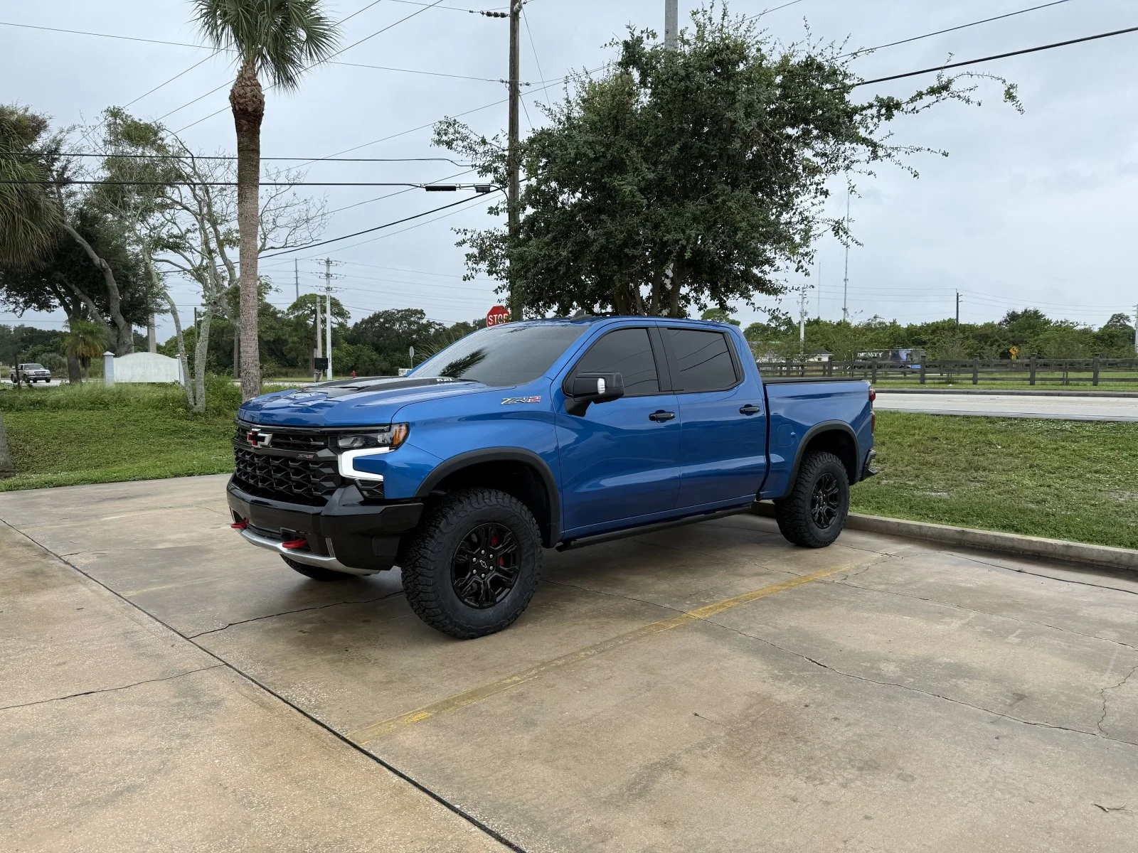

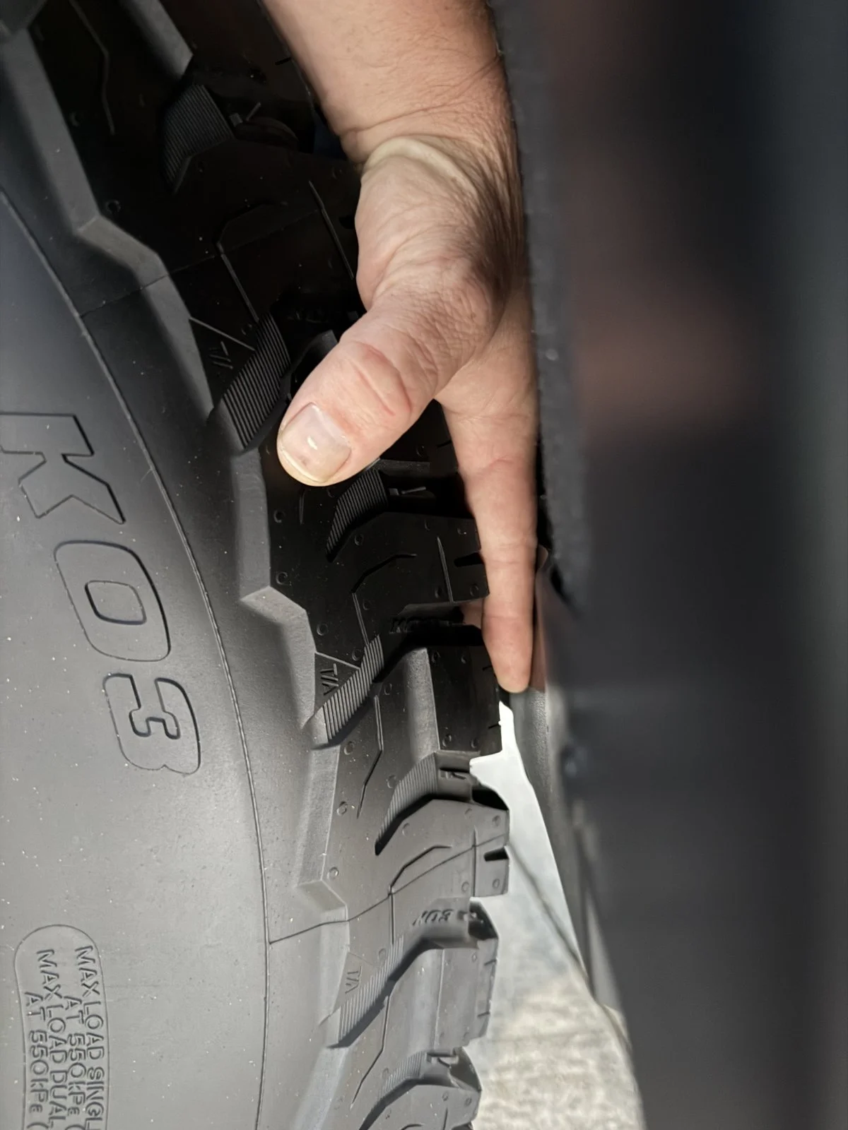

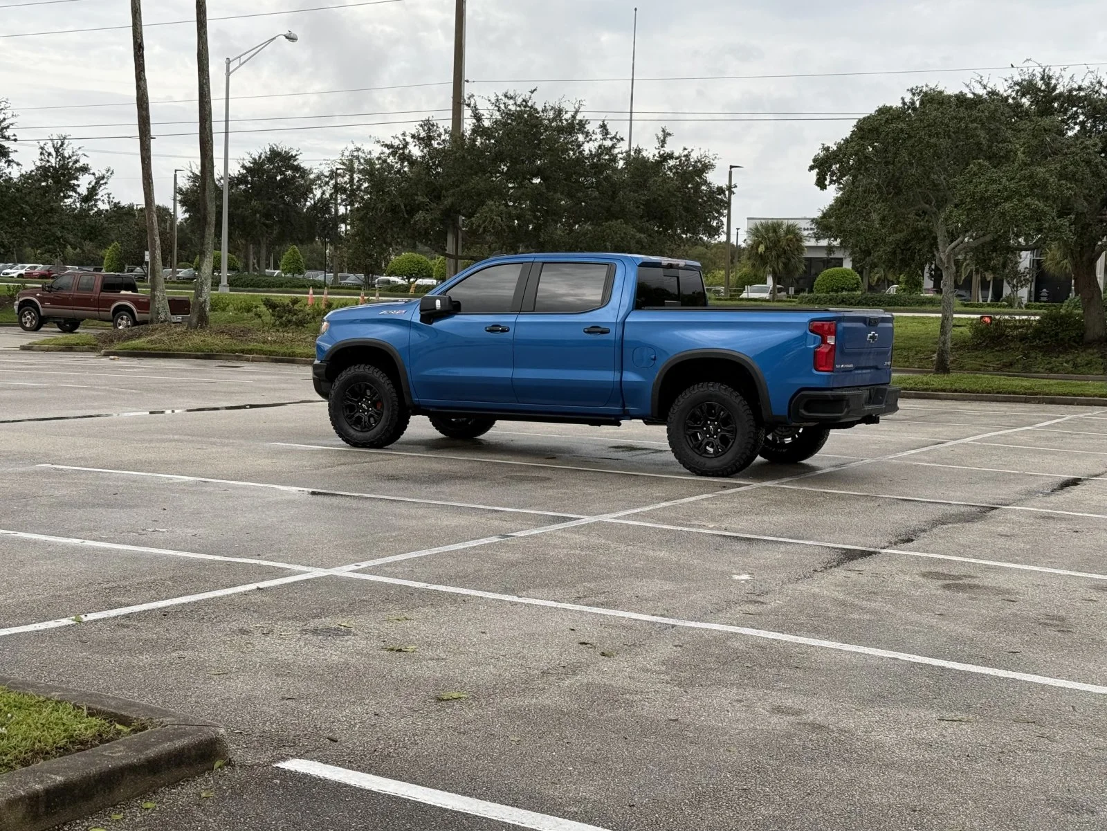

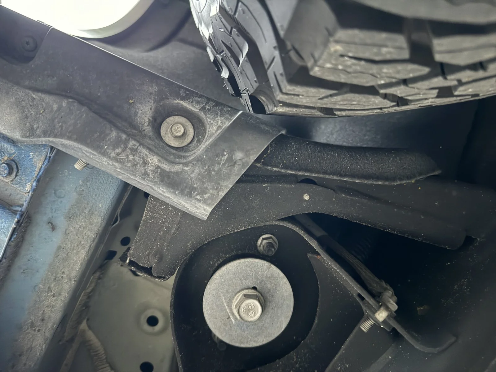

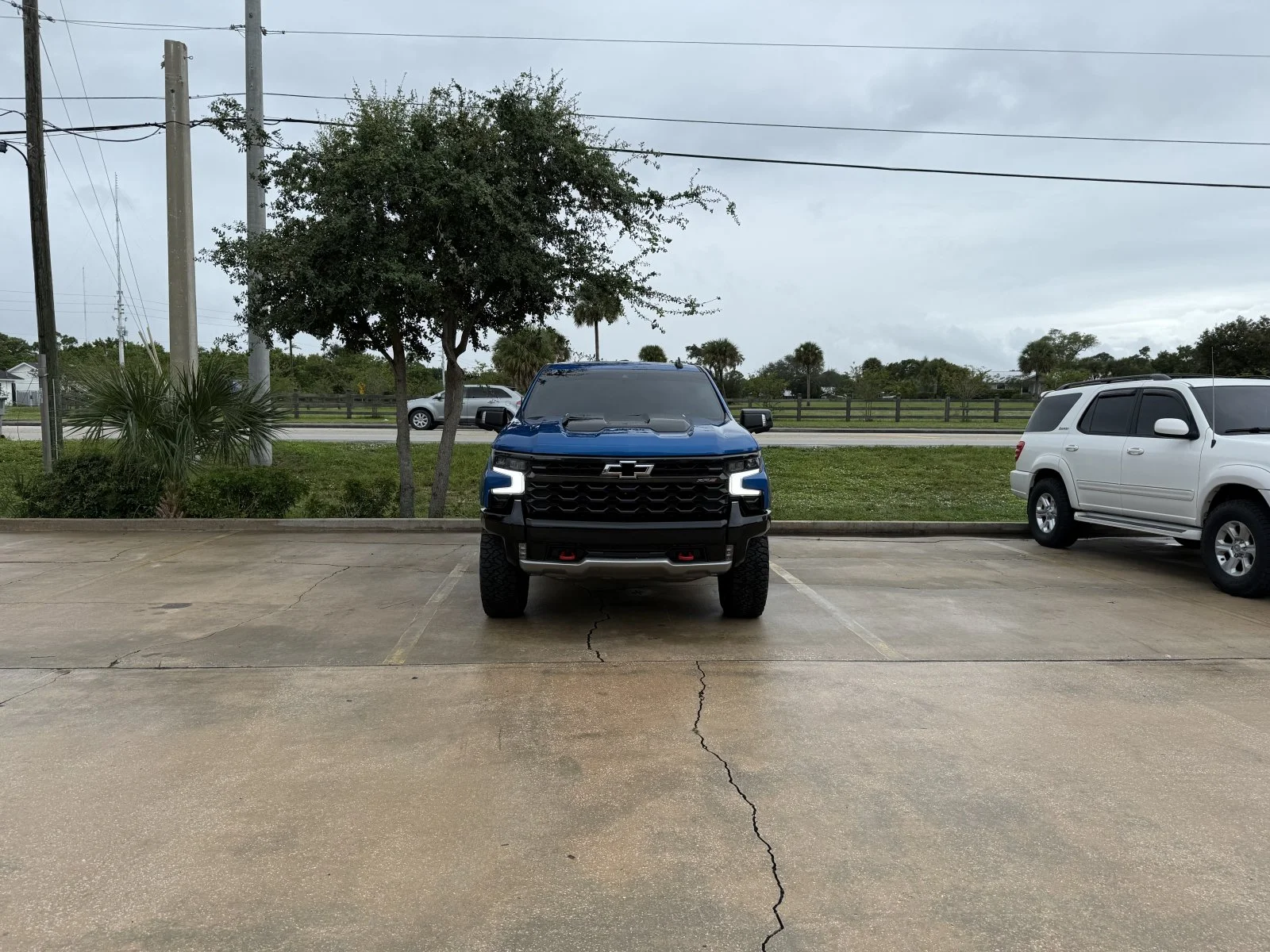

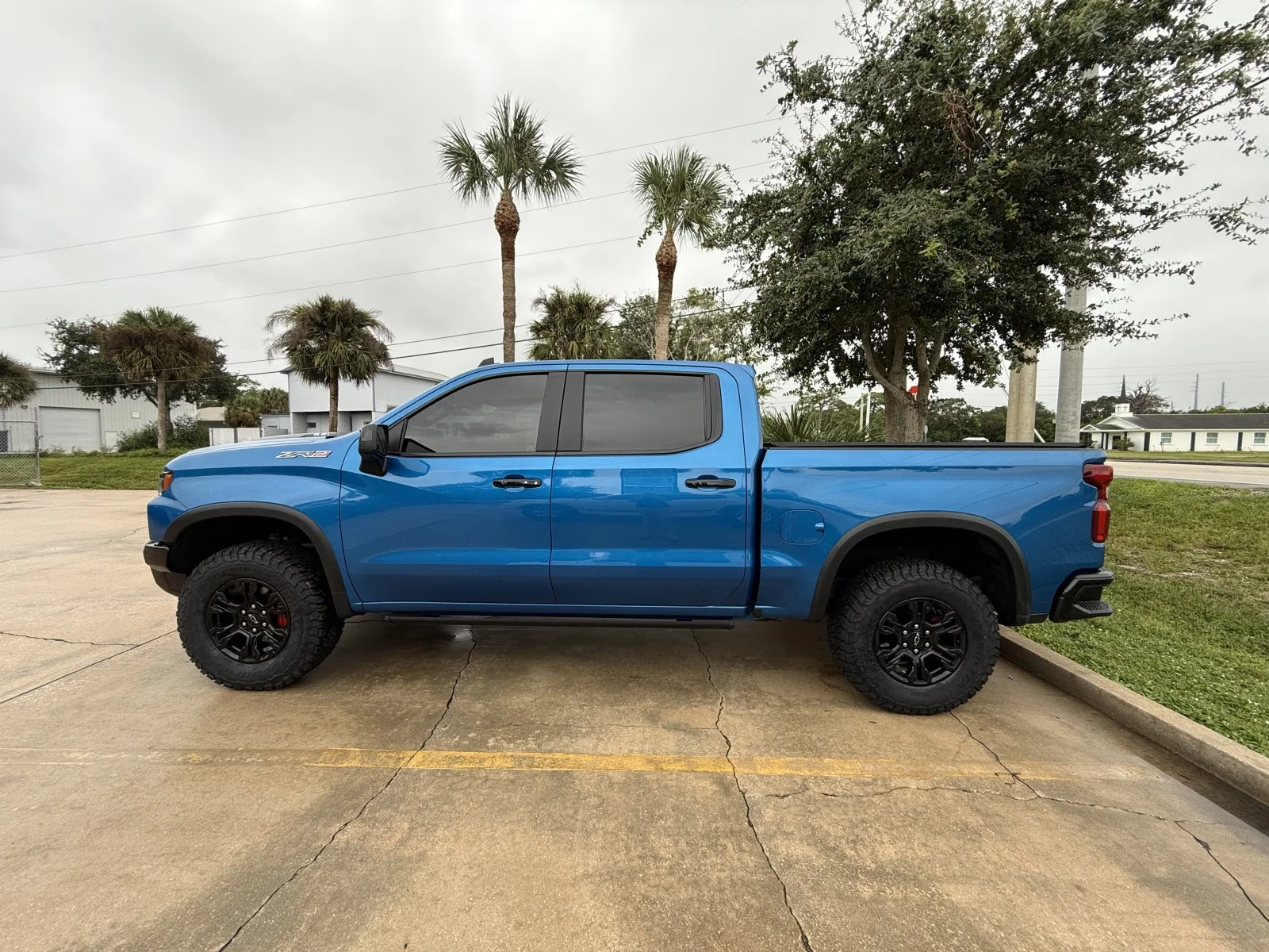

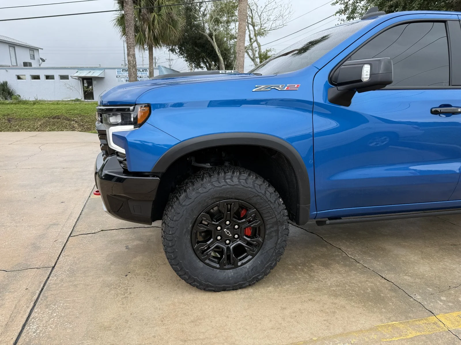

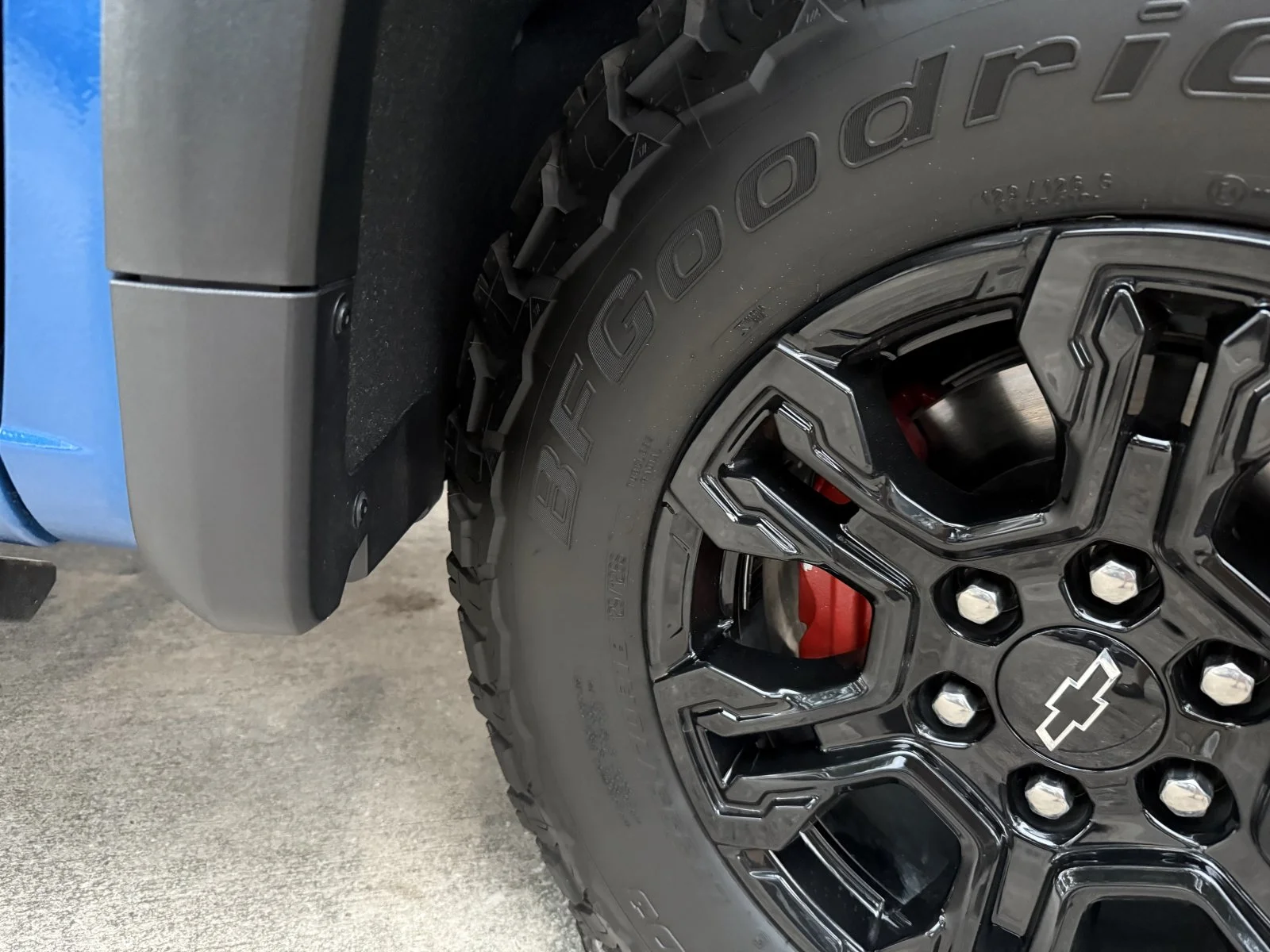

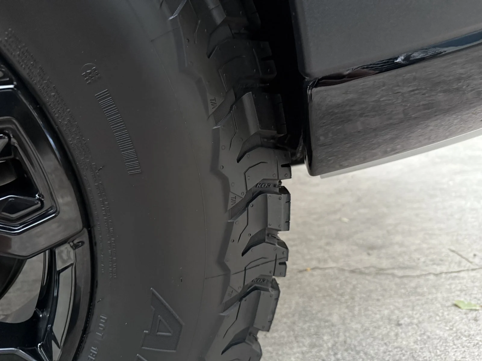

295/70R18 KO3’s
Stock wheels 3/8” spacers (effective +18 offset.)
No hard clearance issues at all in roughly 1000 miles. They just brush the inboard fender liner fabric on full crank.
I’m comfortable in saying this is absolutely as far as you can push a stock suspension truck without modifying anything.
Tires are absolutely fantastic with 45/42 pressure. Highly recommended.

Just curious, are you using extended thread lug nuts with the 3/8” spacers? Or are you just using the stock lug nuts?
The Spacers are hub centric and use the stock studs. Plenty of engagement on the threads. No concern of a wheel falling off. Anything more than 3/8 or 10mm you will need to extend the studs.
Thanks! I have those spacers. I also bought extended thread lug nuts, but I don’t like the size of the nut itself. Guess I’ll give it a try with the stock lug nuts.

Looks great- do you think the spacers were necessary for fitment? Any scrub offroading?

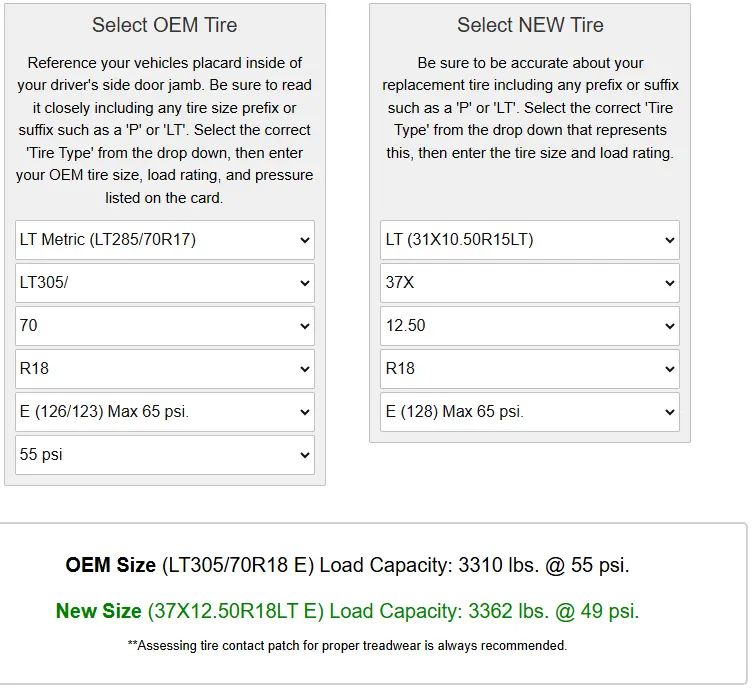

Tiresize.com has a really nice calculator that will modify the door sticker PSI to match the tire load capacity when you change tire size and load rating.
My rears for example:
Not at all required for fitment. Purely an aesthetic choice.
I haven’t done anything hardcore off-road but it has not touched thus far. Without spacers there’s absolutely zero chance of them rubbing. But these tires are 34.3”. Be mindful of whatever your choice measures out to as there can be variance. Mickey Thompsons for example measure 34.5 and I can’t vouch for that.
Going off that calculator for the factory C rated Goodyears they claim 35 psi. The tires are mashed potatoes at that pressure. Much too low.
I originally started based on that calculation. Way off. BFG stands hard on 45psi bare minimum operating pressure(for street use). My tires warm will run 49-50 front 45-46 rear.
FWIW the placard on my 2022 said 35 psi while the placard on my new 2025 says 38 psi.
