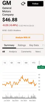

This will take years to fully resolve. They will slow walk it, so it doesn't impact their quarterly earnings significantly during the process. That way the stock price won't be affected.
It'll be interesting to see if they announce the expected actions and impairment charges during their next quarterly report, which won't be until July mow. Perhaps they will announce it pre-earnings.
Right now, Wall Stree seems to be digesting it just fine, maybe they don't think it's a big deal.
