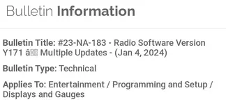

Lots of problems with infotainment and radio starting with refreshed 22 models with Google bases software.
You can have your dealer start with this latest upgrade available since early January. Some people are seeing some luck. Mine has been better after this update, but time will tell if it's a real fix.
Most previous updates did not work or made things worse in my case in my 22 ZR2. My 24 2500HD ZR2 seems fine so far.
