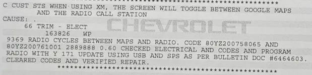

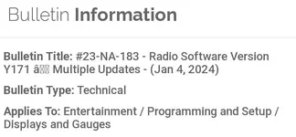

Lots of similar complaints. One thing you might do is get this latest update to the electronics and go from there. There has been some recent success reported with this update.
I just did mine and initial results are promising.
Thank you. I'm going to try to connect the truck to my home wifi when I get home this evening and try to run the update.
