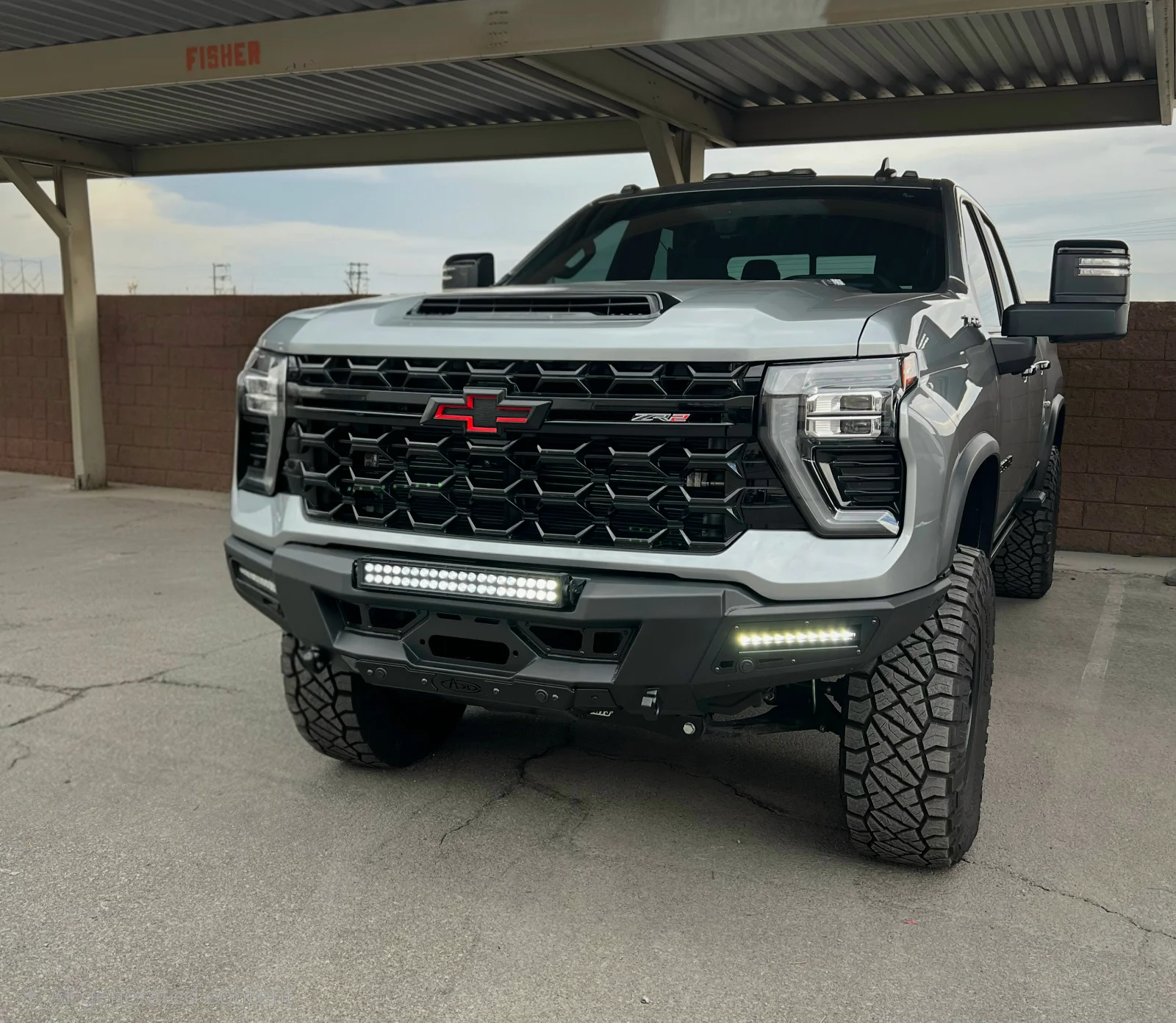

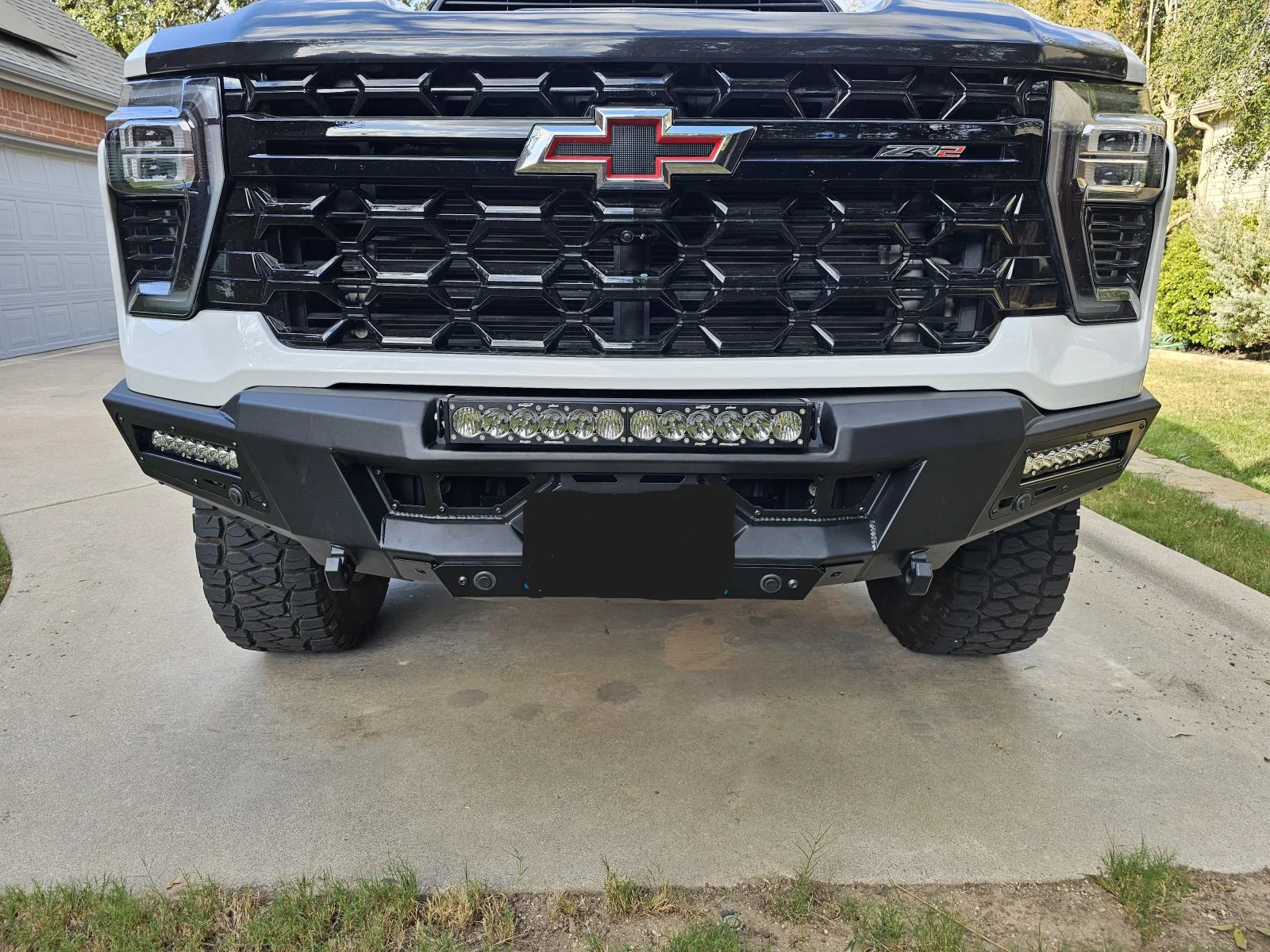

Forgot to post update photos but here yall go. Baja designs onx6 20in, (2) s8 10in in the sides and the warn zeon xd 12k winch. Still using the spod bantamx to control everything even for the power disconnect for the winch. Next is the new arb twin brushless compressor when I can get my hands on one, for onboard air.
Looks good! Gaps don't look too bad except right below the grill is a little wider. They must have read my post pre-production.
🤣 I'm sure they were worried sick about your post. Thanks, I still think it's the best looking bumper made for them atleast states side.

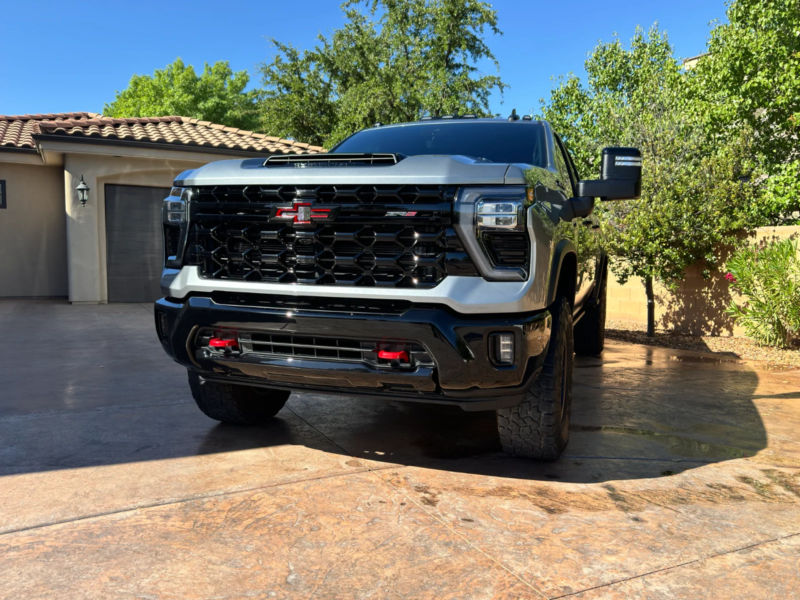

I'm considering the same ADD Phantom bumper for my 2024 ZR2 HD.
A couple questions:
1. Dave: I think you might have gone with the front license plate option on the bumper. I intend to not run a winch but I also intend to not run a front license plate. Is it going to look Goofy with the winch hole if I left it as is?
2. How did you guys run the wiring for both the 2x side lights, and the center light bar? Did you tap into the factory fog lights for the side lights? And run a separate wiring+switch for the center?
3. I went with the 4-in McGaughys lift on my truck. Based on it's aftermarket crossmember I have a suspicion that the skid plate the ADD bumper comes with may not fit.. so I may have to opt out of adding that.
If you would, let me know if you have any thoughts/feedback based on how the bumper lined up on your trucks.
Thanks so much in advance.
Here's a few pics of mine:

A couple questions:
Yes, agree the hole was covered perfectly with my License Plate. I am in Texas most of the time and it is the law here. Have a couple of friends who were LEO's and they told me do not do it. On my 2022 F250 Tremor with the winch the Ford Mount did not work so I said screw it. Got pulled over and given a written warning by a DPS Trooper. Mounted it with screws in the bumper after that.

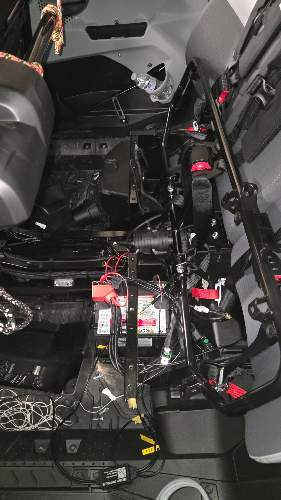

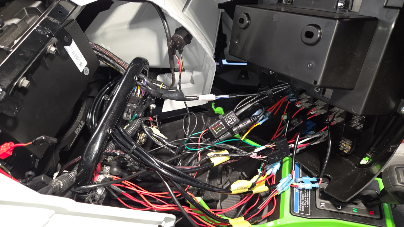

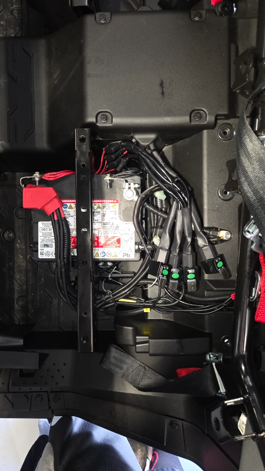

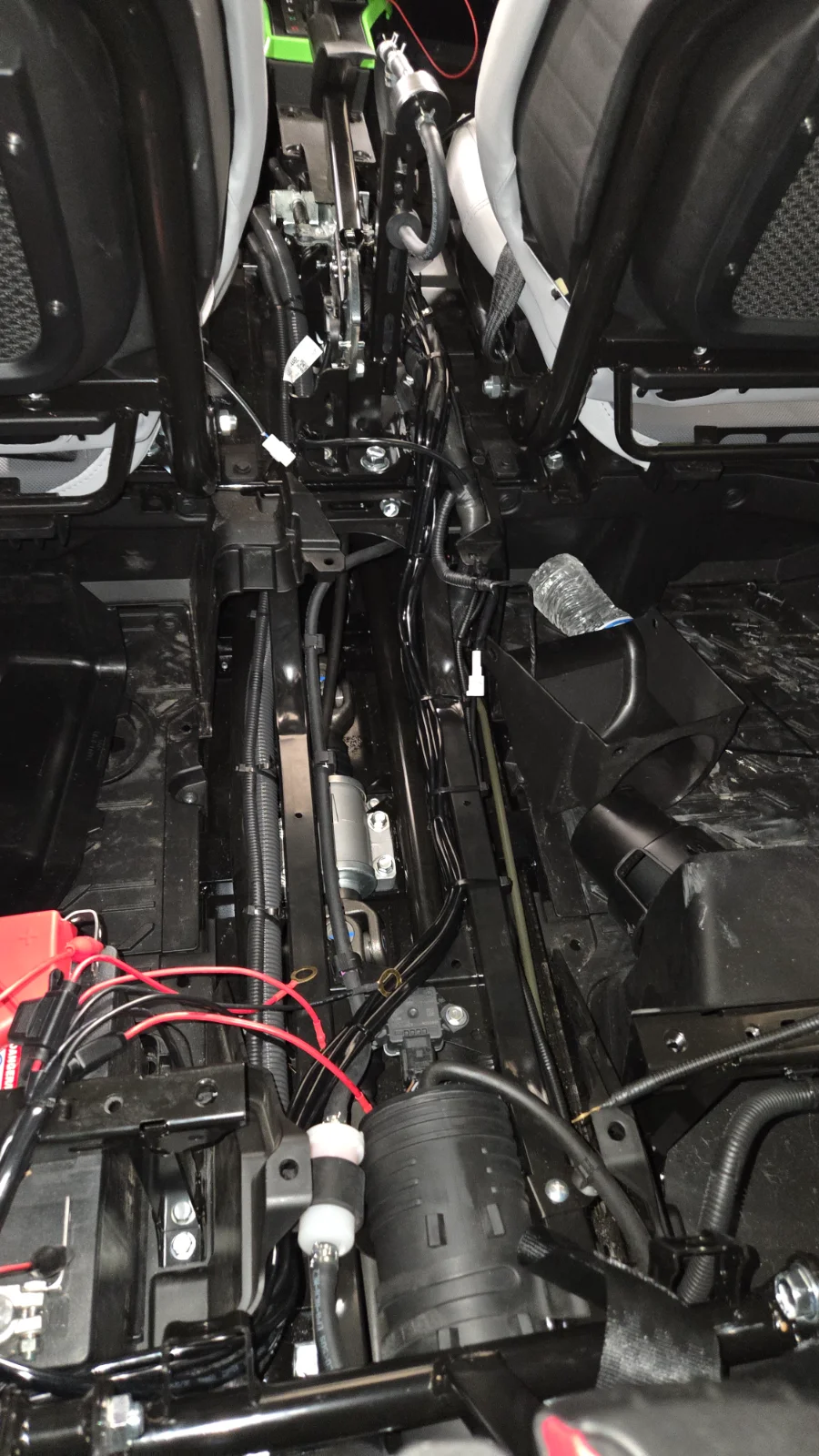

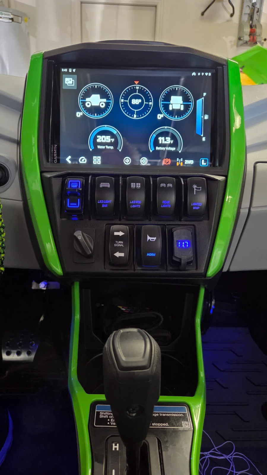

Here's what my recent sxs installed looked like. It had 4 relays and 6 switches. Turned out pretty well. Had to disassemble a lot of the interior plastic to run all the wires sonit took a while.
