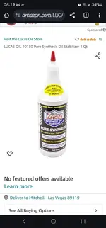

The oil additive I use is Lucas fully synthetic oil stabilizer treatment. I use it every oil change. It's about 20 bucks a bottle and I usually put two quarts of Lucas and then the rest Mobile One synthetic oil. Lucas calls for an 80% oil-20% treatment mixture.
I have watched videos of a fella on YouTube that does testing on these types of products and he starts out with brand new engines. Runs them with a oil treatment during the break-in And then changes the oil with an additional oil treatment and runs the engines for another set of hours and then shuts them down and lets them cool and then completely drains them and lets them run until they cease. Lucas beat any other oil treatment by over a half hour after the other engines with different oil treatments had already seized. I believe it took the engine with Lucas almost an hour or so to seize.
When he dismantled the engines afterwards, the engine treated with Lucas had significantly less wear than the others. Not that I would ever ever do that to a truck engine, but it's just a good thing to have that extra layer of protection against normal wear.

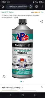

I also use VP racing fuel additive. The one specifically for unleaded that won't harm the cats and have had excellent results in both mileage and power. I got over 400 mi on a tank using the VP product.
