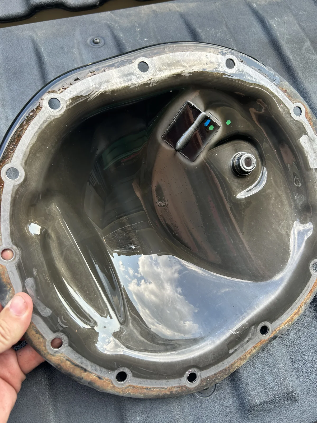

Did my differentials today. My tools for the t-case are packed up, so didn’t get to do that…. But soon. Rear looked pretty smoked at 63k miles, not sure it’s ever been changed. Front looked pretty good, so I’m wondering if they replaced the fluid with the engine or when they were working on the transmission.

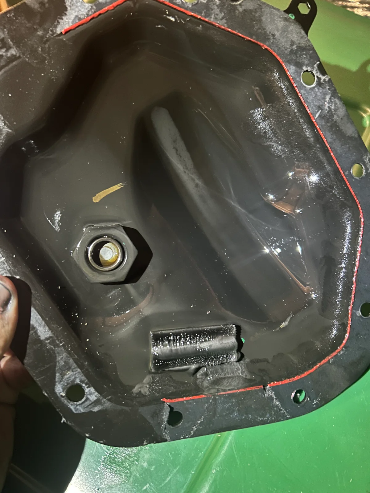

Here’s the front diff cover

The front differential never gets hot or really used much. So you will likely never have to change it again.
