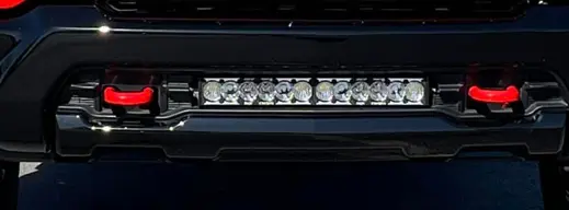

  • Lower Grille:
    • I did find a guy on the FB group that cut the center of the grille out and was able to top mount a 20" BD bar using the included brackets flipped upside down.

  • Lower Grille:
    • View attachment 17445
I have to assume he removed the entire front bumper assembly to do this, if he had a Duramax...Because there is an air scoop that is in the way of accessing the lip that you would need to drill for the brackets.
How did you mount those pods? Having them there for awhile, any issues with the grill cracking from the added weight?
I used simple heavy gauge 90 degree corner brackets for the light bar and drilled holes in the bracket to line up my spacing. They are then mounted to the thicker plastic between the waffle openings in the grille. The ambers (pod lights) use the factory bracket the came with. I cut metal mending plates and epoxied them in the grooves behind the waffle opening. Lines up perfect to make a flat “floor” plate to bolt the light bracket. I did have to cut out inside the waffle opening (they narrow as the go back) to fit the lights back flush to the grille. All told it took me 1/2 day so not too big of a job. Just gotta commit to cutting :) My original plan was to put the duallys below the headlights but I got tired of waiting on the pod mount guy so I just did it this way. Zero issues with cracking or stability. The grille is pretty heavy gauge plastic. The pod lights aren’t heavy and the light bar mounts in the center between the waffles that is thick.

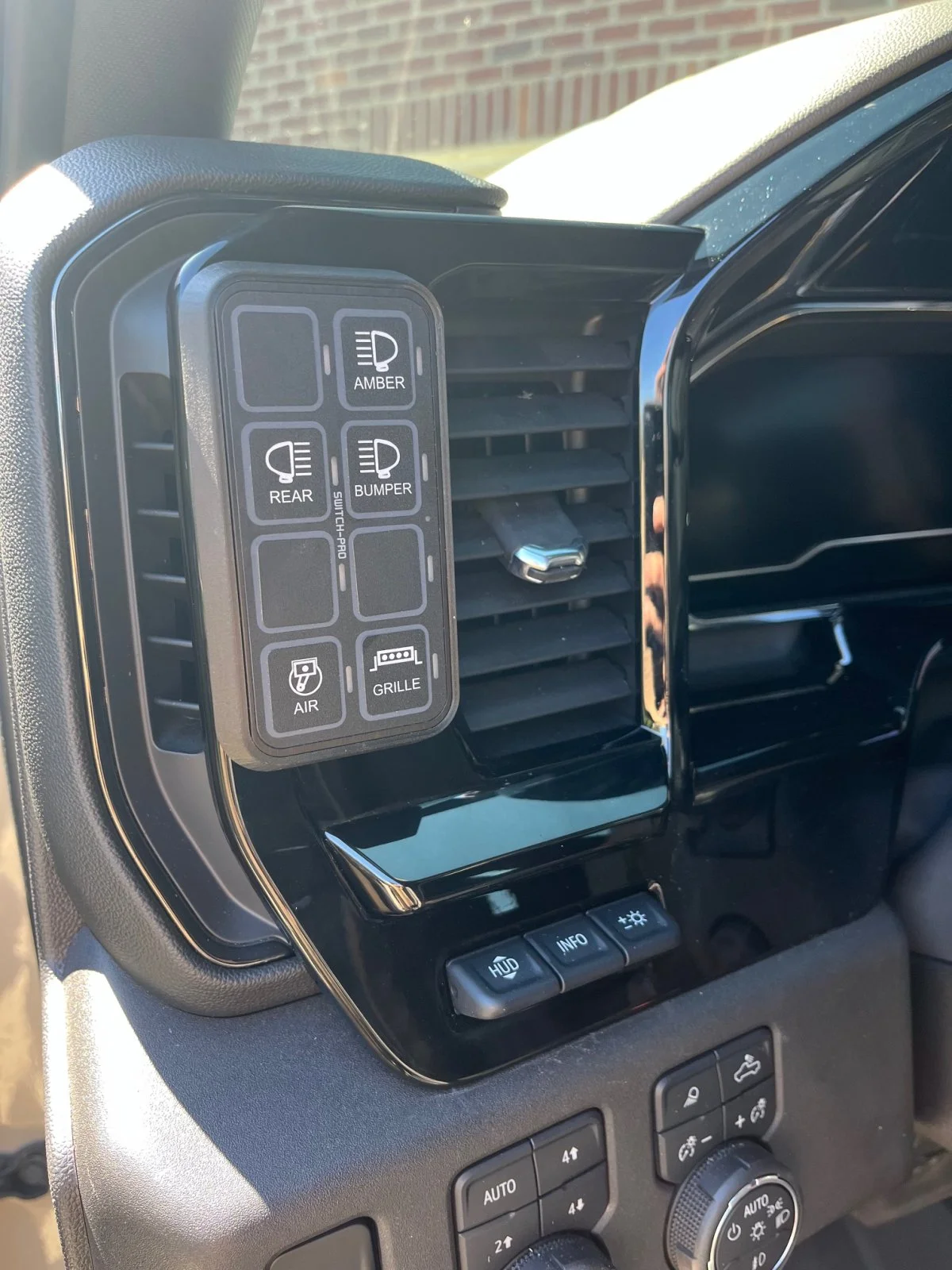

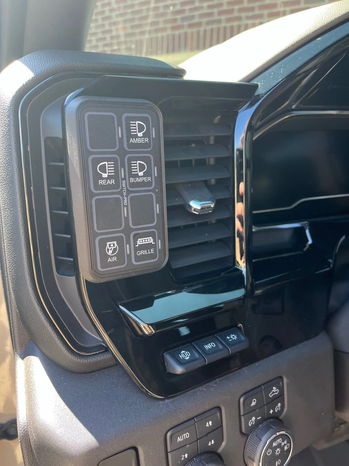

Switch pros and Spod didn't inspire me to spend double+ the cash. SSV Switchworks, over $1k?!?. Scoshe digital panel in the price range could be interesting, but I just refuse use a brand I specifically remember first seeing in the car audio aisle at Walmart.

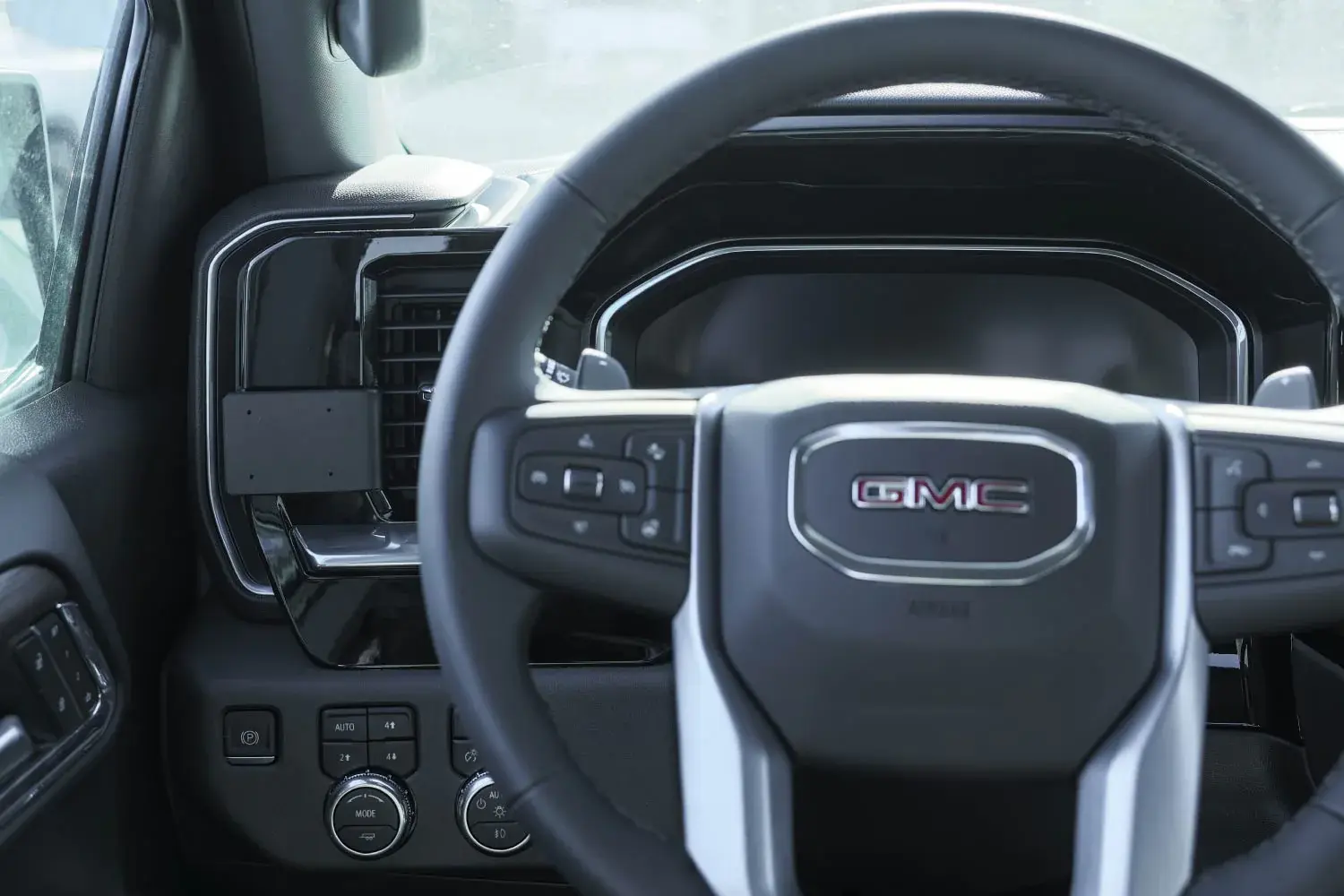

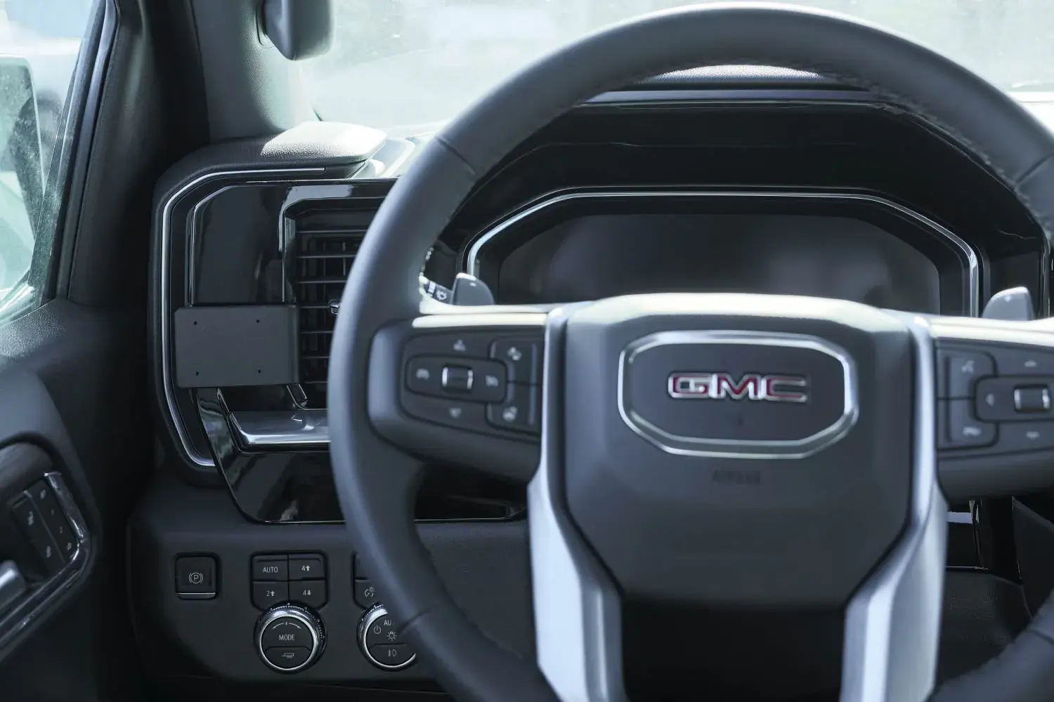

I'm considering two mounting options in the cab, under the HVAC controls similar to factory upfitter, or to the left of the door side driver dash vent on the flat piano black trim. Would use the Proclip 805993 mount there to keep from screwing up the panel:
