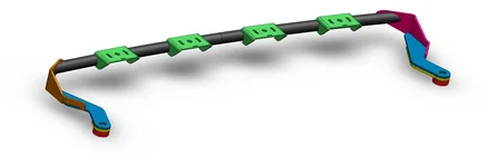

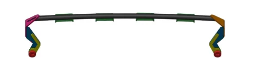

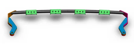

So the issue with at least the Non Bison Chevy is that the bumper isn’t flat and is raised in front of the two bolts they use. Jackson (ORC) is setting up the base to swing in, miss the bumper raise, and swing back out to catch the full width of the GMC bar. If your bison is dead flat in front of the bolt, it’s likely their GMC version may work for you.
Sounds too good to be true, thanks.
CADs. The big change is avoiding the upward bumps on our front bumper that sit right in front of the bolts. The bracket will jog in to miss that.
