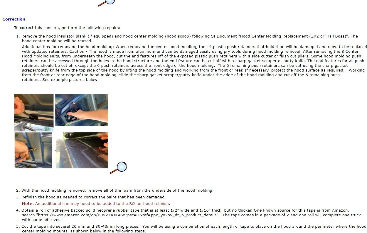

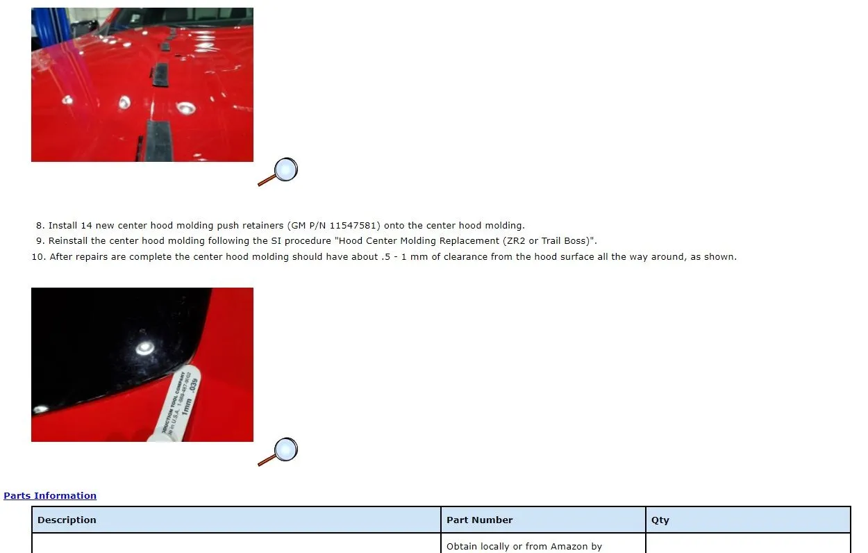

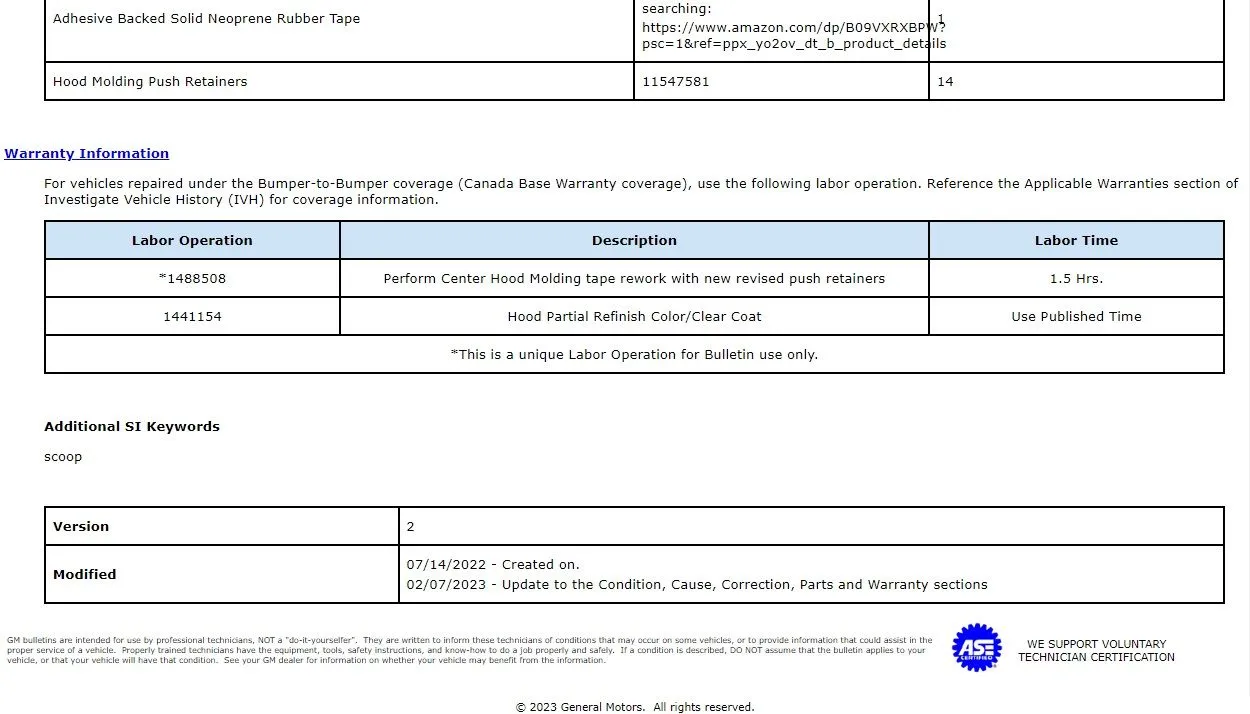

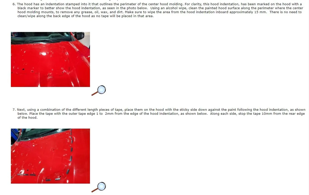

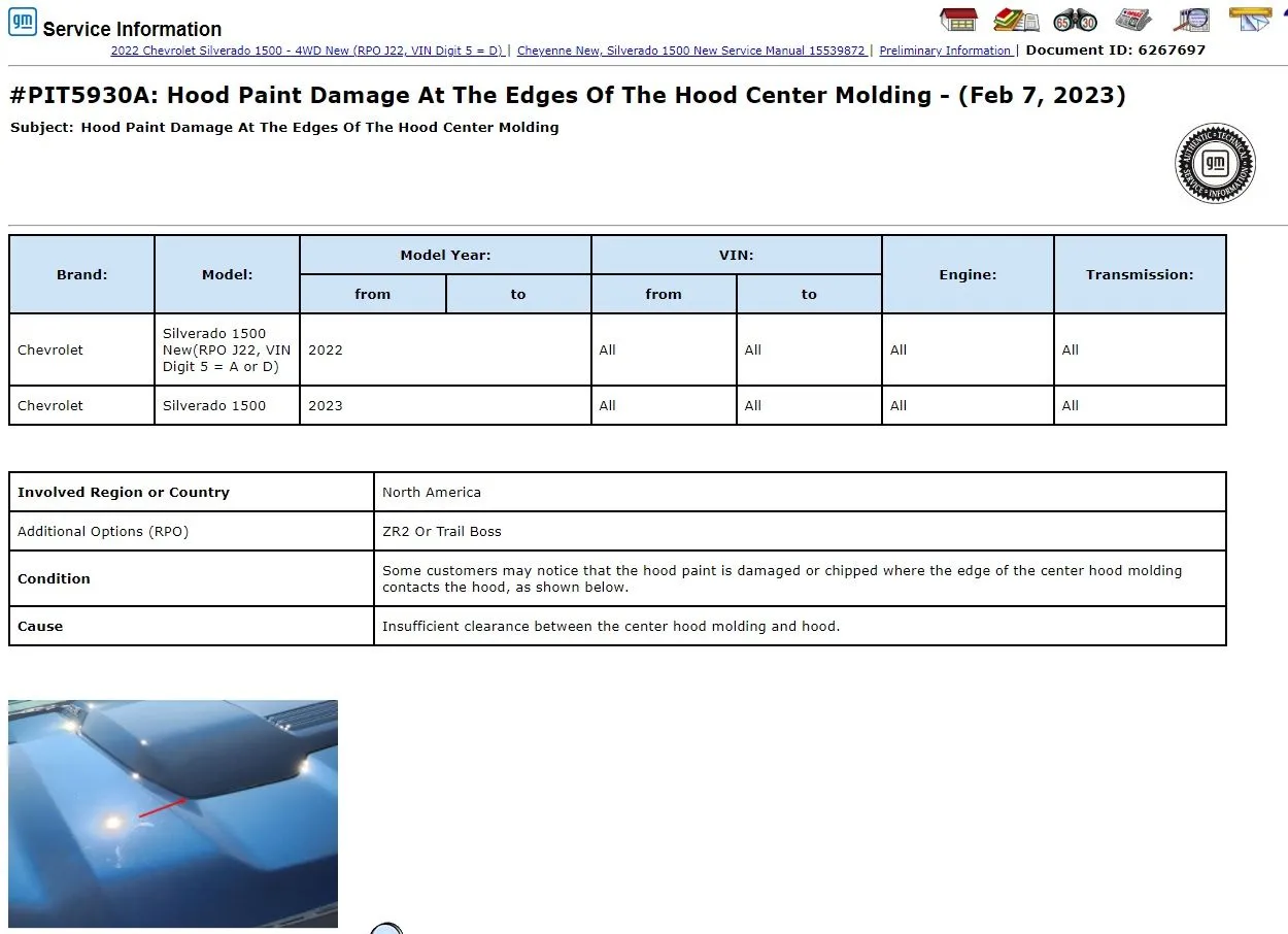

Bulletin is below.

Not sure if this is a "fix" or a hack. After reading what needs to be done, I think I'd pass having a dealer attempt this. I can see far greater damage happening by just attempting the "fix"

I think the fix looks like a fucking hack job, so I'm gonna see if they can come up with something better.

In agreement here. Good to see the issue has been acknowledged, that’s step 1. But relying on a dealer to get parts from Amazon seems a little suspect. I would feel better if GM put a parts kit together, with proper neoprene tape for the dealers to address each truck that has the problem. So far, my hood is fine. Mine is a 2023.

For the life of me, I can't figure out why they didn't just stamp these hoods like they do for the Duramax. It would look higher quality and be virtually problem free. They created a problem that should have never existed.
I guess so they could issue some lighter colored trucks with black contrasting cowlings?
