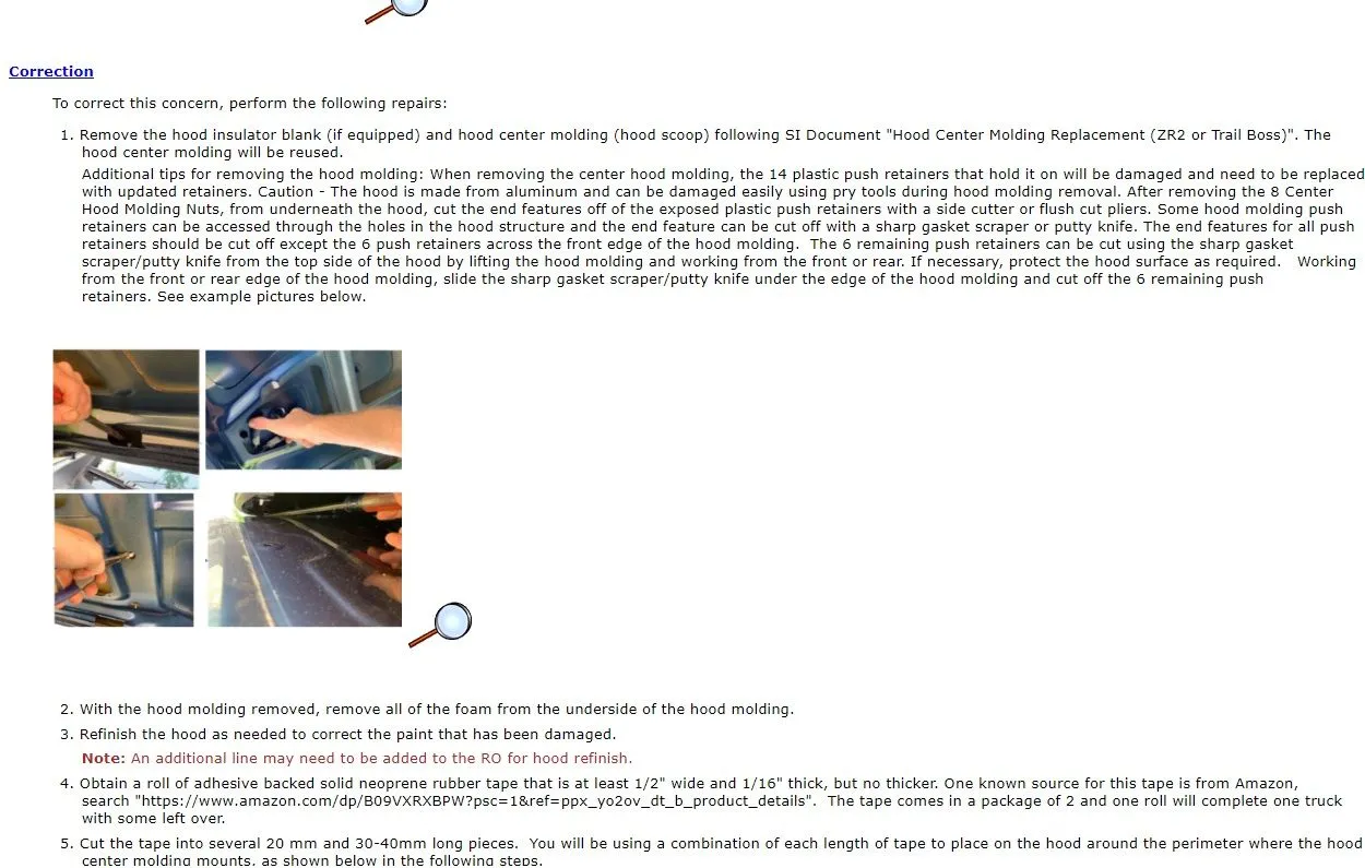

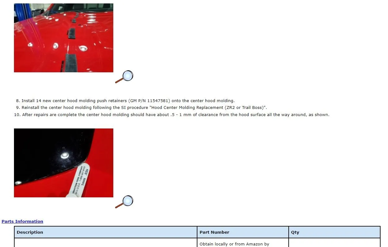

🔥 HOT Hood Paint Damage bulletin and fix is finally here

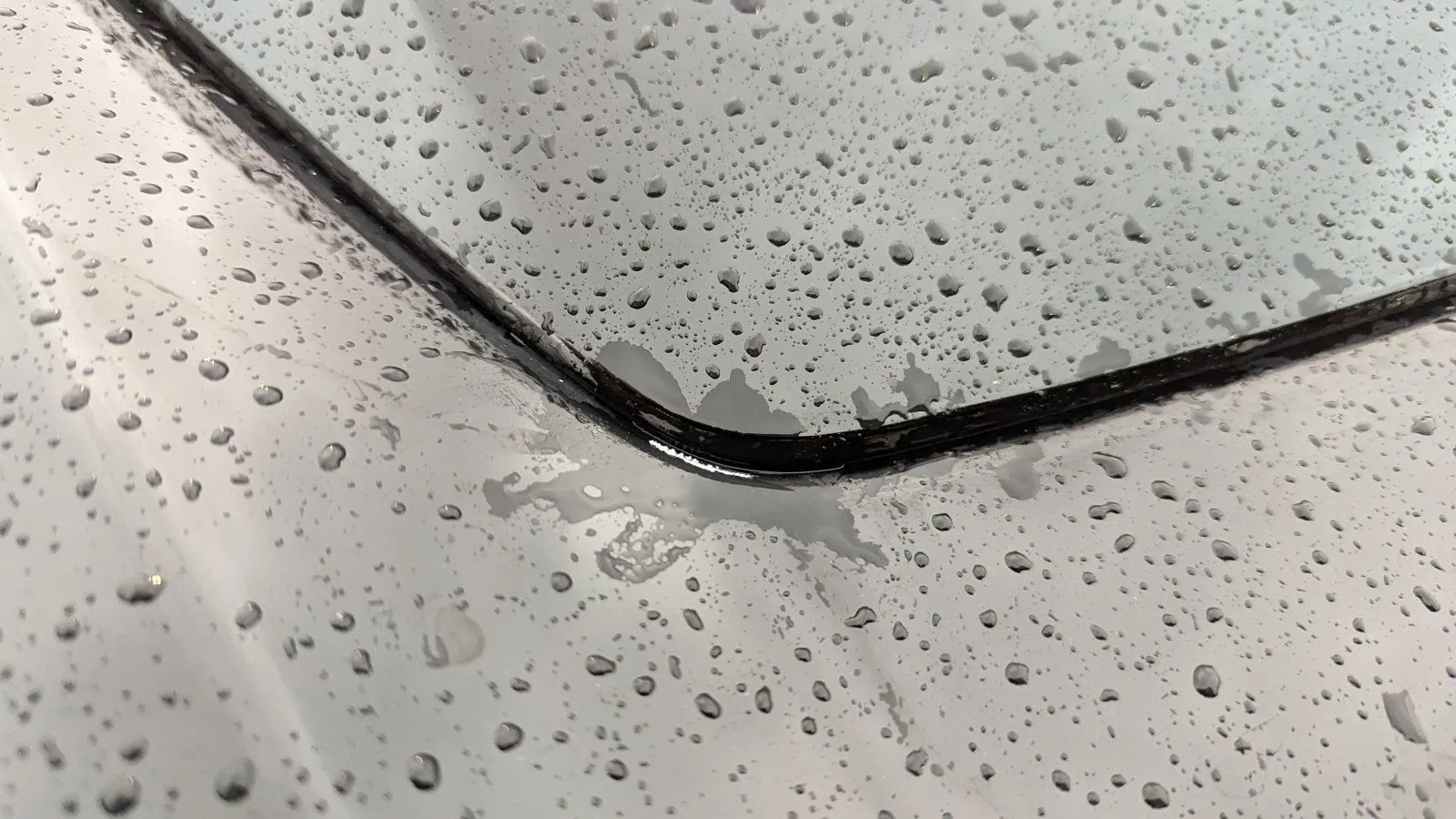

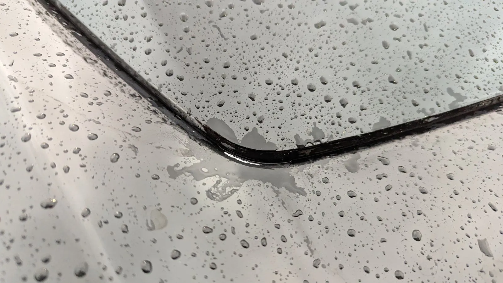

Just noticed mine today.
Btw, how much time dealership usually takes or keep truck with them to fix this issue?
I would hold off if I were you. Let GM come up with a real plan to fix it or you'll be doing it again. Yours looks like mine...not "bad" yet but, will likely get a bit worse over time. Hang tight and see what happens as we enter the Spring.

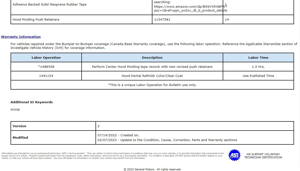

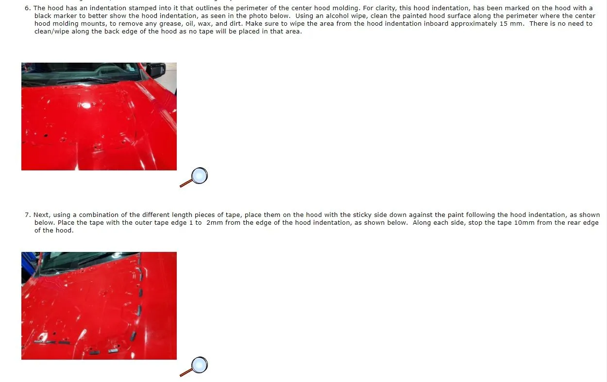

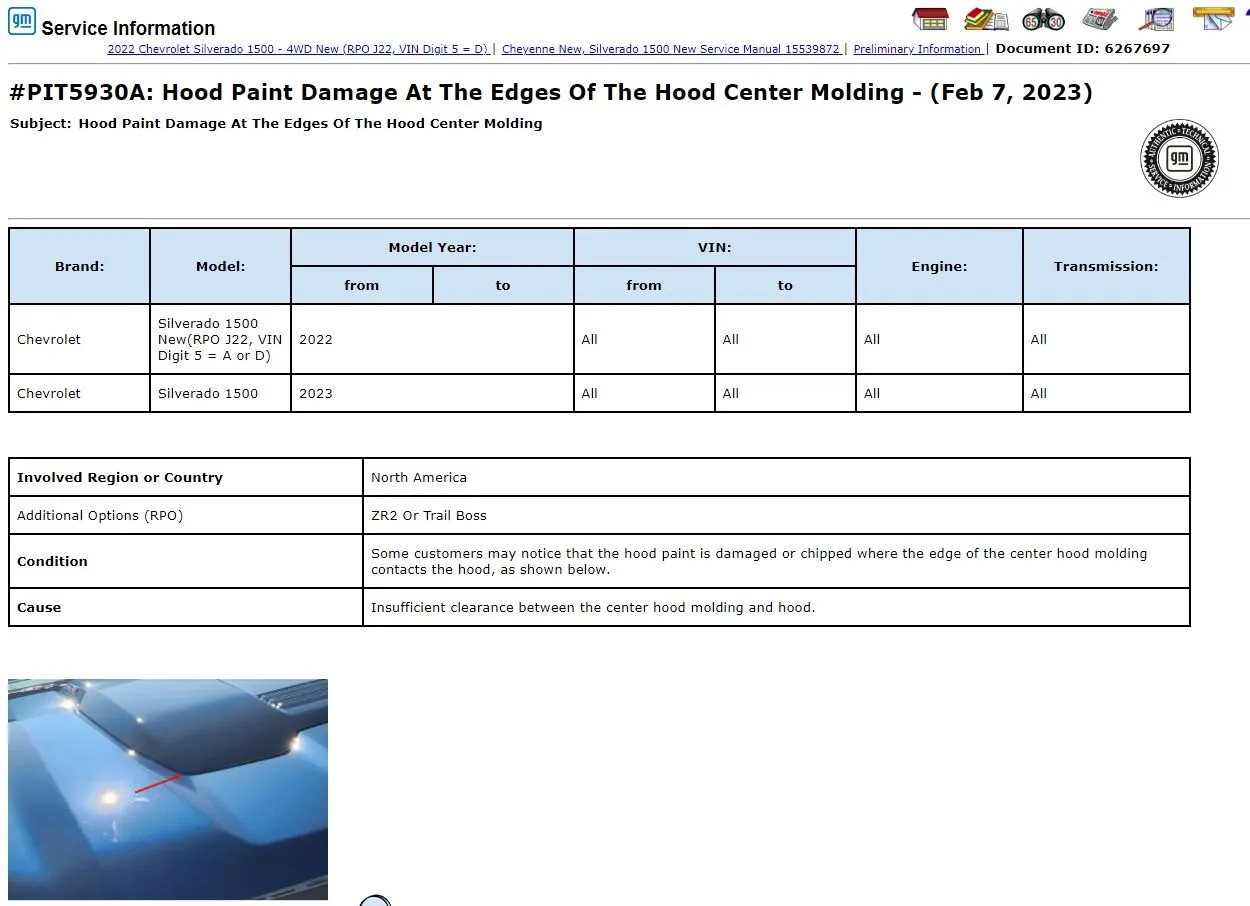

@GearheadSS My truck is currently with a Chevy dealer to fix this issue. They called me a couple of days ago and said it was finished. I am supposed to pick it up tomorrow but I stopped by to see the repair after-hours the other night and the only thing they did was add a rubber gasket around the whole scoop. The paint is still chipped underneath. I called GM and they have documented the situation, but can't seem to find this bulletin. I have told them both the PIT5930A and document #6267697. I don't think the dealership was able to find this bulletin either. Any rate, they have had my truck for 2 weeks and the only thing they did was add a gasket. Have you heard of results of repairs of this issue at your dealership?

my selling dealer had no idea either. i provided them the info from the forum. i have opted to wait on this repair because it seems a little fugazzy. the double stick tape from amazon??? they did say my hood would need a complete respray and it would take 8 days.
May be hood replacement is more efficient.

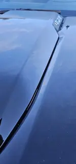

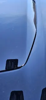

I am still dealing with this. Waiting on call from service manager at dealership and GM lead advisor. Basically I am being lied to and screwed around with them having my truck the last 3 weeks and doing nothing. Here are some pictures of the gasket I mentioned with the paint still chipped. Got another call today saying that my truck is done (again) but somehow nobody knows what exactly they "bodyshop" (aka some dudes house.... yeah, I found out its just somebody with a barn in the backyard) has done. They keep saying it is repainted, but the PPF is still on and I guarantee if i take the piece of rubber off I would still be able to see the chipped paint.
UPDATE:
Service manager called me back and said he talked to the "bodyshop" and they will now ACTUALLY repaint the hood and "follow the bulletin to a T". So, maybe after not having my truck for a whole month I will get it back and it be done correctly...
