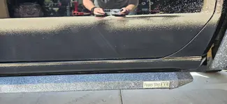

I decided to get a little bolder and hit the entire lower panel/rocker with some lacquer thinner on a 8x8 piece cotton t shirt. It dissolved the paint and came off quite easily, especially in the areas where paint was thinner. The heavier areas needed a few passes. There was a little s.eating and residual paint, so made one more pass to clean it and then buffed it with polishing compound/pad. May need to back up a step and hit it with some compound to get a better shine. It was a tad dull.
I figured I'd start with the rocker panels, as I'm probably gonna Line-X them anyway, so wasnt worried if it affected the clear. There's already plenty of rock chips showing in the textured paint.

Yeah, I did a few different tests underneath to be sure . Gonna try the acetone on another section. I think it might be slightly better. There's quite a few posts on some Reddit threads from body shop techs and they seem to know what they are talking about.
Tried a little acetone and it does dissolve the white paint a little quicker, but tends to smear and dry out quicker. Seems like the lacquer thinner is the best solution.

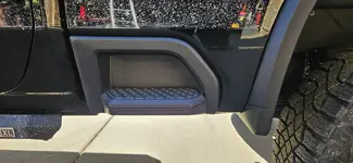

Ended up using a detailing brush and dipped it into the thinner to get the paint out of the cracks and corners, especially in that bedside step and wheel well liner. That worked well and I think it is going to work on that textured paint on the AMP steps. Did a test underneath to confirm it would not affect the paint.

3) AMP steps were fine with lacquer thinner, but used a detail brush to apply it and dissolve the white paint. The rag woukd not rub much due to the texture. Had to apply a lot of thinner and blot some with the rag.
