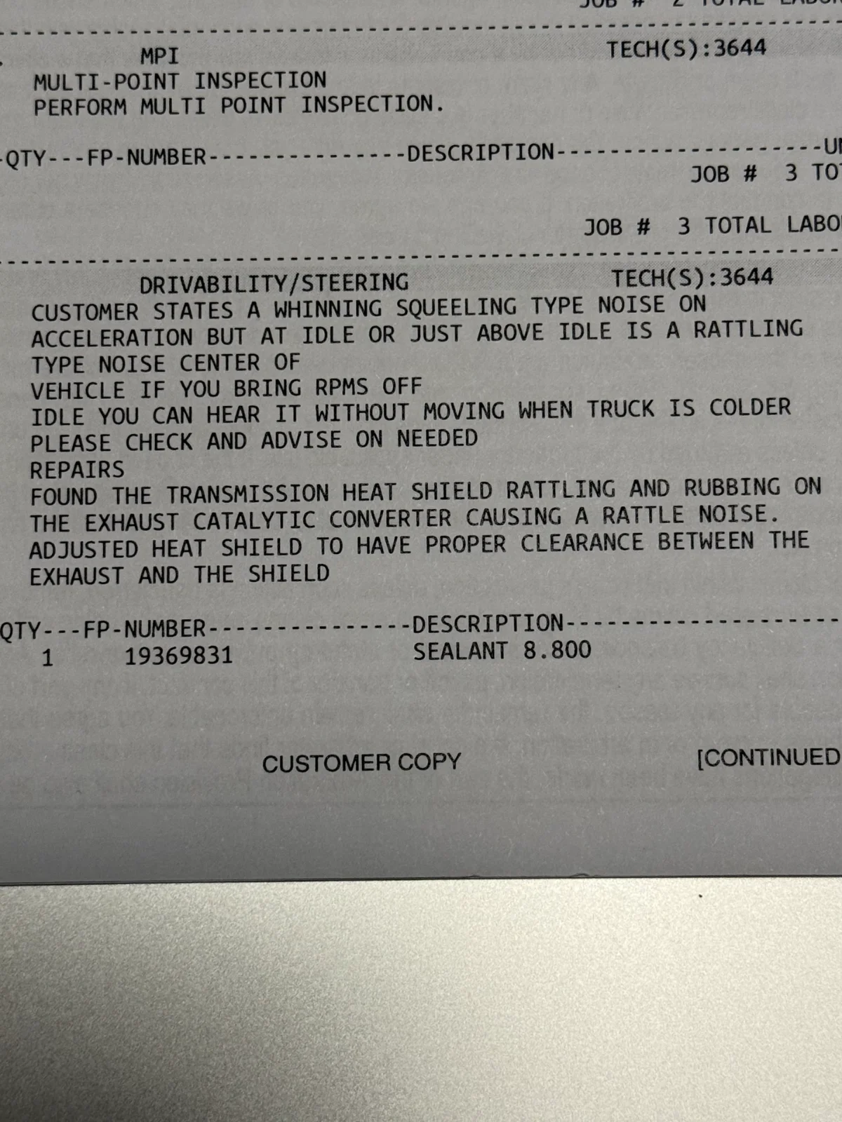

I had a rattle/ vibration like noise coming from passenger dash area. SA said it was heat shield related, SA also said he a has seen some bad exhaust clamps and a couple leaking manifolds lately. Here's a pic of paperwork of the fix.
