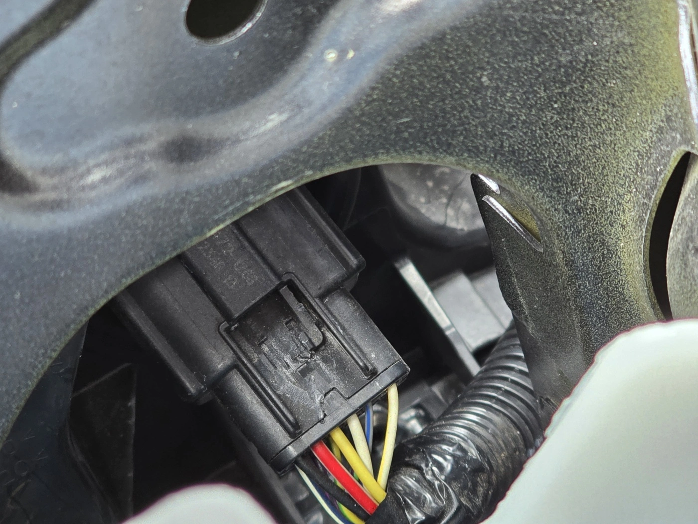

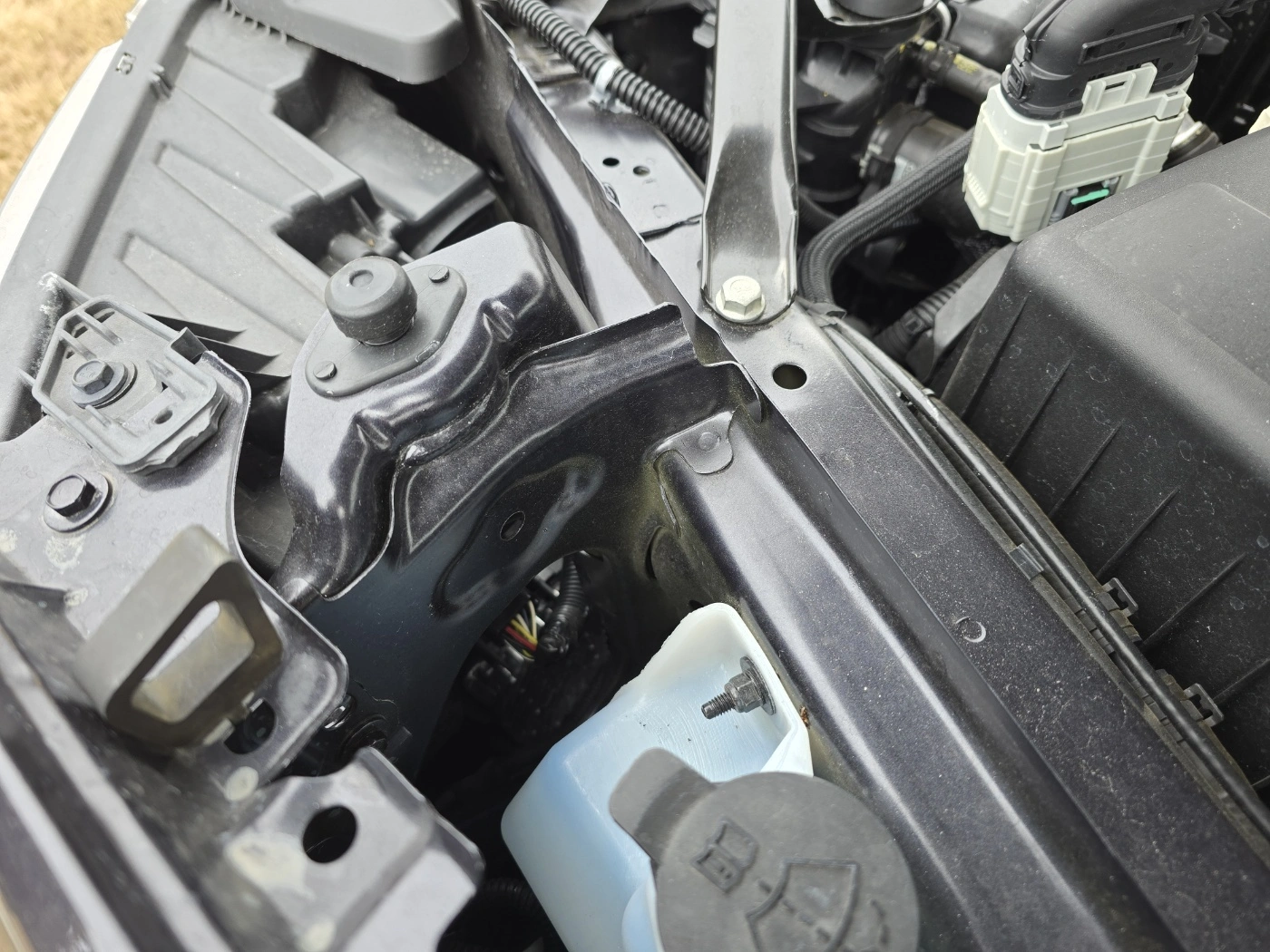

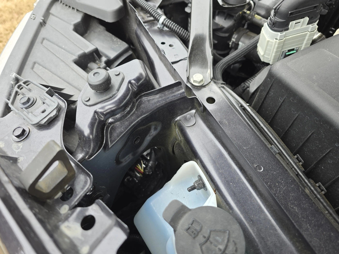

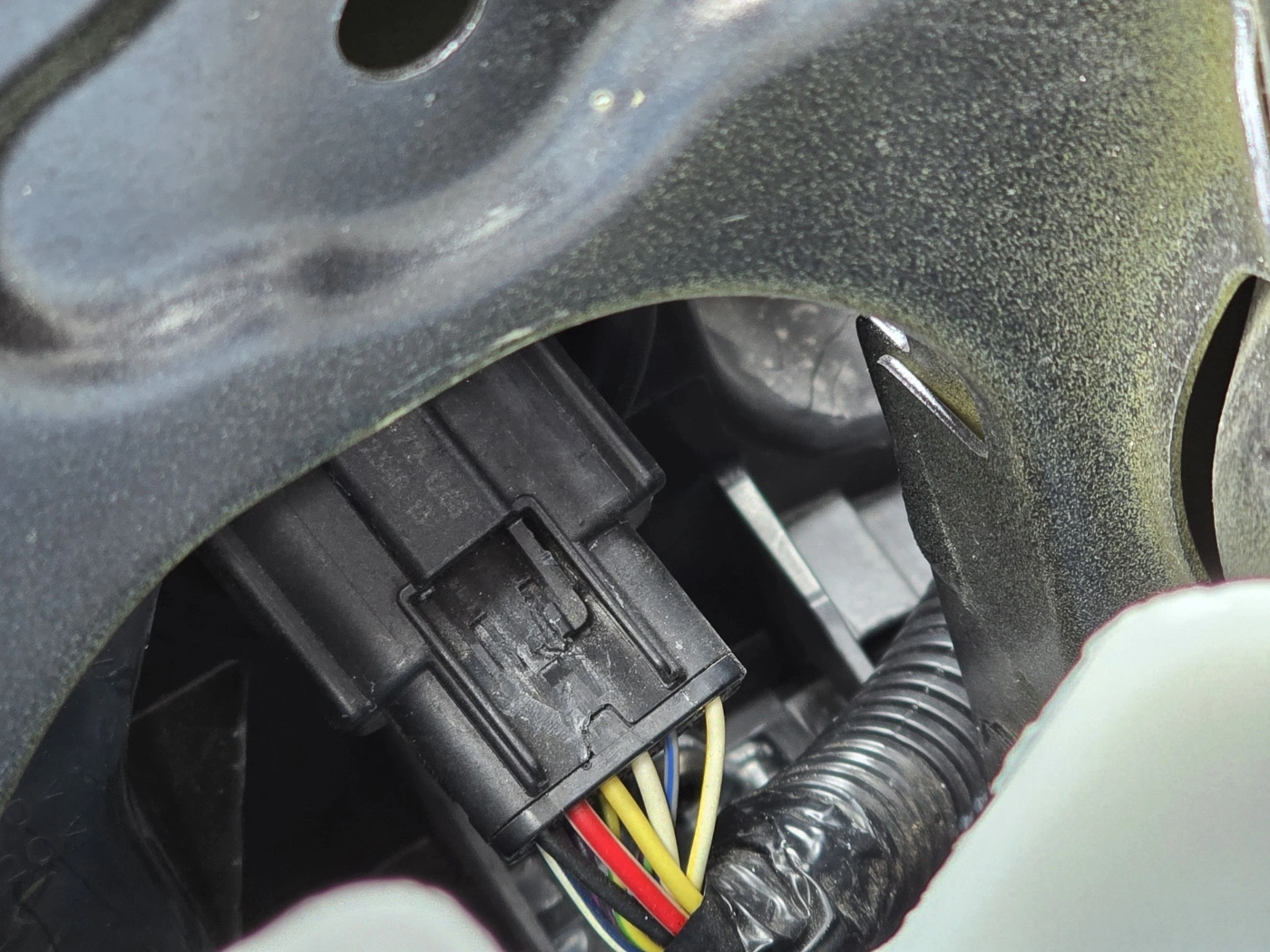

Installation was actually very tough, especially for the drivers side light. There's like 2-3 inches of space. I actually boogered up and messed up the factory connector retainer. Oh well. I'll have to tape the connector later on. I was in a hurry during lunch break.

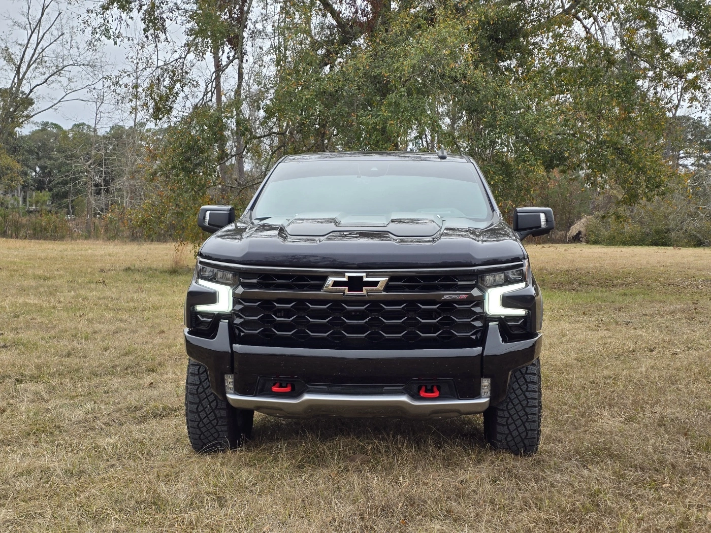

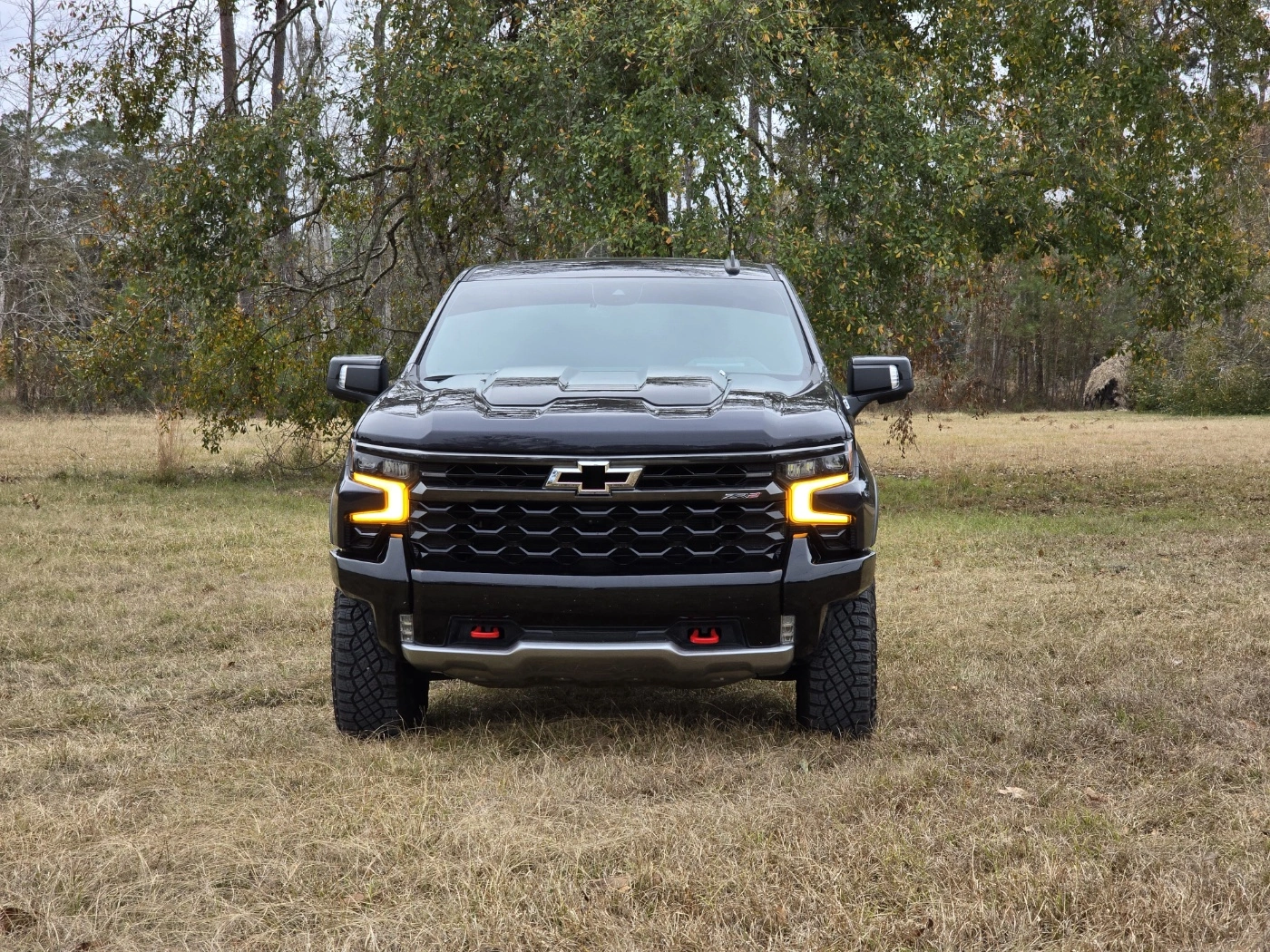

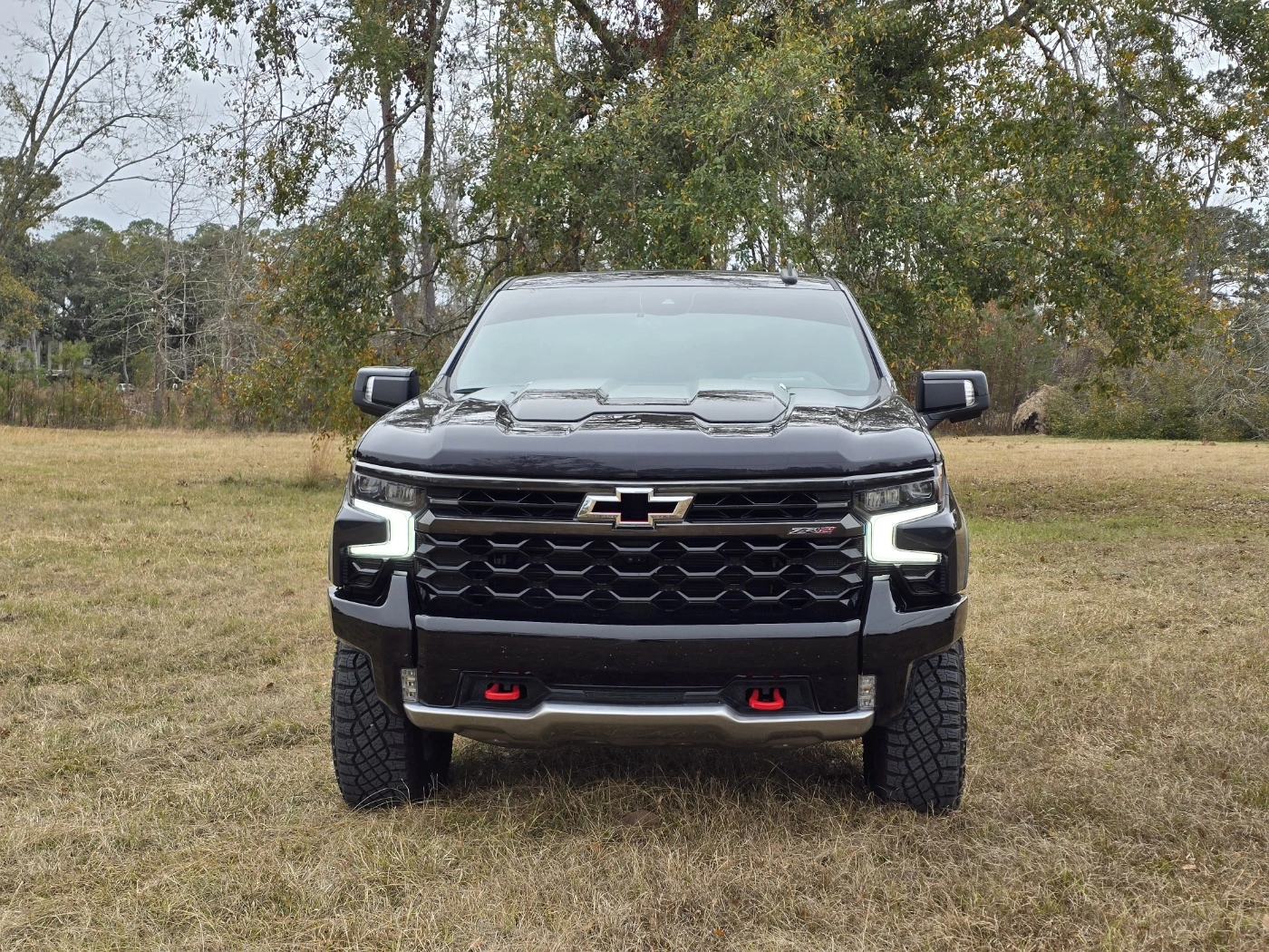

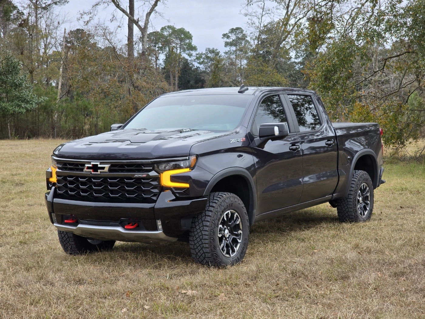

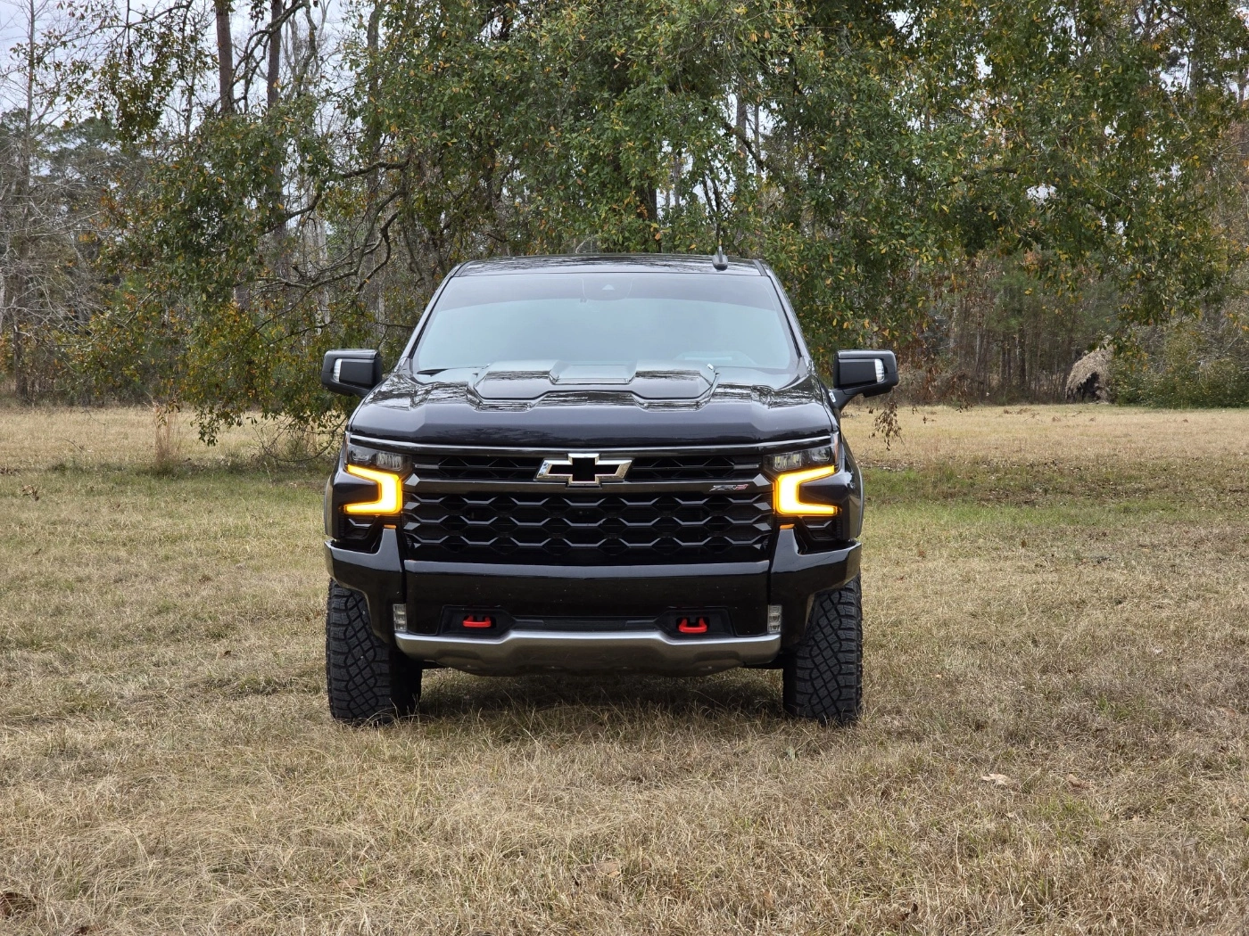

During install, I compared the difference. Amber on left, White on right.
Before:
After:

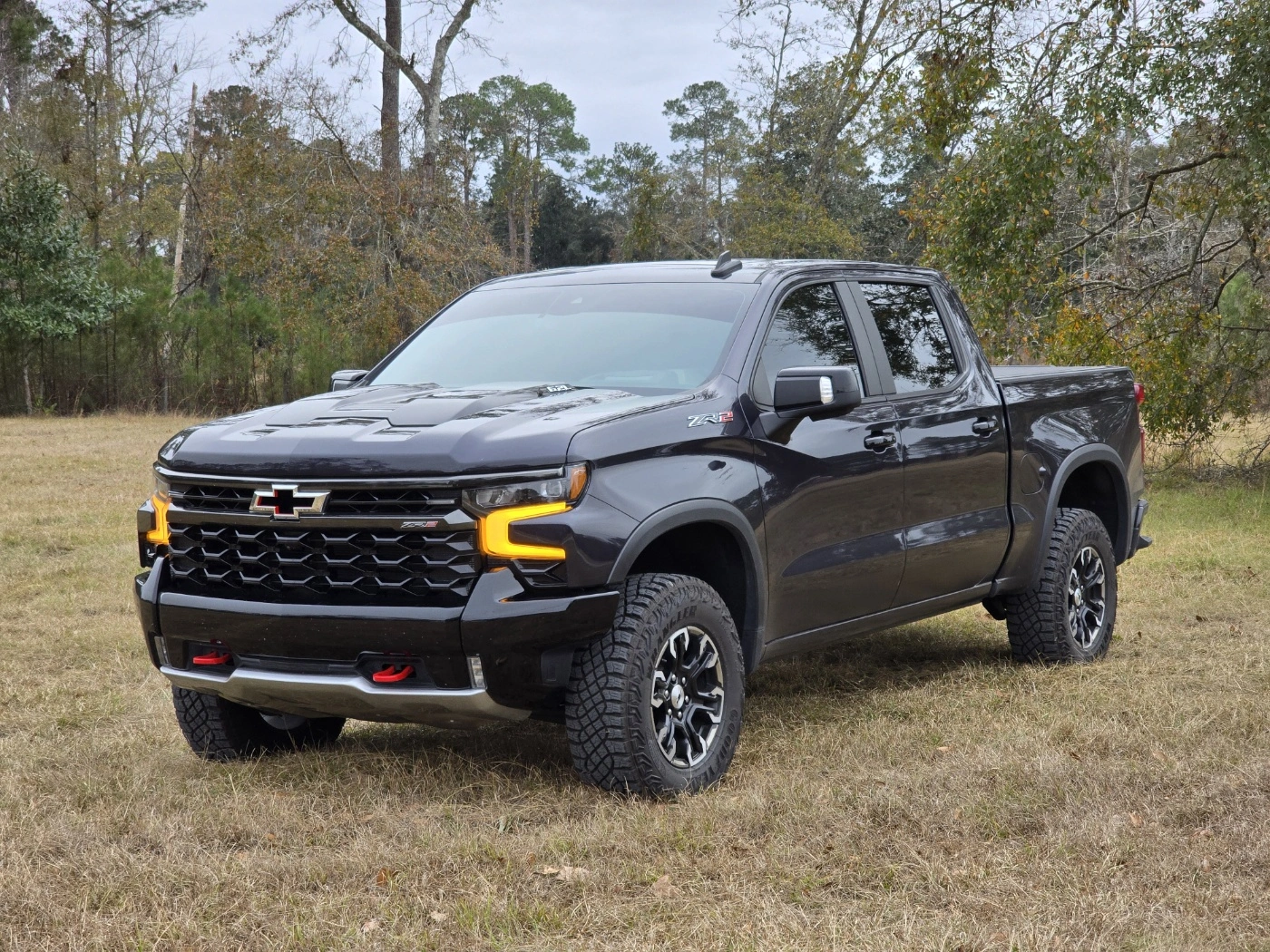

Sequential blinking does not work anymore. That greatly disappointed me.
Before:
After:
