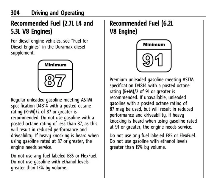

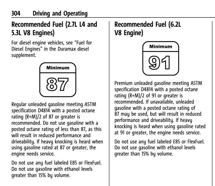

GM actually updated the 6.2L a short time ago and now recommends 91 or higher for the 6.2L, page 304 in your owner manual.

Great to know! I was relying on the internet search which clearly wasn't the latest info. Thanks!

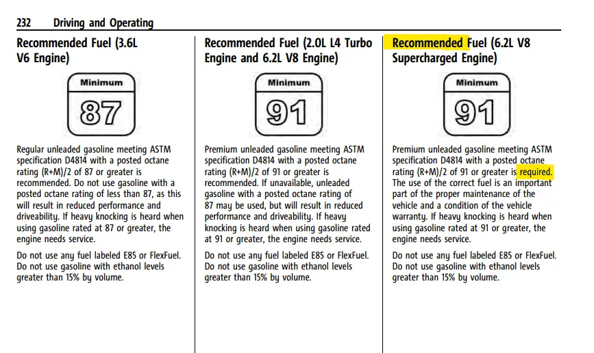

I ran my 6.2L TB with exclusively 87 and have had no issues. These things are smart enough they know what kind of fuel they are getting and adjust accordingly. The key word is “recommend”. I have another Chevy, a ZL1 Camaro, and if you look at it, premium is “required”. There is a big difference

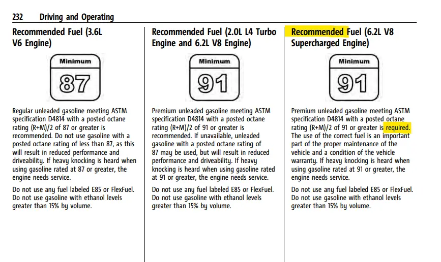

Correct, although it is a bit confusing as the header says recommended and the paragraph says required...
The supercharged LT4 requires it. The LT1 recommends it. The header is a typo.

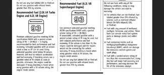

This is right out of the manual on our 21 ZL1 1LE.
