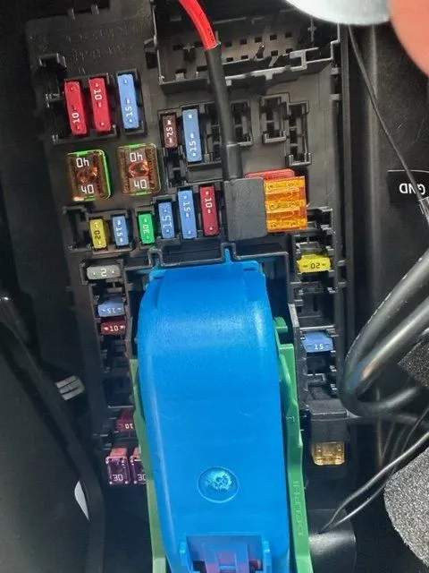

Can you show a diagram of the exact fuses you tapped for the hardwire? I'm afraid I'm going to disconnect something that's going to screw something up. I've never messed with fuses before so don't know how to wire it.
Top fuse (3 blade) is F26 and is switched power. The lower right fuse (2blade) is fuse F8 and is 12 volt constant. That is how my camera and radar detector are hard wired.
I'll send a picture tomorrow , @ZR2BIZON Has got a great photo 👍
