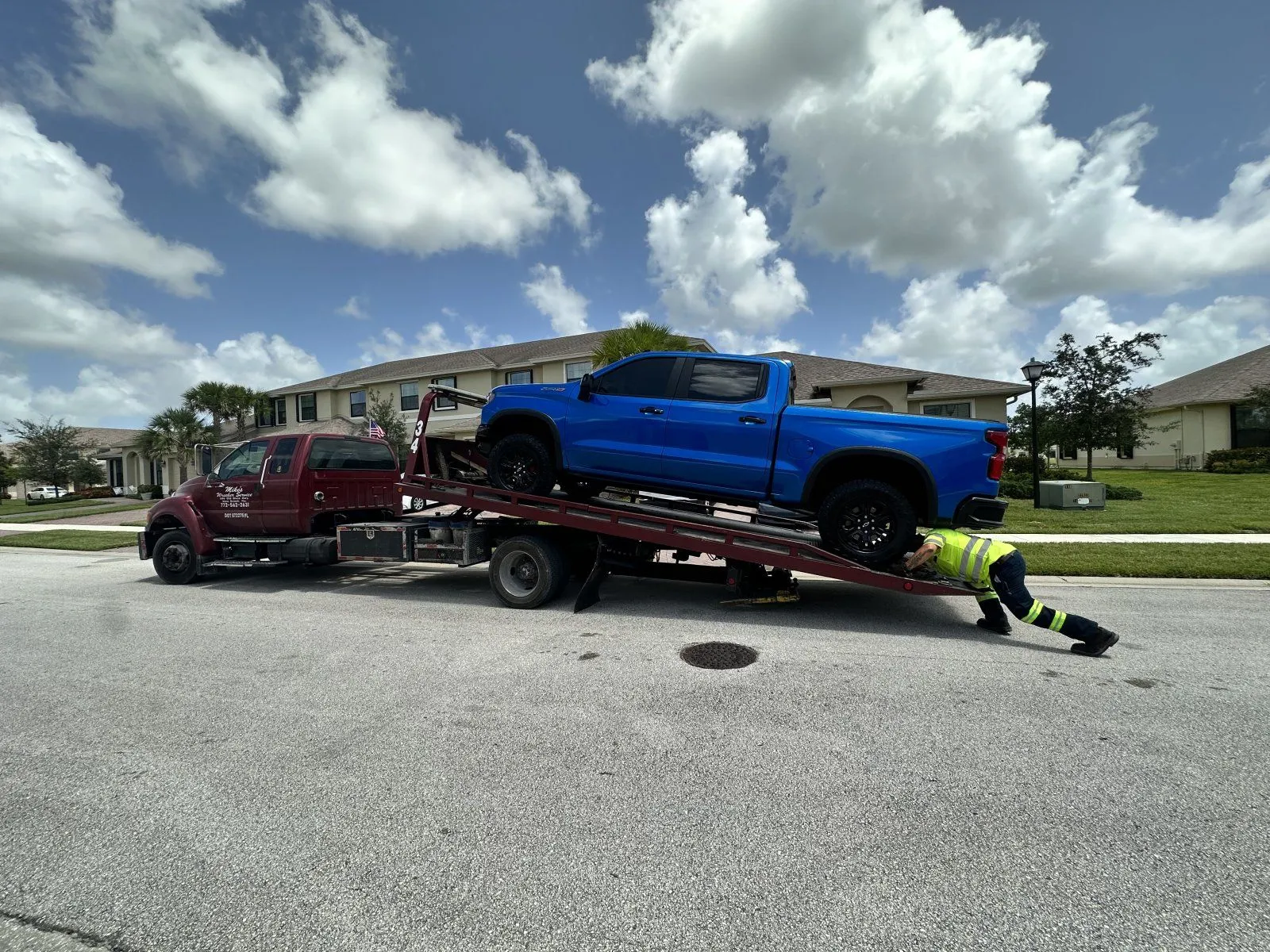

Didn’t have my scan tool. But consistent with a faulty FPDM. Truck died while running. Will crank no start.
Was able to trick it into neutral and push it. Only had to drag the ass enough with the e brake locked to pop it on the bed.
Very common issue with these trucks if my guess lands correct. Back order no ETA if I’m right. Could be awhile! 😎

So how did you trick it in to neutral? My fuel pump control module went out in 75mph San Antonio traffic. I was thankful I managed to coast to the shoulder from the fast lane.Once she stopped that was it. Tried all kinds of stuff that is in the owners manual, but nothing worked. TXDOT HEROS had to use dollies to get us off the highway shoulder to a safe location. Then roadside assistance had to use blocks of wood like skates to get the truck onto the rollback wrecker. Totally unsat not to have a way to override the electronics to put it in neutral. My 2014 RAM RT had a red nylon piece near the fuse box to put it in neutral, why can't Chevy do the same?

When I called the dealer to prep them for a cinderblock (non drive) I told them that it was probably the FPDM. I called the parts department before service and ran the locator. The parts guy informed me a dealer across the state had one but they didn’t buy from that dealership.
The dealership world, for those who don’t know, is closer to the mafia family mentality then you realize. So that’s the major source of parts run around.
But I wasn’t worried as I work in the industry and we do buy from Autonation.
Once I got the phone call of “yep you’re right and backorder no ETA” I said okay no problem. I’ll get it myself.
76.67 my cost (which I have to eat as GM won’t reimburse me) and I’ll have it lunch time tomorrow. I’ll pay the 80 bucks and move on with my life. Don’t care to have my shit sit for an undetermined amount of time getting F-ed with fallout.
@The_Q as far as how I tricked the truck, after a unsuccessful dry start the second time I was able to get enough fuel pressure for the engine to fire for a split second. Rammed it into Drive and then bumped it to N once it died.
Be warned. If you open the door, it will Auto Park.
