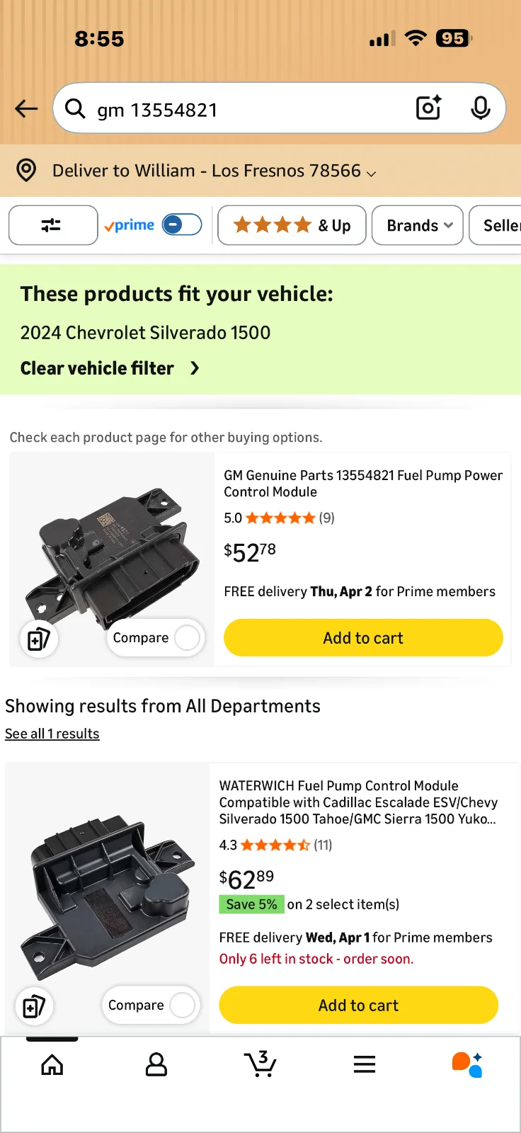

13554821 was the part number for my 2022 6.2L, and I am keeping one for a spare, just in case!
Does anyone have a good link to purchase a spare? Also is prgramming required or can you plug in the new one and let it ride? Looking to get a spare just in case.
Amazon! I too carry a spare. My 2022 left us stranded twice, more than 4.5 hours from home. When I bought the 2024, I bought a spare module just in case.
