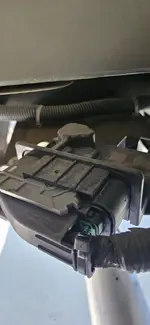

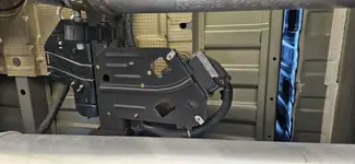

Located right below the center of the front of truck box. Between fuel tank and drive shaft. Right next to exhaust, so it would take some cool down time to make a roadside repair. Also the bolts are upside down, so would be hard to get out laying on your back unless you can get your hand up over top. Alligator arms need not apply.
Yup that’s the bastard itself. Actually controls much more then the pump itself. Pretty much the brain of the EVAP system amongst others.
Seems like it could have been mounted off the front side of the tank, which is where looked first. Maybe even behind that protective plate. It would be easy to do in a lift.
Directly off the box
perfect..thanks.
