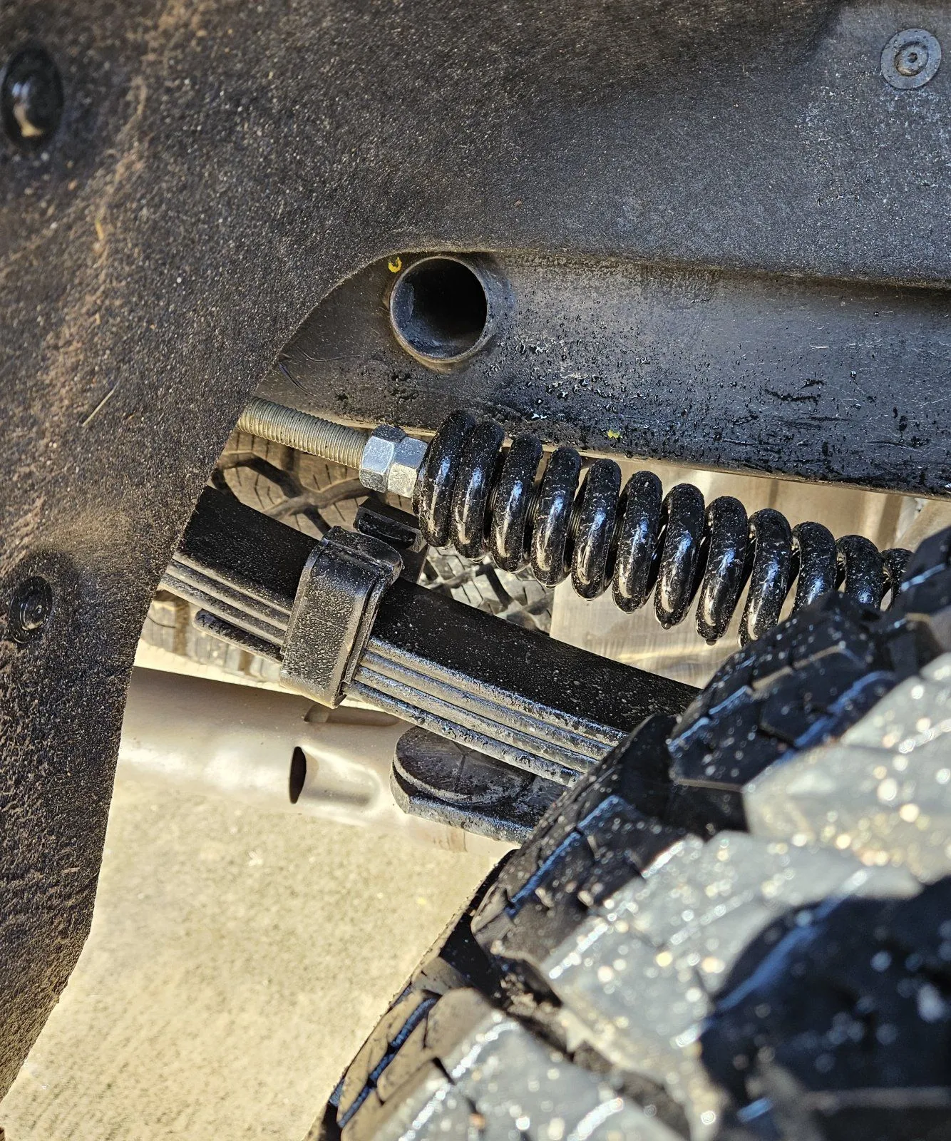

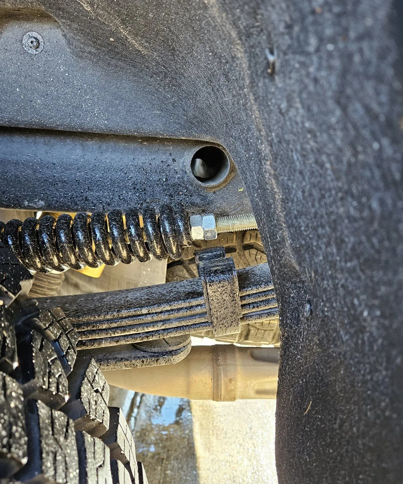

R.A.S Road active suspension. These really work like described. A must have for me. I pull a trailer every day View attachment 10509View attachment 10508
Sorry for the reply to an old thread, did you order a special version of this for the ZR2? I just got the Chevrolet 1500 Silverado 1990 - 2024 | HD Kit and its too short to fit on my 2023 ZR2. I asked them in a chat and they said it would fit, did you have any issues?

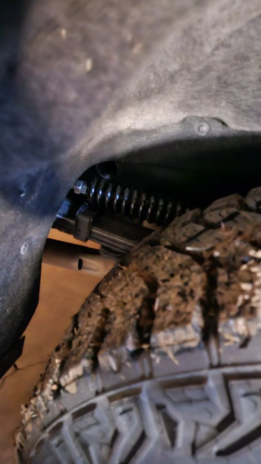

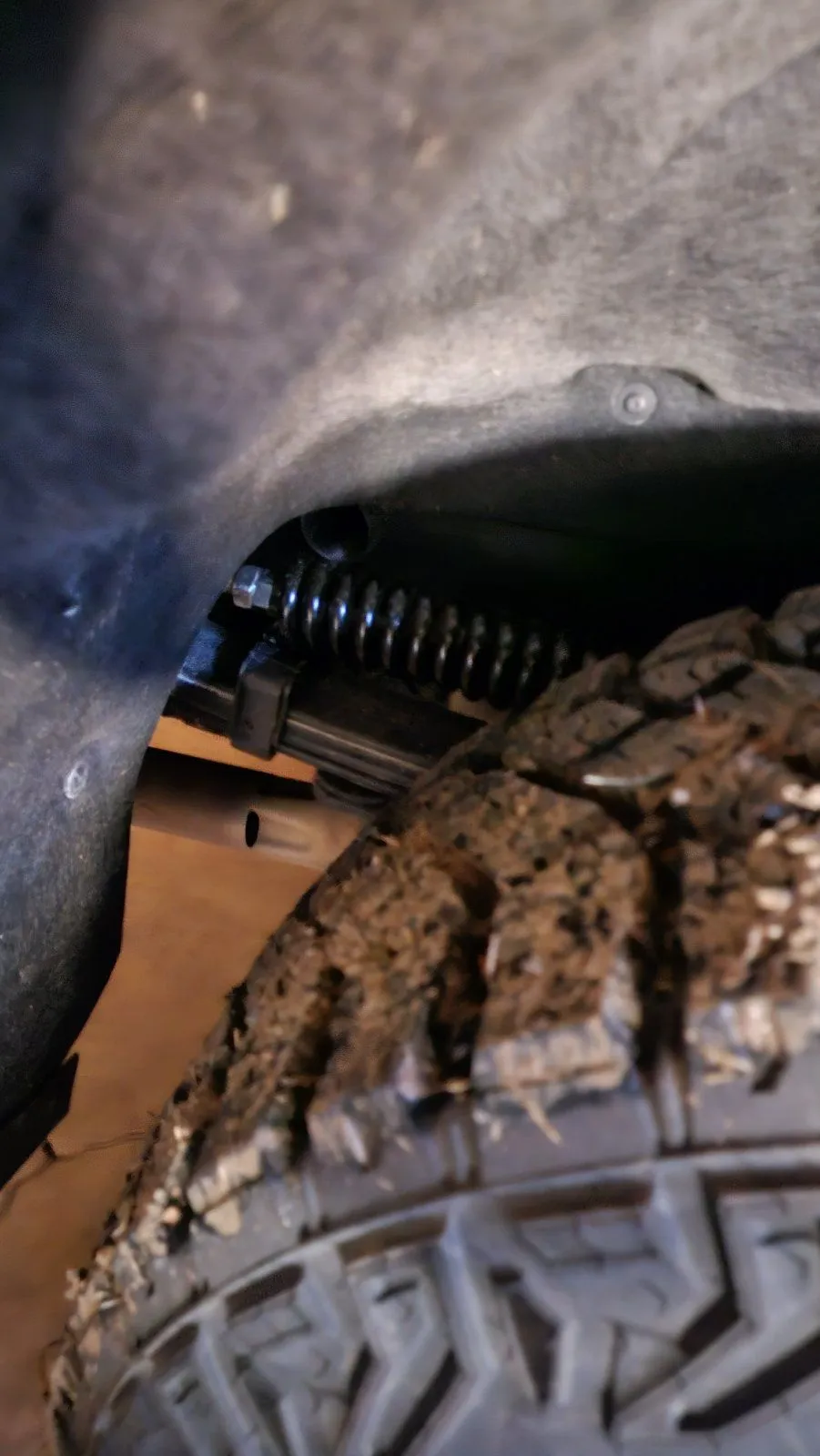

I did have a problem with mine , but it wasnt to short. The actual coil spring on the R.A.S was hitting on the keeper of the leaf springs. I called them and they sent me a different version. On the new one the adjusting bolt was shorter so it made the spring not hit keeper. If your truck is the same as mine you will need front adjustable bar in the second hole back. Then just barley start all thread. Maybe just a couple of threads. I hope this all makes sense.20240128_161634.webp

I did have a problem with mine , but it wasnt to short. The actual coil spring on the R.A.S was hitting on the keeper of the leaf springs. I called them and they sent me a different version. On the new one the adjusting bolt was shorter so it made the spring not hit keeper. If your truck is the same as mine you will need front adjustable bar in the second hole back. Then just barley start all thread. Maybe just a couple of threads. I hope this all makes sense.View attachment 11242
I appreciate your reply. I actually just watched another video from etrailer and they showed how to increase the length, I guess they come short to fit in the box. I am gonna try again tomorrow if weather permits. Not having a garage sucks lol
How do you like it by the way now that its on and running? do you pull anything?

They work great. Not as much squat. And make pulling my trailer a much better ride. I pull a 6000 to 8000lb trailer. Plus I have about 500lbs of tools in the bed. When you install these try to move the front adjustable pin to the 4th hole back from the end. Even if there are just a couple threads to start the all thread. When you start to tighten you will gain alot more threads on all thread. If I had done this I might have been able to make my first set work. You just don't want that coil spring to hit leaf spring keeper. When you start putting together this will make more sense. There instructions leave out some of this
info.
info.
One more thing. I tightened mine to the max. Both white and black disc together was my gap. They said this was max I could go.

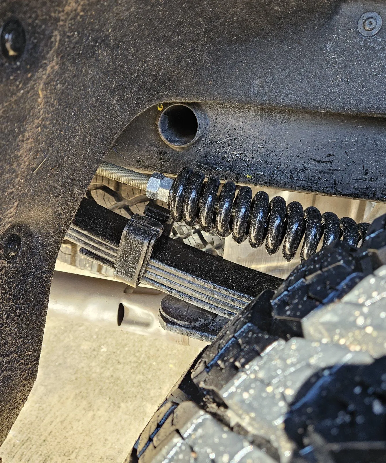

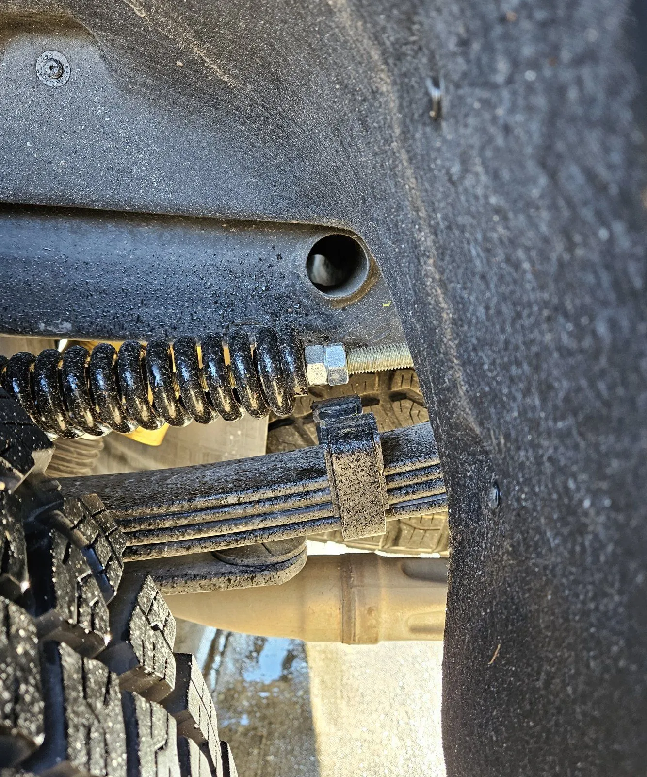

I got it on in the third hole, the bracket itself was too small to fit the fourth hole. I took it for a test drive and didn’t hear it hitting anything going down bumpy dirt roads. Looking forward to testing out the camper later this summer. Appreciate your feedback!
