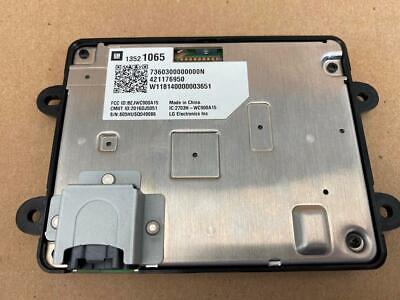

Interesting!So I drove my truck today finally and was playing around with the wireless charger. I pulled the rubber insert out and found a vent blows cool air over the module while your HVAC is on. On the back side of the rubber insert are small channels that allows the air to blow up and over the wireless module. The channels stand the rubber insert off the wireless module maybe 1 to 2mm. If I remove the rubber insert my phone charges fine on fast charge. With the rubber insert in, if I push down on my phone slightly, closing the distance between the phone and module, my phone charges fine as well.
So a guy could pull the insert, or try to cut the channels down and reduce the distance. Also could shim the module if thats even possible.
