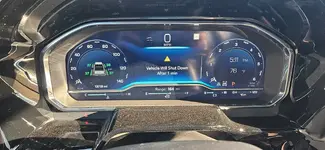

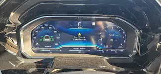

So the sequence to make this work is really important. If you start your vehicle, put it in drive, and drive it with the key fob in the vehicle everything is normal. If someone exits the vehicle with the key fob (say you switch drivers), the vehicle can still be driven without issue, but you'll get a message in the DIC. When you get to your destination, place the vehicle in park and press the start/stop button the vehicle will shut off. Another message will appear in the DIC and you get one more start without the key fob. Presumably a safety factor so you can get back to your key fob. As far as I know, you could be 1 mile or 100 miles away from the key fob.
However, you must depress the brake pedal and then press the start/stop button to restart. If you just press the start/stop button or open the drivers door, the vehicle resets and is dead in the water. You also heve one minute to restart or vehicle resets.
Here's the pictures! Seeing is believing!

Well, I'm not "most people."
Yes, you are correct, but that's not what the OP was asking. He stated that he didn't have the key fob at all and wanted to start the truck with his phone and drive it. That is what I said is not possible.
Read, my friend, and you will understand.
