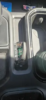

So to close this out, I did a couple more tests to see what options will work to get you moving if you're separated from your key fob.
I was able to 100% confirm that a spare fob without the battery stored in the cab of the vehicle will work if you place it in the transmitter pocket as shown in the manual (see attached picture) for validation. I used the My Chevy app to pre-start the truck and open the door. Then tried starting with the key fob in hand and on arm rest and it wouldn't start (so its secure, so long as someone doesn't find it). As soon as it was placed in the transmitter pocket it started normally.
So this would give you an option for those that may travel away from home a lot or those out in the boonies camping, off roading, fishing, or hunting. May want to consider leaving the fob inside and attaching the door key to an electrical line or some other secure space under vehicle so you can unlock the door. Of course you could always just bring a spare key fob along, but oftentimes you forget that when you're packing and loading and then it's too late.
Anyway, hope this helps and gets you out of a jamb.
