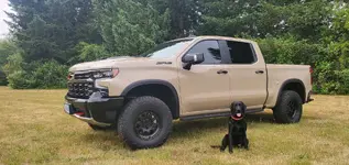

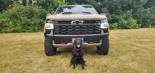

17x8.5" Icon wheels with 0 offset
35×12.50 Toyo Open Country Rt Trails
Just sidewall sticks out slightly! Need to put on big boy pants though, and trim the front bumper exactly like Axe did in his thread. Trimmed mine over the weekend and it's awesome to have a 35 and no rub at all at full lock! Thanks again for the great trimming info and pics, Axe. 👍
Looks great!
To clarify, you were running this setup with no suspension mods and minimal trimming?

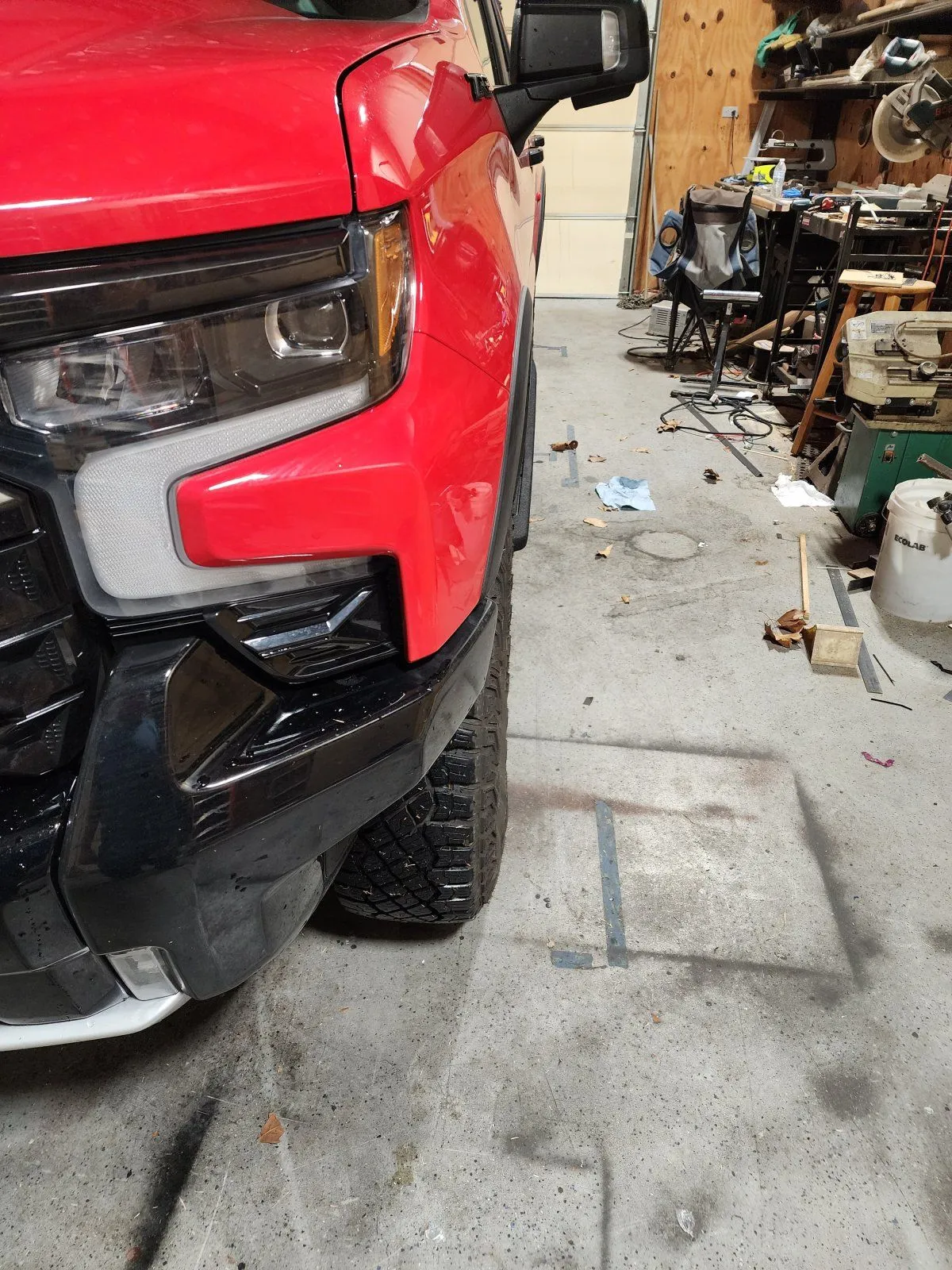

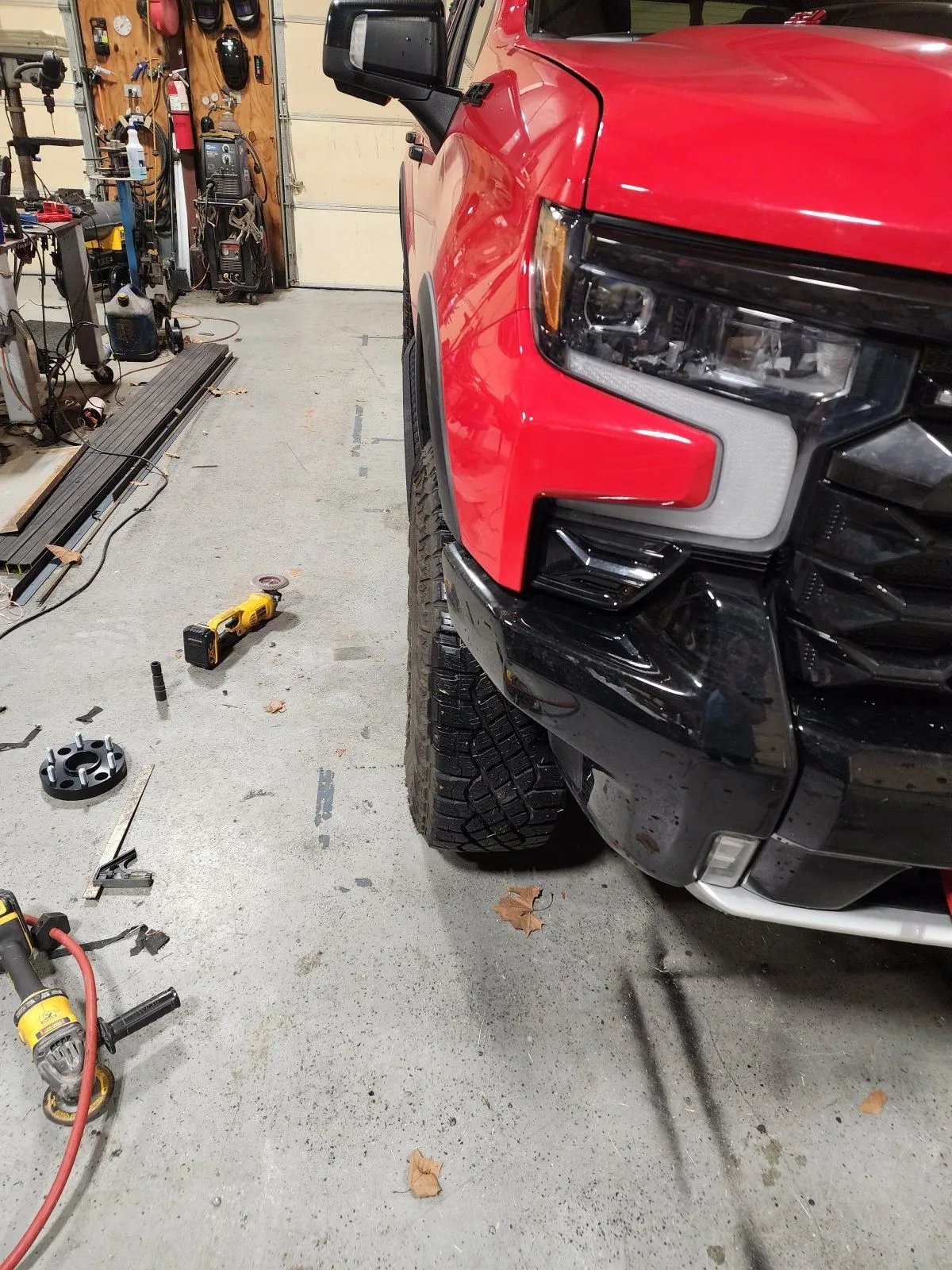

I can show you what 1.25" spacers do on stock tires and wheels. Perfect amount IMO. Sits flush with the side steps and the upper fender. In the pictures front passenger side is with spacers and front driver side is stock.
View attachment 7378View attachment 7379
Wow! Makes a huge difference.
Since the spacer is the only modification here, I'm curious - do you get any tire rub at full lock?
What brand spacers did you go with? This is the look that I am going for as well. Maybe upsize the tires to 285-295 as well.

The bottom line IMHO is if you go over a 34" inch tire with or without a level kit of any configuration, you will need to trim or shim out your bumper if you want absolutely no rubbing! If you trim it, you'll get a 35 on with a 0 offset 8.5" wheel with ease. Full lock, both directions, up driveways.... no worries no rubbing. You can trim without anyone even picking up what you did!

That edging looks pretty clean. I used paint on mine, but you can see the tape edge a little if you look close.
Most of my hard rubbing was in the back of the wheel well on the protective plastic edge. Trimming that is necessary for anything over 34 inches.
