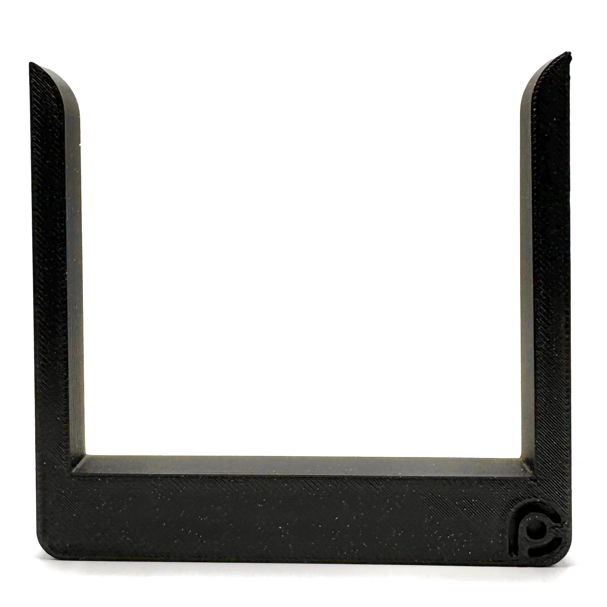

Hello, I used to have the same problem. I found the solution by putting a piece that serves as a riser on the wireless charger.
Finally I found this and I bought it:
You can do a test before you buy it by putting a piece that serves as a spacer of at least 1 inch you can use foam, wood, plastic but don't use metal.
I bought this from PCB Techart. Works well. Just need to put some double sided tape on it, as it knock it out sometimes.
I have a piece of foam wedged in there, but even with that, I will get the orange icon. I slide the phone out about an inch, then put it back in. Usually between three or four times cycling it when it turns orange and then it'll stay green. Not ideal, but this is what's working for me... I notice the issue much more often when my battery is below 50%.

I got one of those 3D printed spacers and it fixed 95% of the issues I was having. Non maxx sized iPhone user here. This version has parts that go on the sides and keep the phone situated correctly.
