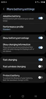

You change it in the phone setting under battery and device care. Click on battery and then click more battery settings and then uncheck fast wireless charging and it will charge normally on the pad without turning on and off on and off.
Axe look at the above reply to the other fella and the pictures I posted. That second picture is what the settings look like in our phones
Found it thanks. I thought fast charging was all about the charger and phone just played along.
