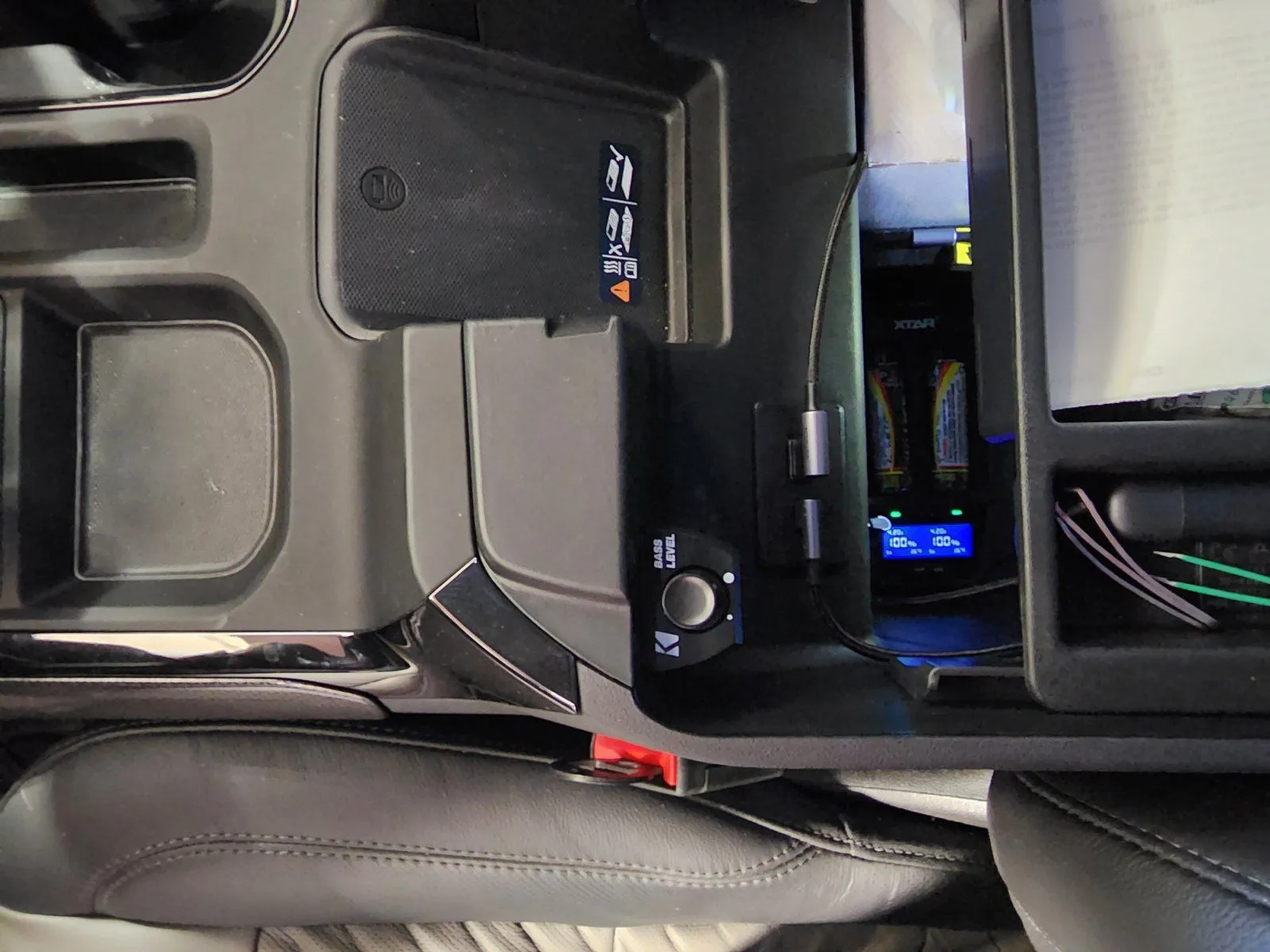

I mounted my knob in the center console. The wire runs up the side under the plastic kick panels. Under the seat and up into the center console. The carpet under the seat isn't one piece. You can pull it back and just fish the wire though. I just slid the seat back all the way to give me room to work. The plastic kick panels just pop up and are held with clips. This just seemed like a good spot for it. I didn't really want it on the dash. It's not like you constantly are adjusting it. Mine sits on about 3/4 most of the time. But it's nice to be able to turn it up or down a little depending on the music and your mood. This sub will vibrate the mirrors with it turned up.

If you have a local stereo shop "not the dealer " you could always check with them on adding the knob and adjusting the amp. If it's something your not comfortable doing. I get it. It's an expensive truck. If I had never pulled a dash apart or messed with running wires, I'm not sure I'd be comfortable starting on a ZR2 lol. But really the knob isn't bad. It plugs in like headphones with a 2.5mm jack on both ends. You can mount it anywhere with some double sided tape. I did drill a hole for the wire to mount mine where I did though. But you just stick it on the bottom of the dash if you wanted.View attachment 885

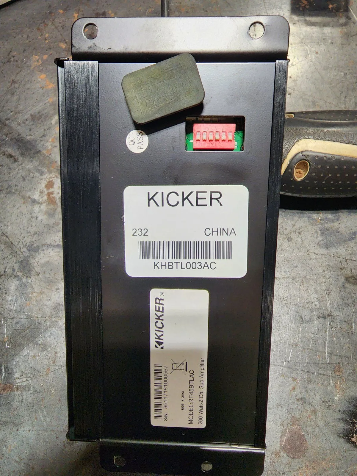

Thank you so much for this - installed last night and bought the knob. Only thing... where are these DIP switches? I took off the amp with the 4 screws but it's just a box basically. Unless I got the wrong 4 screws.Spend the 40 bucks and buy the knob. KICKER 46CXARCT on Amazon is the knob.

No problem! There is a rubber plug that covers them. It just pops out. HTHThank you so much for this - installed last night and bought the knob. Only thing... where are these DIP switches? I took off the amp with the 4 screws but it's just a box basically. Unless I got the wrong 4 screws.
Lol go figure the one place I didn’t look!No problem! There is a rubber plug that covers them. It just pops out. HTH
