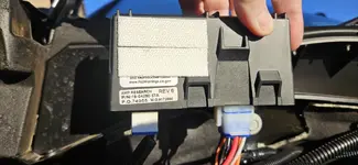

What part number is on the back of the computer? This is the computer part number for the 24 2500 HD AMP XL steps 77255-01A. That would likely be the part they changed if they updated something.
Gotcha.. At work still slaving away. Can verify asap.. Thanks
