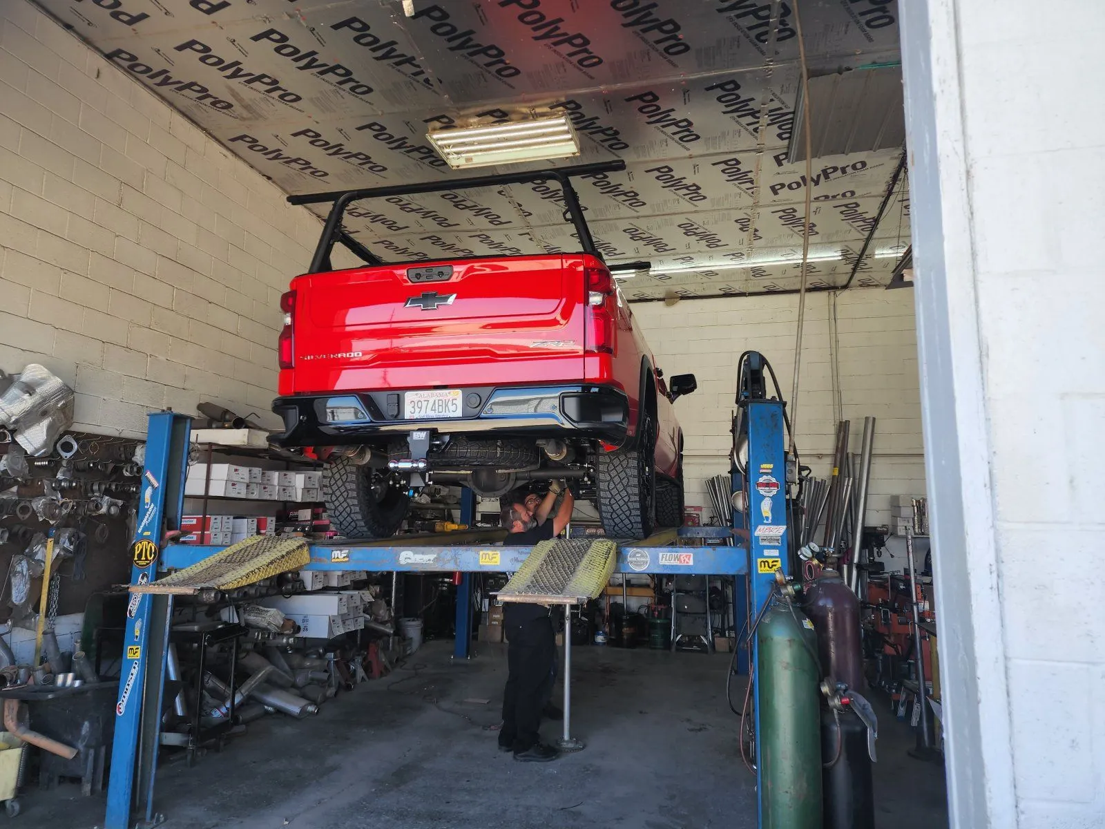

Look what just came today :D
I have that same one on mine. Had it put on the day after I bought the truck and I'm over 7k miles now. I left everything in but the flapper. I'm very happy with it. Paid a welding shop 100 bucks weld it in. They cut the old muffler and flapper out. Added some pipe and welded it all in. I'd say go for it. Replacing everything with a clamp together cat back for 1800 on a new truck seems silly to me.
Totally agree with you. I'm taking her in next week to have the OEM muffler and flapper cut-out and the ATAK installed. $80 out the door all welded in place. Totally investment is under $360 :)
