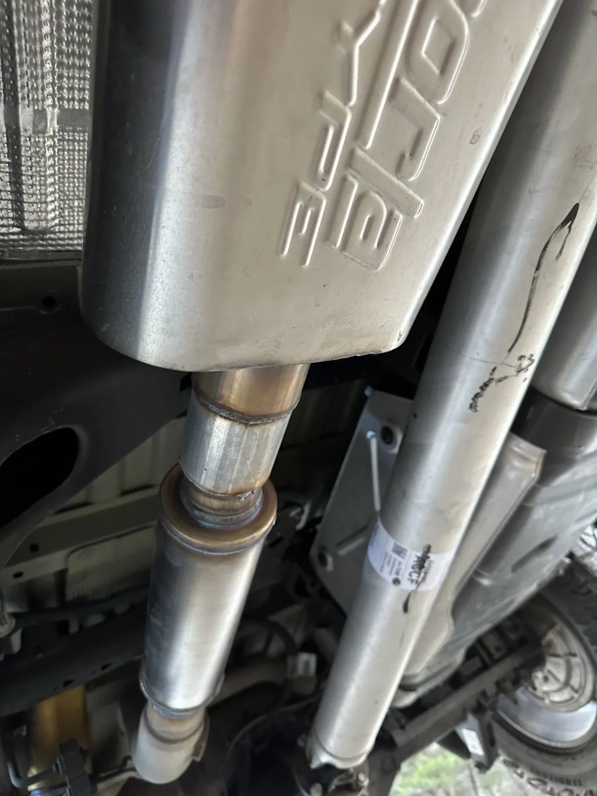

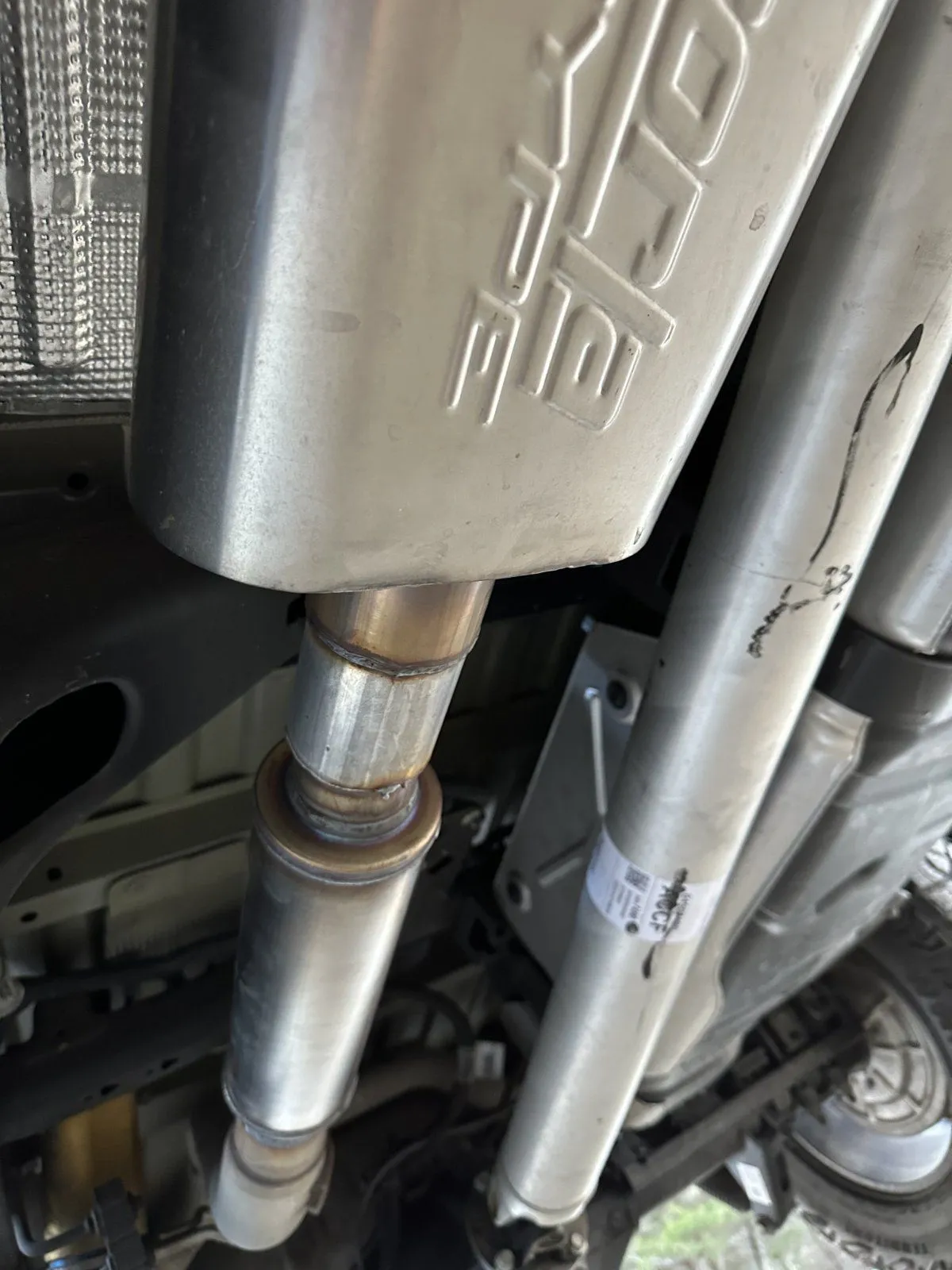

Can you take a pic of it under the truck so I can see its size and where they tied it in? Thanks
Toned down a bit but still has some growl, a nice in between for the wife and me. I just realized I didn’t even ask them the brand, it was something they stocked, $120 all in cost.

Put a Borla 400844 on this month.
