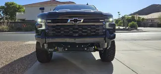

Any thoughts on how I can make this RC Hidden Winch/Bumper work on the ZR2? I'm not a welder, but want to repurpose my investment as much as possible. Had it on the 20' Black Widow for a week before it was totaled by the insurance company.
This front clip is really complicated with many different pieces and attachment points.

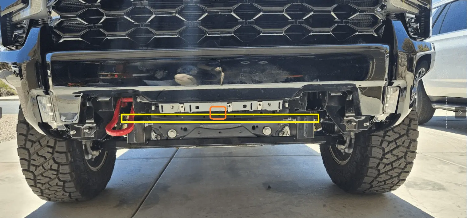

Is there something behind the bumper to mount a piece of tubing as a receiver? Then pop a hole behind your license plate and that would be access for a receiver mounted winch that you could slide in when needed. And could use the winch in the rear receiver when needed. That kinda what im going to look. I might have to weld some brackets behind there maybe if there is nothing solid.

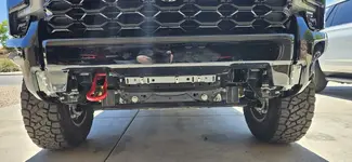

Not sure this helps, but here's what it looks like underneath with the front fascia removed. I did this to Line-x the gray fascia below bumper.
You can see the frame mounts for the tow hooks. Pretty sure you could mount something there and make it stout. but then you have to cut bumper or fascia to get it out front where it's accessible.
Just pulling that fascia was a project. Might be better to pull the front clip off truck in one piece of your doing some serious fab work.

Could mount a bar in there under the tow hook brackets and then weld a receiver to it so it lines up with license plate maybe like this. But I totally forgot about the skid plate, so this idea wont work anyway. There no way to get underneath and pin the winch into the receiver. Oh well. I guess an integrated bumper like on the AEV might be the only option.
