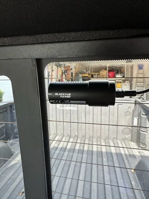

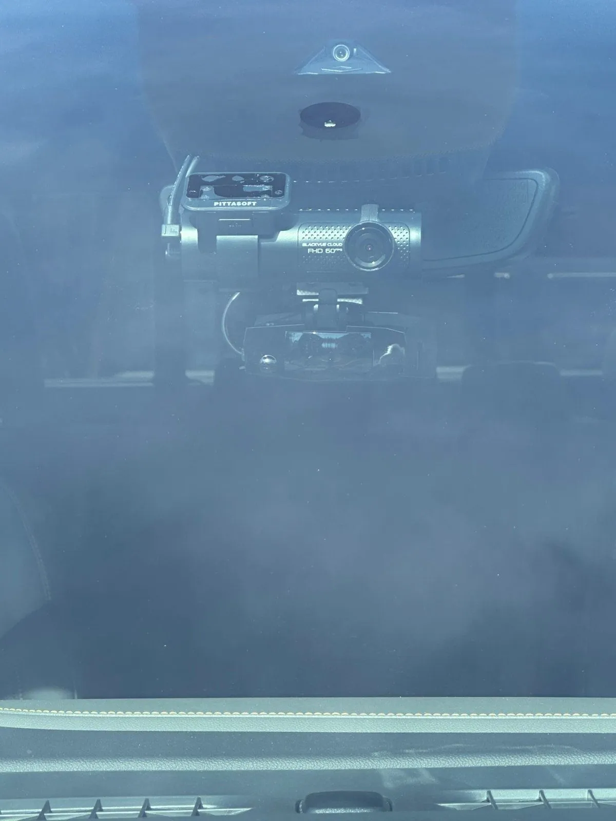

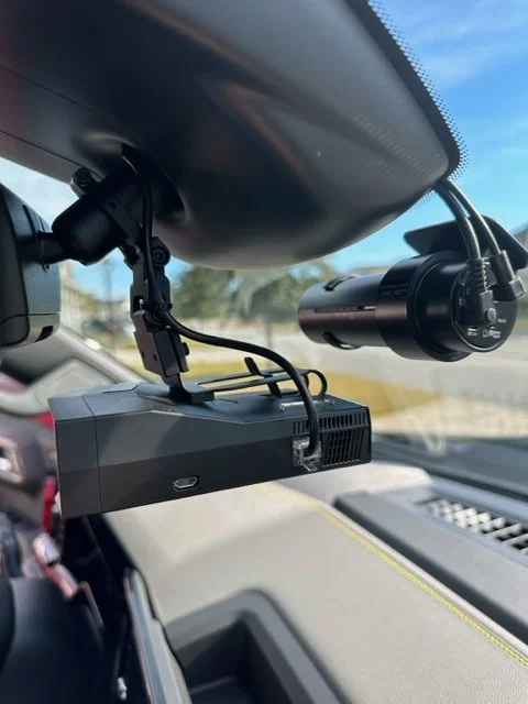

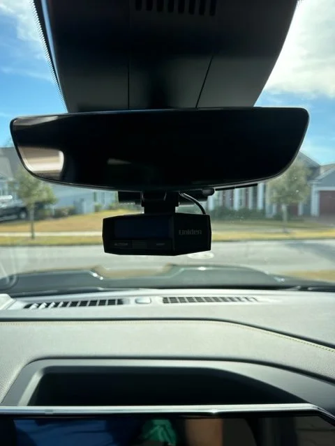

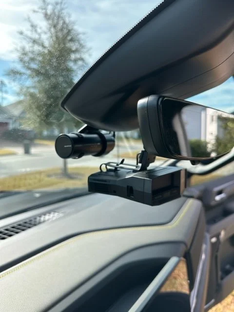

Just completed the installation of my Blackvue DR750X Plus 2CH dash camera and my Uniden R8 radar detector on a Blendmount. As OEM as I can get it. Cut a notch in the bottom left of the mirror shroud and routed all wiring through the shroud and into the headliner. Came down the passenger A-pillar to the fuse panel. Rear camera was routed across the headliner with the cable secured BEHIND all airbags. All I am waiting on now are my fuse taps to tie them in for power. Very happy with how it turned out. Happy to help anyone that has interest in doing this as well. I have been installing electronics into vehicles since I was 14 years old. Happy New Year everyone!
